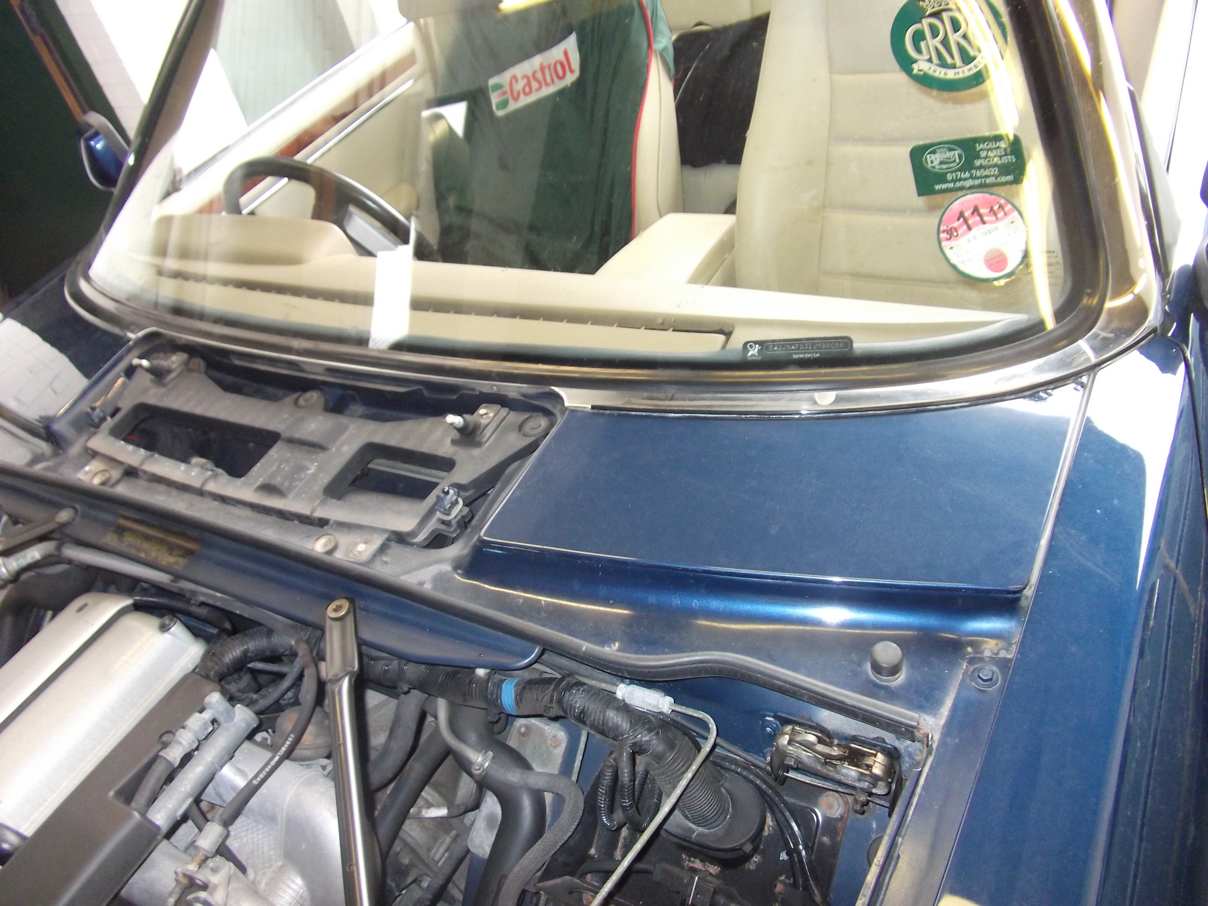

It's not unusual to get a little bit of delamination on the screens and if minor would not really affect the price. However, if it's bad enough to justify a new screen, I would make the following suggestions:
- Make absolutely sure that the fitter has done a bonded late XJS screen before. You really need someone who has done these screens before, can do the sealant and bonding and MOST importantly knows exactly how to remove and refit the delicate trim. Or else, do ALL the strip and refit yourself and just a good fitter to cut out and refit a screen. It really pays to find a good fitter on a late bonded-screen XJS.
- Without wishing to worry you, do be aware that if you strip the screen, you might well find the dreaded flange rot and now you're in for a big job! So, do you have any, even tiny, amounts of bubbling just by the scuttle chrome? If so, you will definitely have an issue. Even if there's no bubbling, you might still have an issue underneath. See the pics of my car which had the tiniest bubble before remedial action.
Good luck with whatever you decide.
