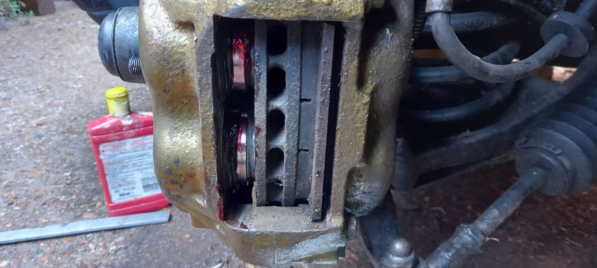

I've Skimmed the Sides of the Brake Pads, so they slide nice and easy The Discs look Good, The Pistons look Good and though I can freely Spin the Wheels, they both lock up after only a very Short drive round 'Orange Blossom Towers'
Hopefully Tomorrow I can have another look to see whats wrong but here's a quick Pic of the Pistons!

The end of the Pistons that push on the back of the Brake Pads are all looking rusty and don't all exit or retract at the same time, so seeing that new Calipers are one of the very few things that seem to have gone down in price during this Cost of Living Crisis
New Calipers would seem the way to go
