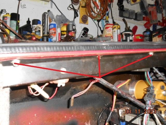

On my 88 XJS there are studs on the underside of the rear fender. See attached photo
studs shown here. I removed the nut and spring washer to show you.

Old Mar 11, 2023 | 10:06 PM
baxtor's Avatar
Joined: Jun 2013
Posts: 2,132
Likes: 1,389
From: Australia
Early were screws and nuts and later were studs and nuts, not sure when change occured.
