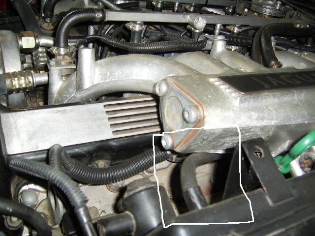

I am also thinking that the AAV is having a serious female nmoment.
Here is a snap of my over run delete.
AAV is tested in a pot on the stove correct? Do I need to drain her first or can I just plug the AAVs coolant hole?
Oh I've seen your Overrun delete! And your other deletes! Your motor is largely the look I'm wanting. I may get a Sanden rather than delete the AC and I'd prefer to relocate the cruise bellows if I can find it a new home. But that opened up vee is the goal.

Old Jul 28, 2016 | 08:02 AM
Posts: 28,839
Likes: 11,291
AAV is held to the head by 2 Torx setscrews, NO coolant hoses associated. The bulb out the bottom of the AAV sits in coolant inside the head. Some loss will occur, and easily topped offf when replaced.
The 90deg hose on top will split, so order a new one FIRST.
The cruise bellows will fit in the opening in front of the RHF wheel. Wedged in there with the spare vac tank. Lots of alcohol to get the angle of the dangle just right. A half decent sense of adventure is also a good thing. A cable extension will be needed. I got one from Harley Heaven here, worked a treat until I upgraded the cruise.
Attachment 133610
Old post from the dead.
Did u delete your fuel cooler as well since it is connected to the overrun?
Also the fuel lines go into the 2 circled items in the picture. How did u do the work around?
