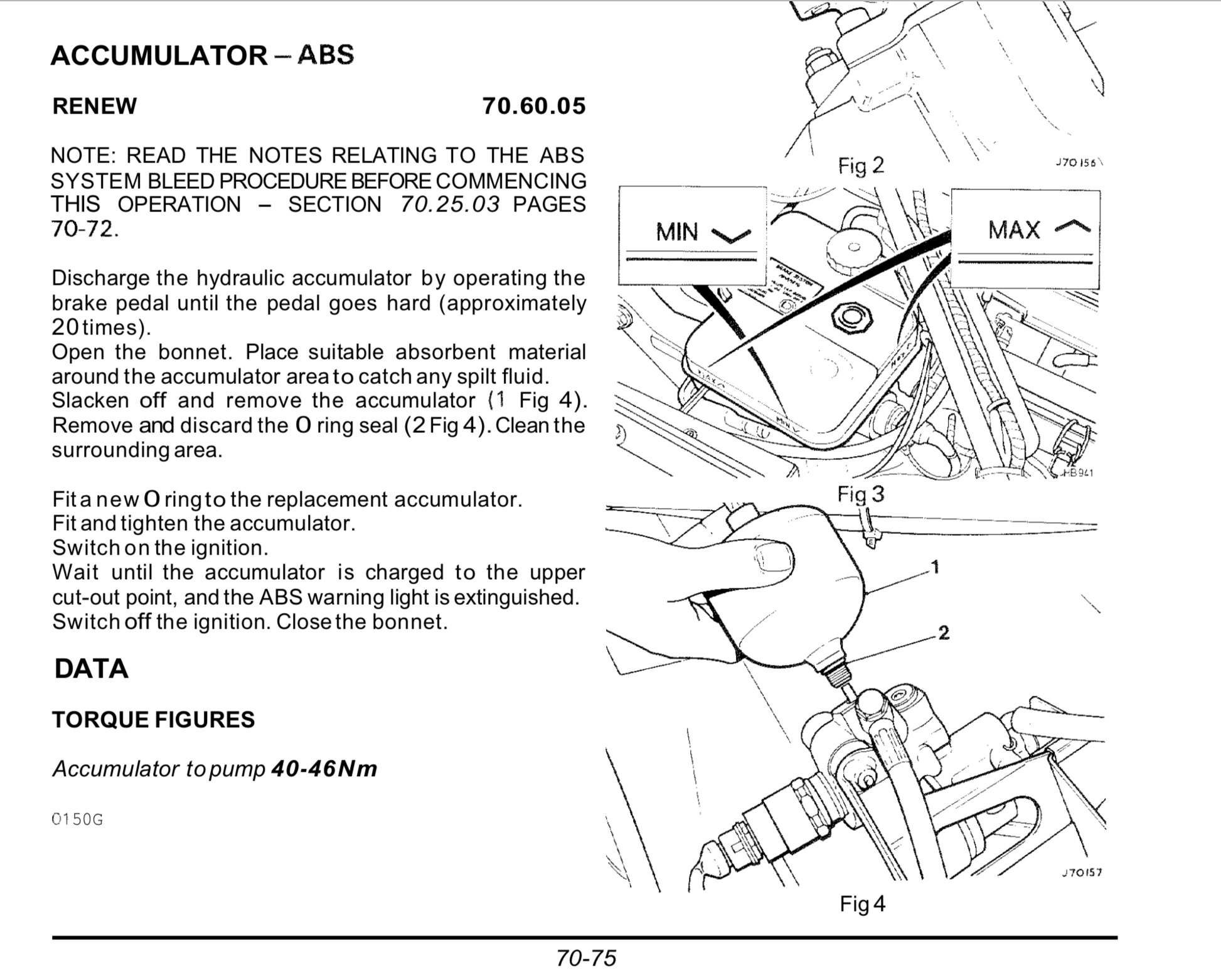

Though I think it is prudent and wise to warn people of the potential danger, I wouldn't go so far as to say you can't do the job yourself. Do NOT attempt to it if you don't already know the exact procedure, but knowing the proper procedure makes it a rather benign task. It's akin to taking off a radiator cap, it can be crazy dangerous if you take off in the wrong circumstances.
I've attached the ROM procedure for reference. The most important steps are to turn the car off and take the key out of the ignition (or to be safest, disconnect the battery), and to depressurize the accumulator. The ROM says to operate the pedal 20 times, so just do it 30 times to make sure. Once properly depressurized, it's a very simple and straight forward.
