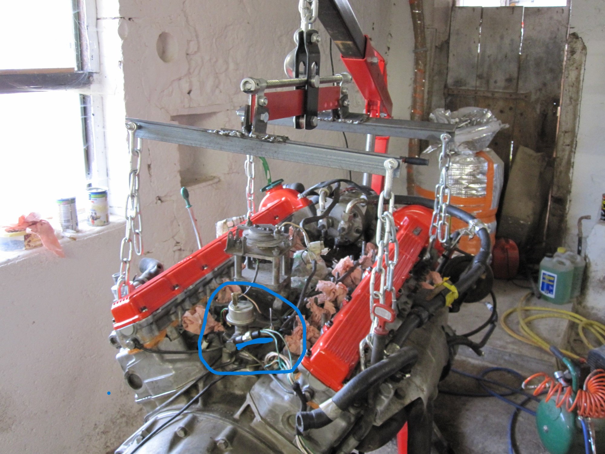

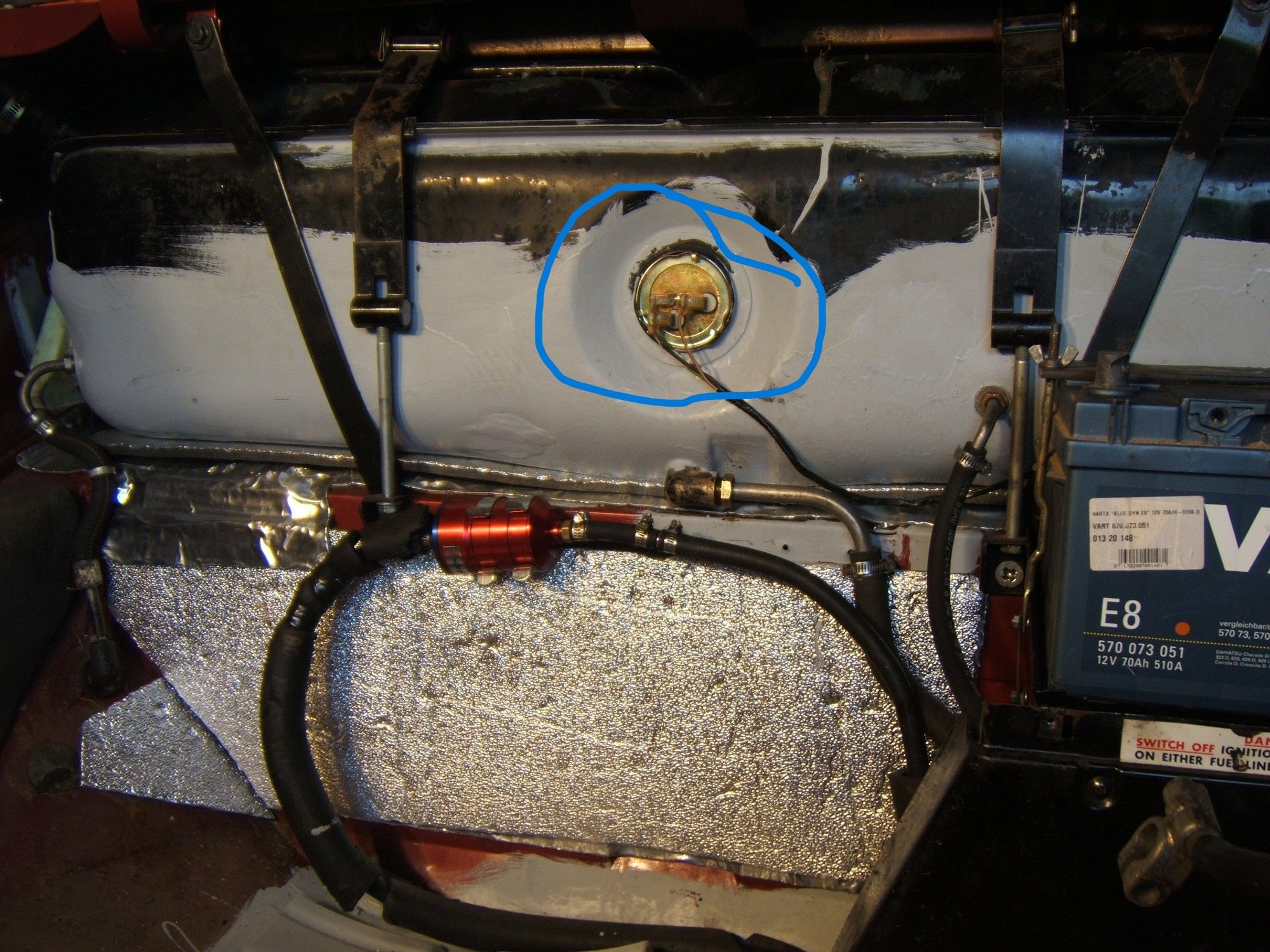

Sorry, you are right. I was confused. The brake light is ok, but the oil light is on, all the time, while te oil pressure gage indicates normal pressure levels. Moreover, the fuel level gage has a problem: it never went higher than 3/4 and now it does not come up at all, most of the time. I monitor my fuel with the milage.

The oil warning light sender is most likely not working, ot the wire has come off and is grounding. It is sited at the rear of the V on a cast aluminium pedestal, along with the guage sender next to it. The smaller of the two is the warning light sender.
It is hard to get at and removing the throttle capstan and its pedestal makes the job far easier. You MUST support the pedestal against the undoing torque of your spanner (with a pair of grips or something similar) when you change the sender, or you will break off the casting and that is a disaster.
The fuel guage sender is easily got at, it is halfway up the fuel tank behind the spare wheel. Ensure you have no more than 1/4 tank of fuel and it can be easily changed for a new one and the circuits tested.
