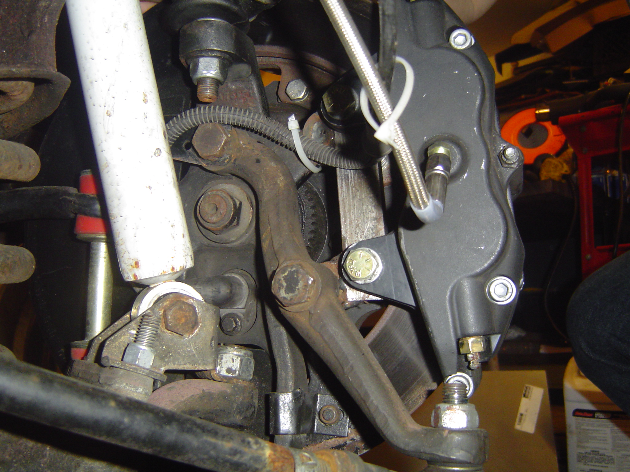

Willwood 4 pot, with aluminum hot rotors. Rotors are 1.25 inches thick and 12.25 round. Thats about 1 inch bigger than the Jag rotors and .25" thicker. This makes a world of difference in brake performance yet they weigh slightly less the EO Jag rotor. The calipers are about 15 lbs lighter each. I use this setup on my hi-power 1976 XJC. I also have vented rear rotors, outboard from a 1994 XJS. My car stops awesome and brake feel is great too. Rotors and calipers are off the shelf. Hats and caliper mounts are custom. This was way cheaper than DB7 sport calipers and rotors if you can find them. If you're interested I could help you make up a set for your car in this size or bigger. Once you go bigger than 12.25 inches on the rotor the price basically doubles. Wilwood does have the rotors I used in drilled and slotted and just slotted. Next time I change them I'm going to try the slotted.
Attached Thumbnails brake rotor advice-dsc02593.jpg   brake rotor advice-dsc02594.jpg   brake rotor advice-dsc02595.jpg
I'm going to need to get the specs for the back, as I am going to switch to outboard brakes with vented rotors as well as custom brackets and 14in z06 rotor for the front, because I can get a good deal on thoes.

iscamerica -> Which wilwood calipers did you end up using for the front? do you have any drawings for the adapters?
Thanks!
Old Jul 10, 2013 | 10:41 PM
calvindoesntknow's Avatar
Posts: 882
Likes: 65
From: new york
I need thoes too!

Wilwood caliper 120-11136 which is a forged super lite internal that supports a 1.25 inch rotor with a 1.75 inch piston area. The Jag pistons are 1.69. That's very close and when you factor in the additional leverage, feel and initial bite are identical to stock despite the slightly larger piston area. When I stand on the brakes they really bite hard. This works out well because modern tires have more grip. There are other calipers in that line that can use a 1.1 inch rotor or .81 inch rotor which are closer to the OEM jag size so one could choose the thinner rotor and have a large reduction in weight.
My first install used a bracket which was not ideal. The bracket flexed enough to diminish brake feel greatly. Over all stopping power was much better but I wanted the stock feel too. In order to get rid of the flex I cut off the stock caliper ears from the spindles and welded on new ones in the right location. That fixed the feel issue.
