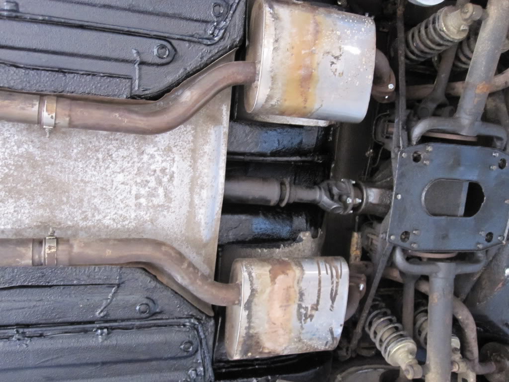

Originally Posted by Eaa
There is a sort of plate under the center of the car, on mine at least, it looks like a heat shield to me. Mine was pretty well coated with oily grime, I don't know that it would have an ignition source or actually burn under normal conditions though. I'd say that either there's a problem causing way too much heat or the smoke is coming from somewhere other than the plate I'm talking about.
Is this the plate you are thinking of (pic RHS) as it is the one the OP was meaning, I believe:
If so it is a tie plate that strengthens the rear axle cage. Above it are the inboard disc brakes that are being suggested as a cause of the smoke. If the inboard brakes become jammed on, or as BB has indicated the handbrake is on, the heat generated produces smoke because all the years of accumulated grease and leaking diff oil that are coating everything including the tie plate, start smoking. The friction heat generated by the jammed brakes is the heat source; or combustion source if you go on long enough...
If on the other hand you mean the silvery heatshield between the exhayst pipes (pic LHS) then is is indeed a heatshield, but I do not think the OP means that one, as his smoke was coming from the rear axle.
Greg

Yes, I think I did mean the heat shield on the left of your photo, I may have misinterpreted where the OP's smoke was coming from. I never got quite that good of a view of the underside of my car as I've always had it only on ramps, so low to the ground, dark and awkward. Also not nearly as clean and un-oily as yours! But I'm working on it!
