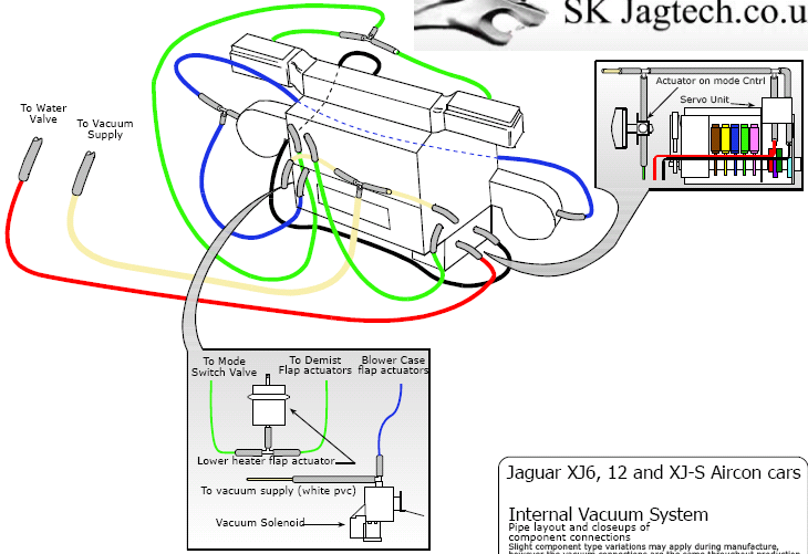

WHEN I TOOK THE RADIO out there were 3 vac pipe, blue red and white in site, the white has a T on it, the T was disconnected on the downward bit but question is, where does the downward bit go,
nothing was wrong with the a/c,.
