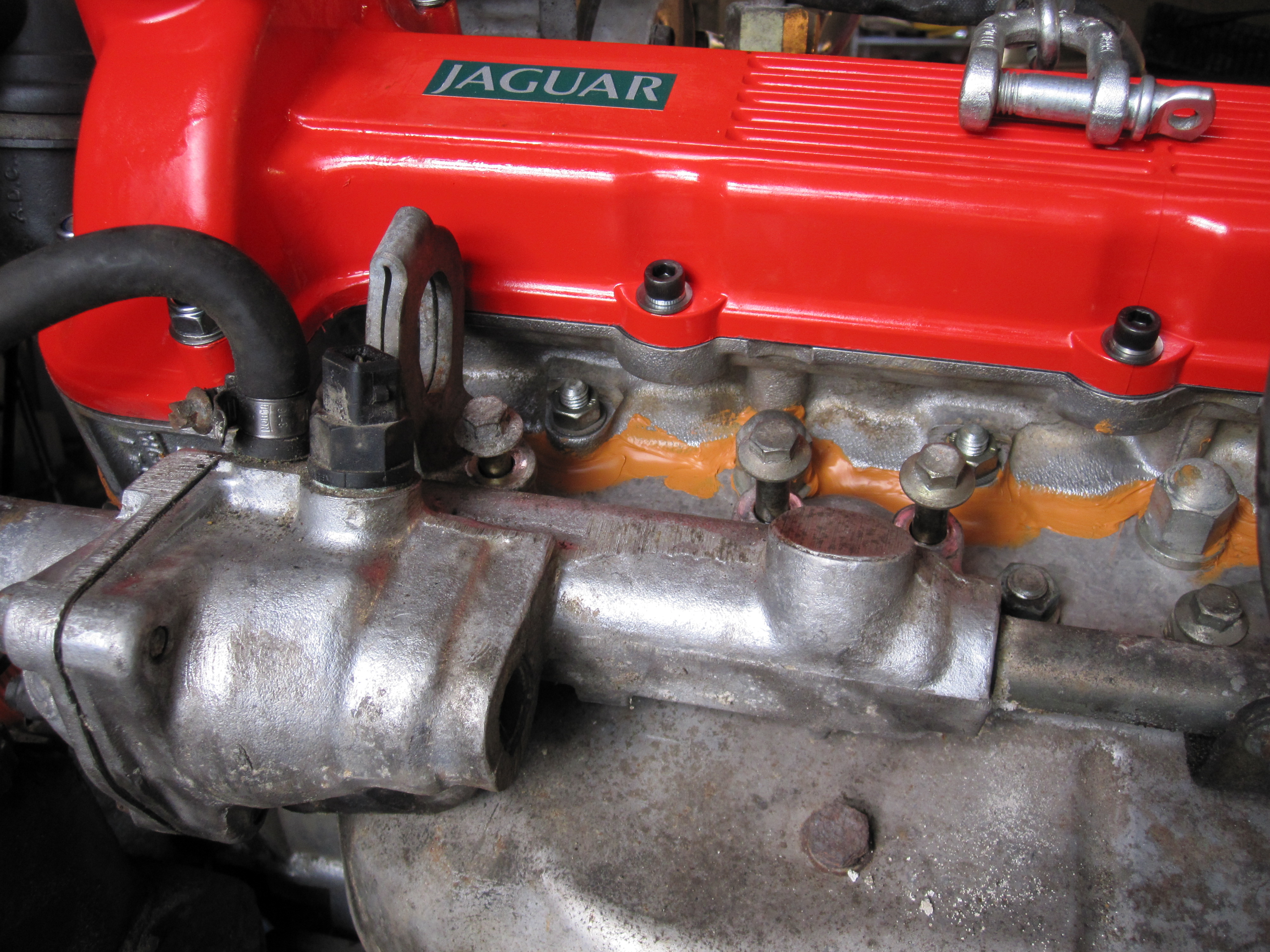

Originally Posted by brinny
Did you do anything regarding preparation Greg?
Yes I applied paint stripper to the cover and got it down to bare metal. Then several coats of VHT aerosol red. It dries sort of dusty to the touch but goes off completely once on the car and it gets cooked. Always your Mum's oven at 150C...
