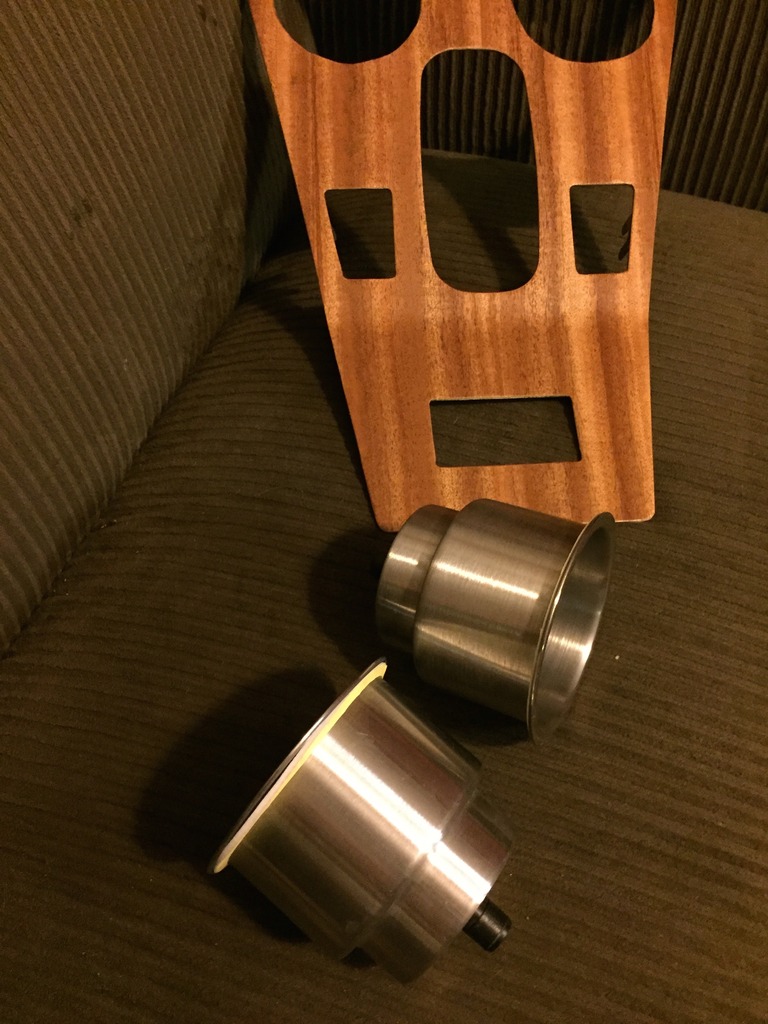

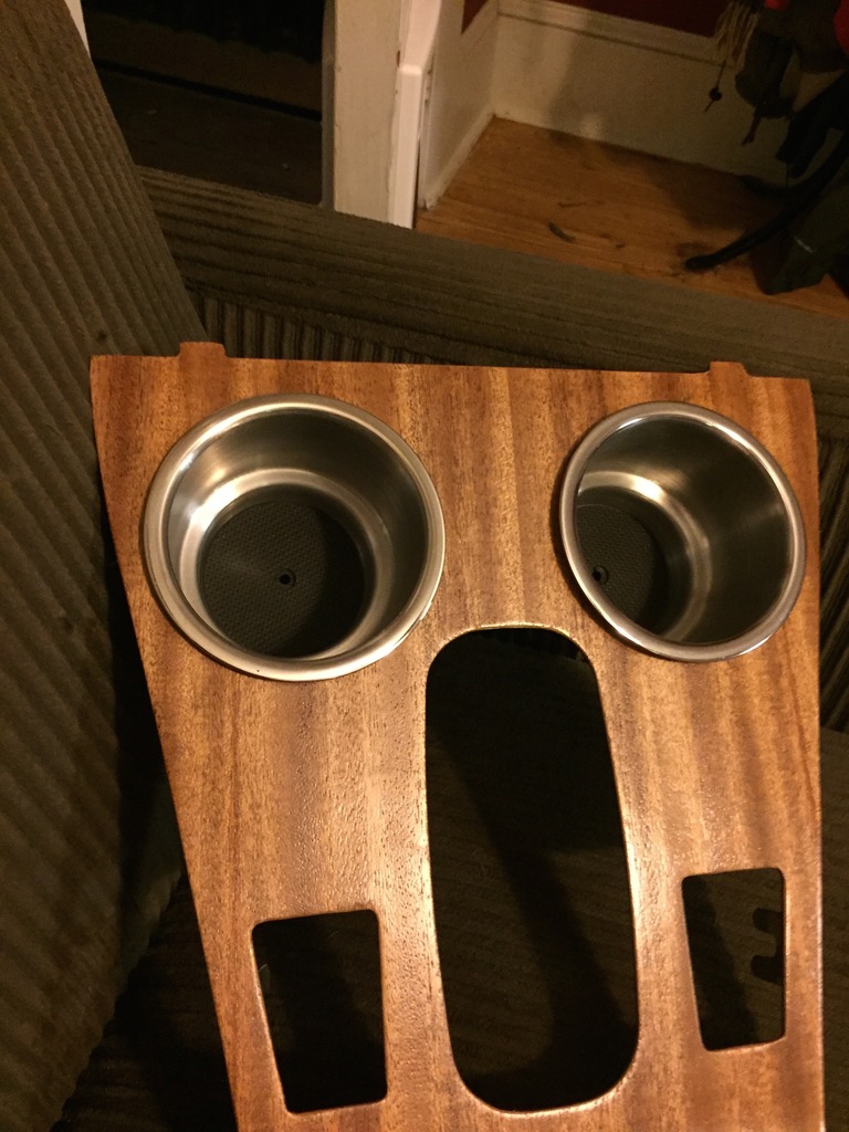

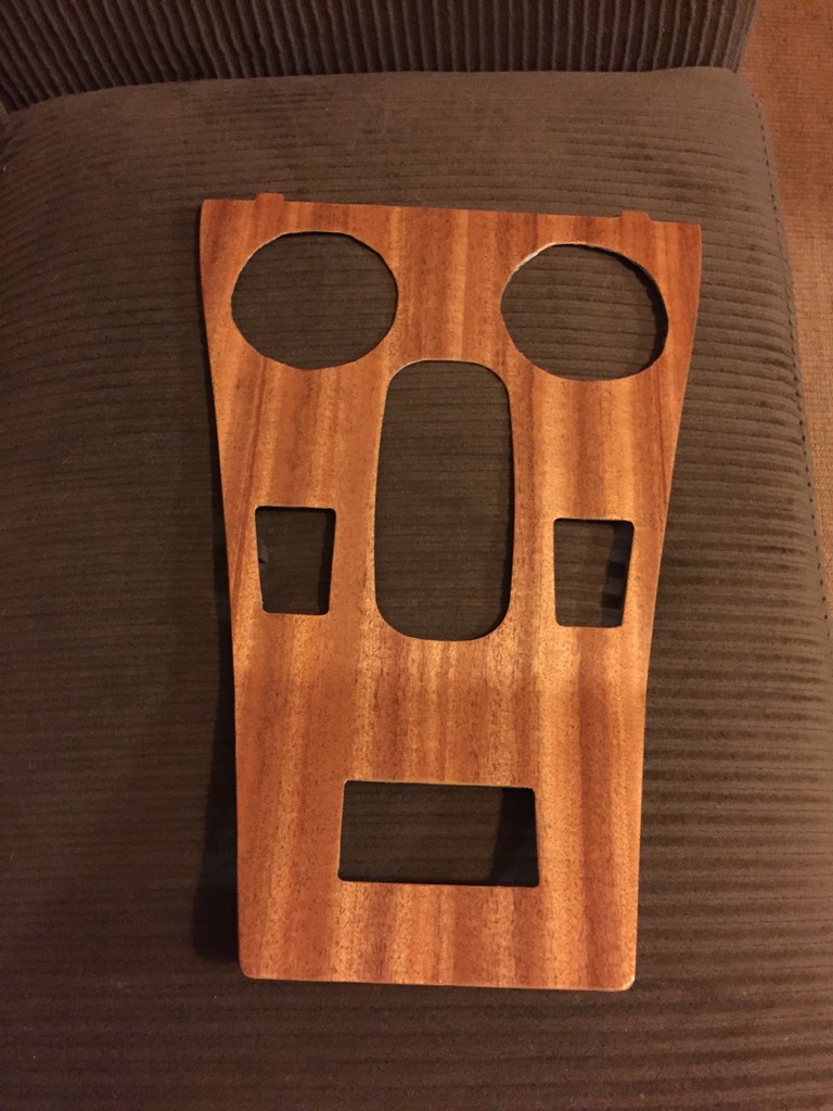

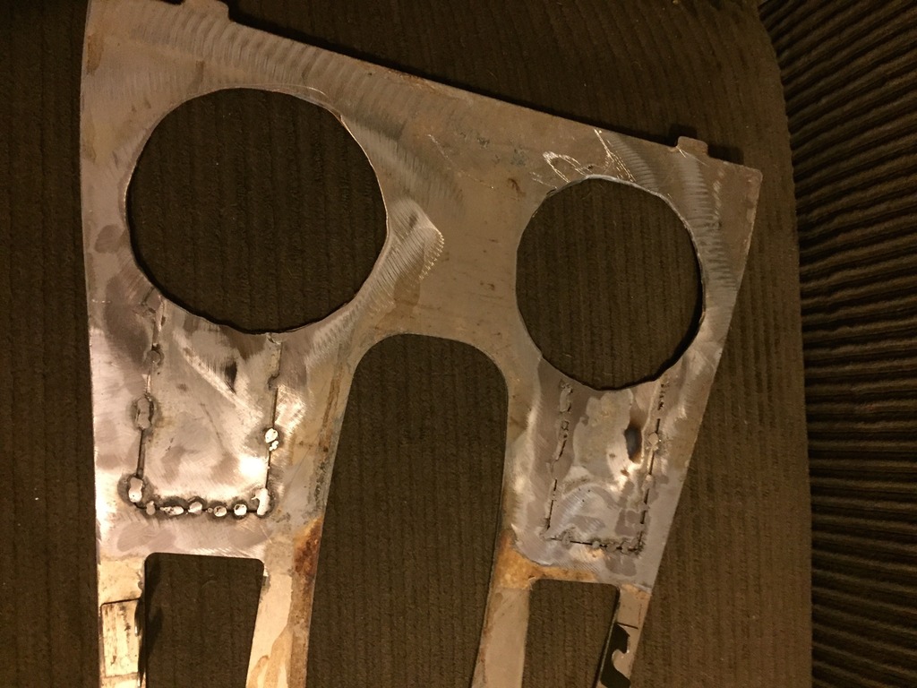

In between other jobs on XJS shooting brake project I completed a mod to the stock ski slope to add cupholders.
I welded in a piece of steel where cut outs for ash tray's were, then traced hole and cut with a grinder. Cup holders were off eBay, they are ubiquitous as they are used by RV'ers.
Wood is PSA (pressure sensitive adhesive) mahogany veneer. Thats going on all interior wood trim.
Finish is satin spray polyurethane and I deliberately left pores in wood exposed. I might try an even flatter clear if I can find one that is easy to apply. I love the flat wood look on new cars.
