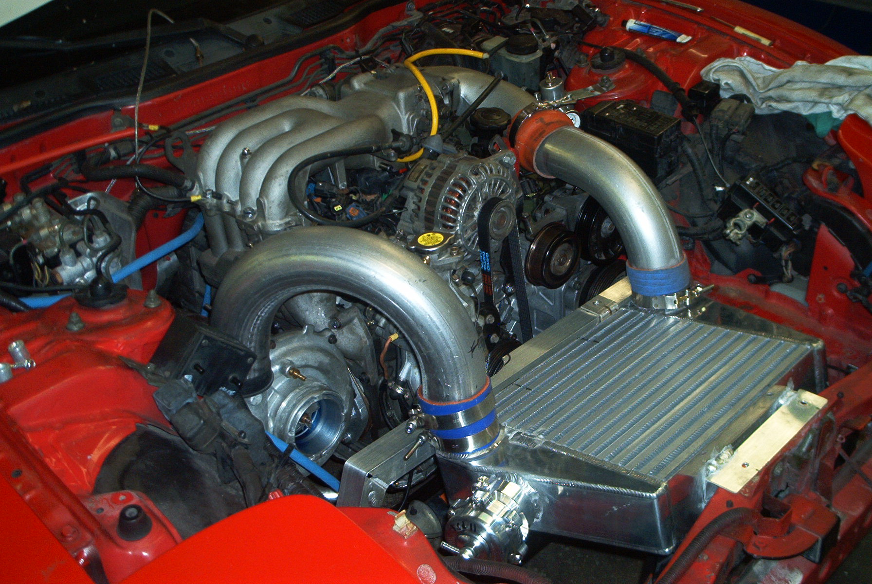

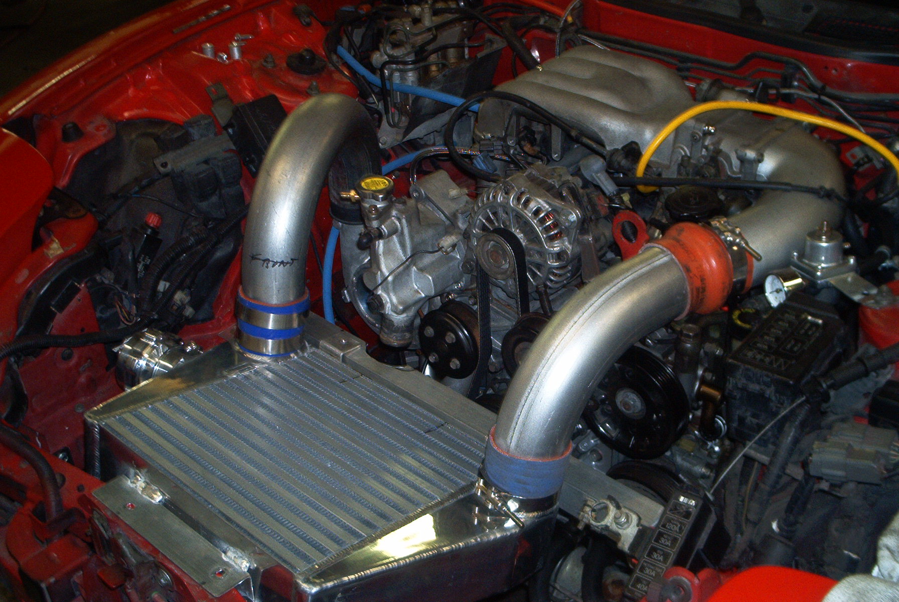

you may be a little optimistic on your info!
a 13B two rotor bare engine ***., weighs in at 185lbs, with oil pan and front pully ,(i have weighed them), NO flywheel or balance weight!
a complete 13B with starter ,alternator, 2 manifolds, big turbo, and proper balance weight, flyw.clutch ***, intercooler ,piping , water pump, around 290lbs.
so quick numbers it is lighter than a Jag V12 by about 500lbs, thats a lot.
so power? my car dynod 420HP RWHP, 375 torque, 7500rpm. on 93 oct. street gas/petrol.
my 1987 RX7 weighed in at 2700bs, 1/2 tank fuel,no driver!
it ran 1/4 mile best 10.90s, 127mph, slicks. average 11.20s.
BUT? turbo rotaries are very fragile, break APEX seals ,blow coolant, overheat,ETC. with NO warning! contrary to what people think,THEY ARE NOT CHEAP TO FIX.
non turbo cant get out of its own way, 13B 120hp., altho you cant break them easily, tough litle suckers, and torqueLESS.
putting one in a tank like an XJS, 4100lbs,MINUS 500lbs, is a heavy 3600lbs of lead sled. fuel consumption would be BAD. rotories love fuel.
