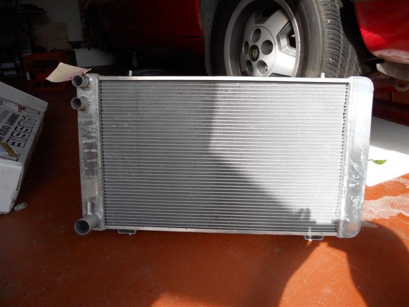

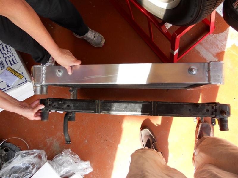

2 pass radiators are far more efficient than single, hence why dedicated race cars use 2 pass - F1, Indy, NASCAR and the list goes on. I have a new Alloy full 2 pass ready to go in. Had it custom made but it is so big I need to modify the AC and oil cooler as they will not fit between the rad and the bumper mounts.
If I had my time come over I would stick with the stock radiator, especially after speaking with Bruce who owns the XJS TT race car I posted on another thread. He had overheating issues and went back to a standard rad and said the car will now lap Bathurst with no overheating. So think twice about an Alloy

Idiot I meant to post the pic
Attached Thumbnails Comparing the two 6.0 engines-dscn0160.jpg   Comparing the two 6.0 engines-dscn0161.jpg
