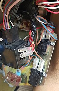

Greetings,
Mucking about under the right dash (just behind/under the glovebox in a LHD car). I'm working on getting the right blower out...another thread...and though that I would eliminate any non-essential parts in the process.
A). I'm fairly sure that the two items in brown are bulb failure units.
B). What about the large square device with the "grill", I assume it's either a cabin temperature sensor or something that is supposed to emit a noise.
C). The two black devices screwed to the mounting plate.
D) The round device, just to the left of the device with the "grill".
E). Finally, the relay on the back.
Thanks in advance,
John
1987 XJ-S V12

Originally Posted by J_C_R
Greetings,
Yes
Pretty sure it's the seat belt buzzer
Circuit breakers for windows and locks
Low coolant transmitter for the low coolant light
Not sure. Signal flasher? I'll have to look that one up
DD

Thanks Doug, sounds like most of them need to stay.
Cheers,
John
