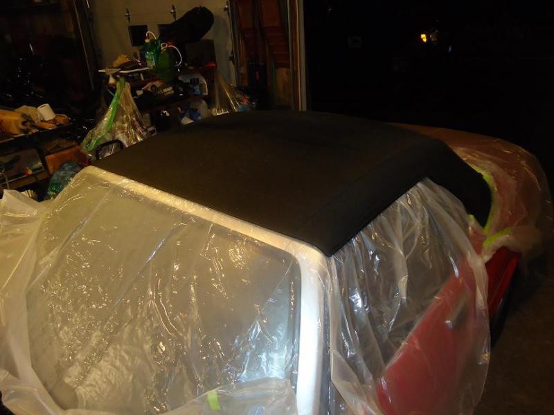

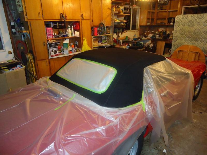

Well, after having the 303 Convertible Top cleaner and Conditioner Kit for a couple weeks, I 'bit the bullet', took advantage of a drizzly day and soaked the top, and sprayed on the cleaner, used a small soft sponge to work the cleaner into the top well, then double-rinsed it all off. I waited a couple days for all to dry well, then I half opened the top, draped a large plastic sheet inside the car from as far to the rear as possible, over the windshield, and over the side windows, and closed the top down to the windshield. This protected the painted areas and glass from the Conditioner/Water Repellant. I laid another piece of plastic around the rear deck/trunk, and covered the rear window, using masking tape to seal it all properly closely to the fabric top. The kit instructions said to apply until the fabric was uniformly well wetted, which I did. I closed the garage doors for 18 hours, peeled off the tape, removed all the plastic, and used WD-40 on the fingertip of a clean cloth to remove any little drips and runs that did find it's way onto the paint. The top looks great, the black is brighter. I haven't run water over it (or been in the rain), but I'm very glad I did it. I will be giving it another coat next year.
I took a few pix, from cleaning, to masking with plastic, to finished spraying.
Attached Thumbnails Convertible Top conditioner/protector?-top-cleaning-2-.jpg   Convertible Top conditioner/protector?-top-masked-off.jpg   Convertible Top conditioner/protector?-top-sprayed-303-1.jpg   Convertible Top conditioner/protector?-top-sprayed-303-2.jpg
