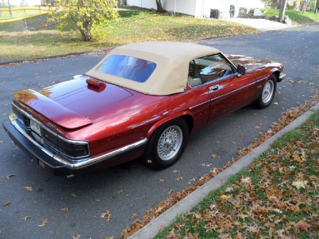

I recently replaced the roof on my XJ-S and found one with a plastic rear window already installed! Makes replacement much easier, looks great too! As long as you don't have a show car I'd recommend it! Came from 1a auto.com.
