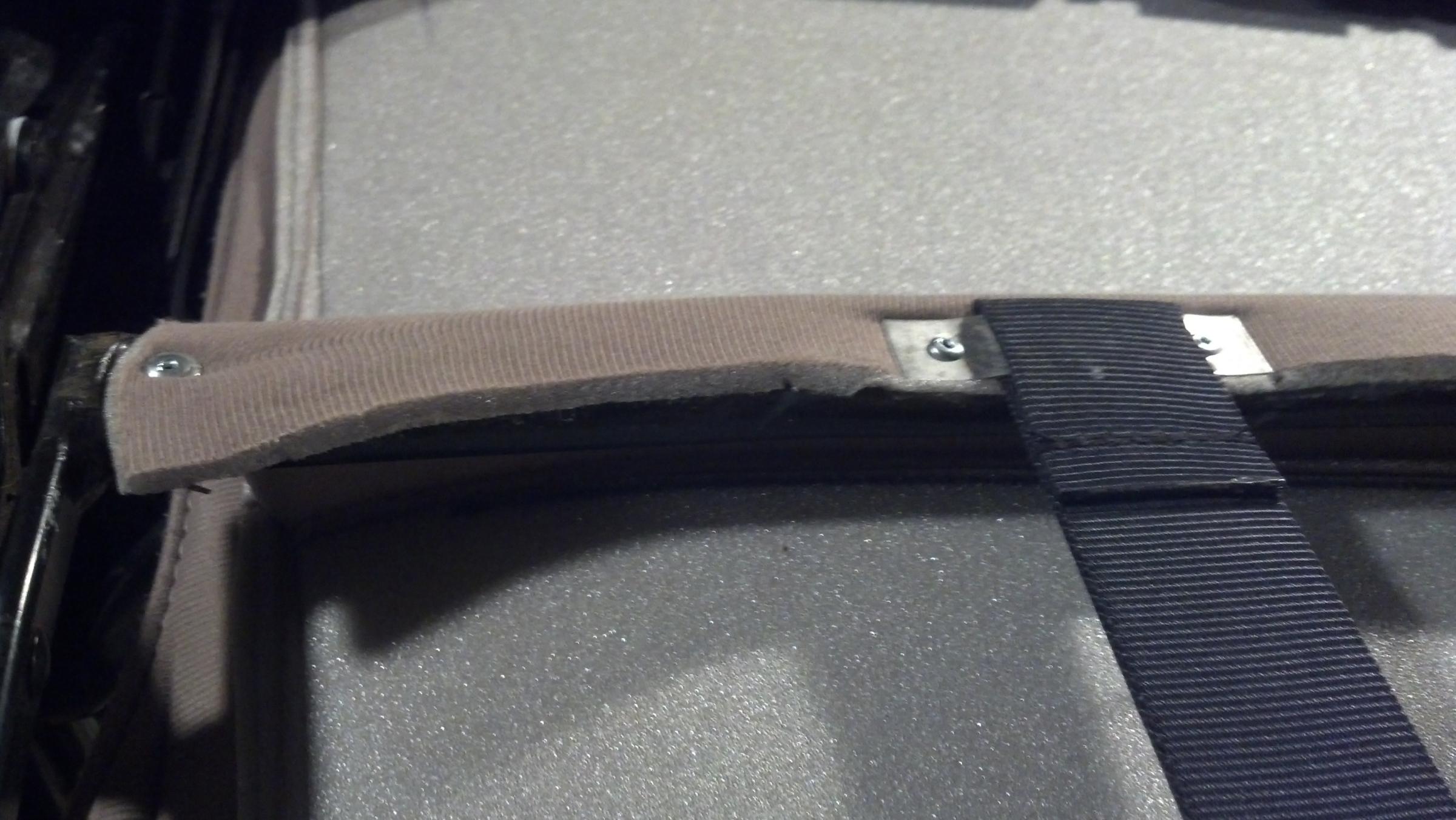

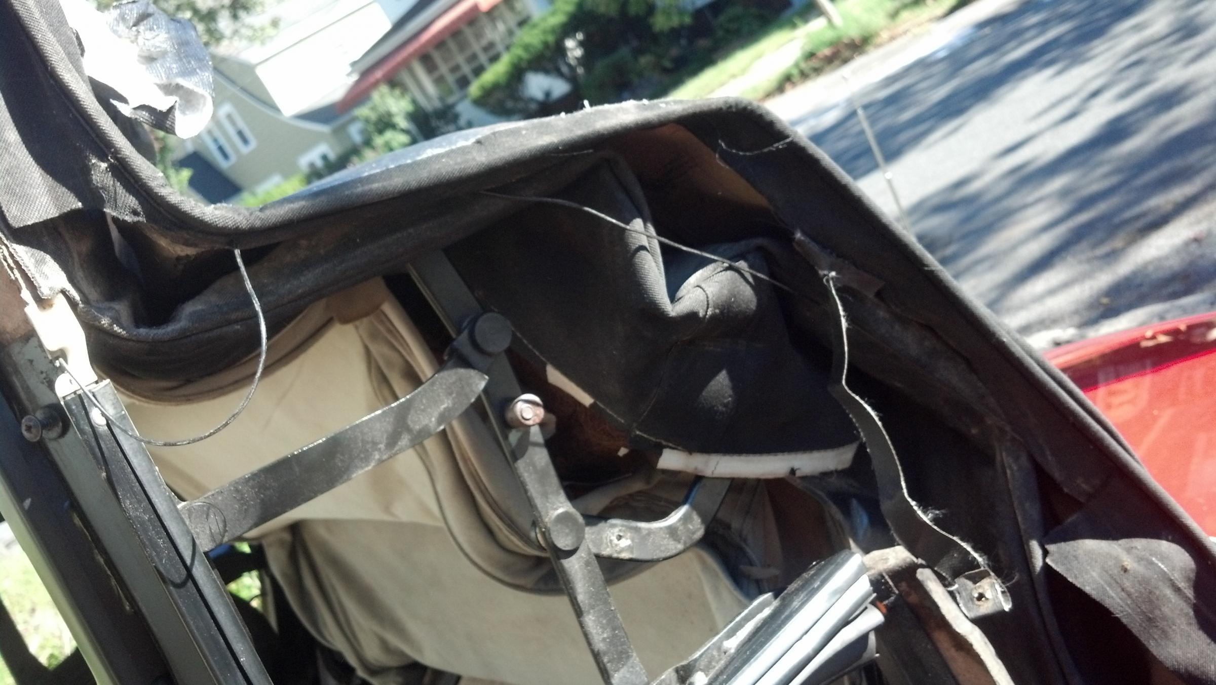

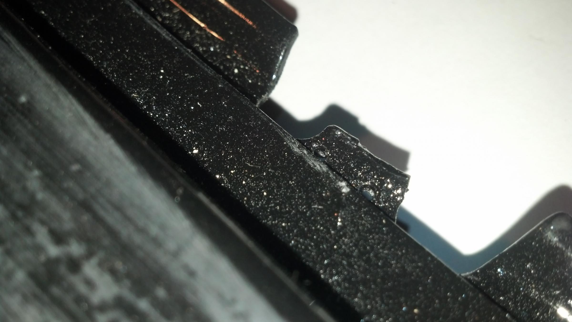

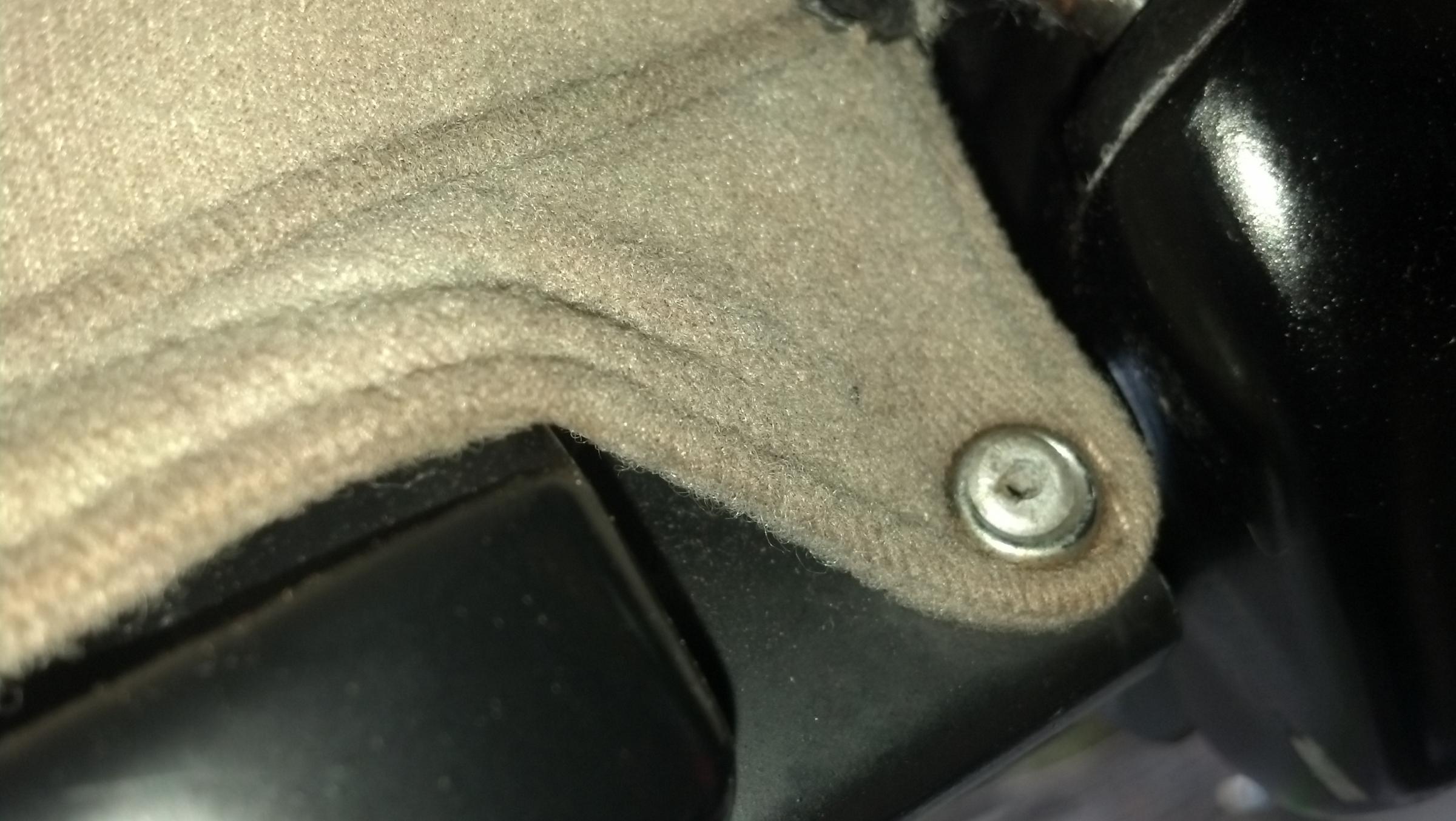

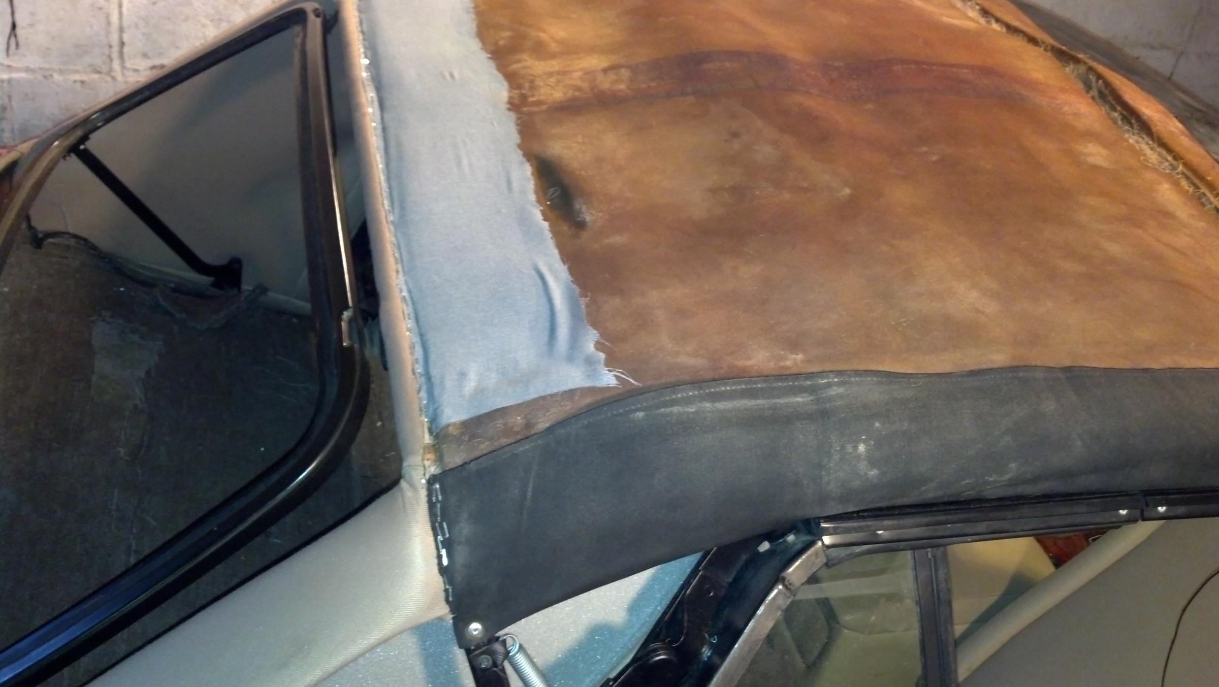

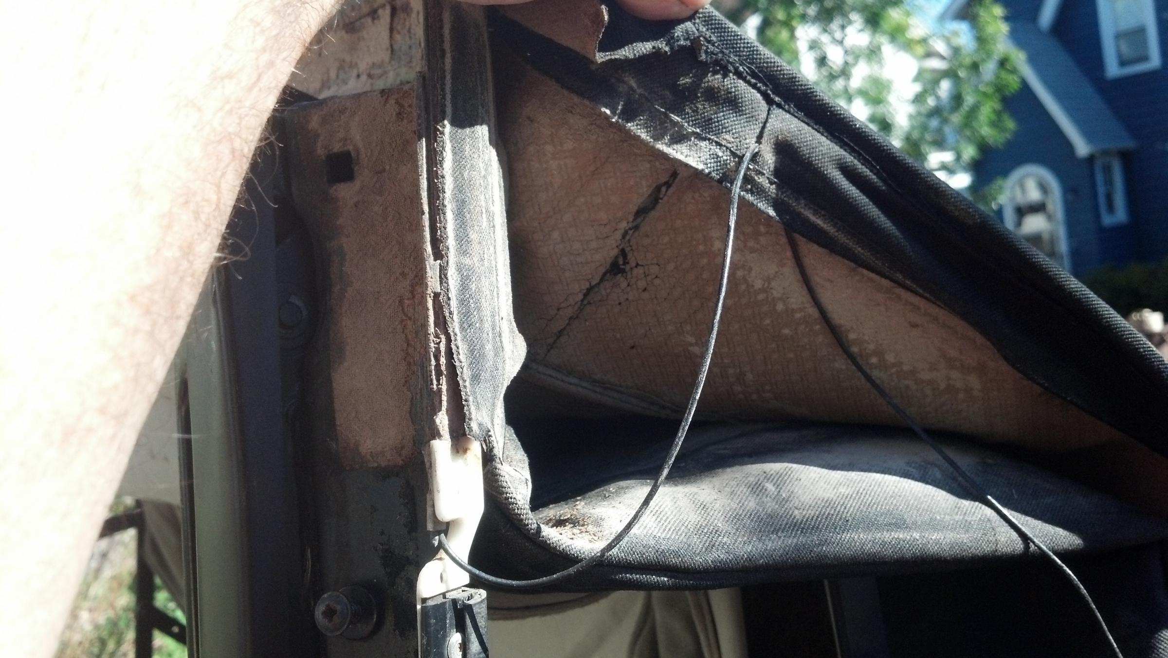

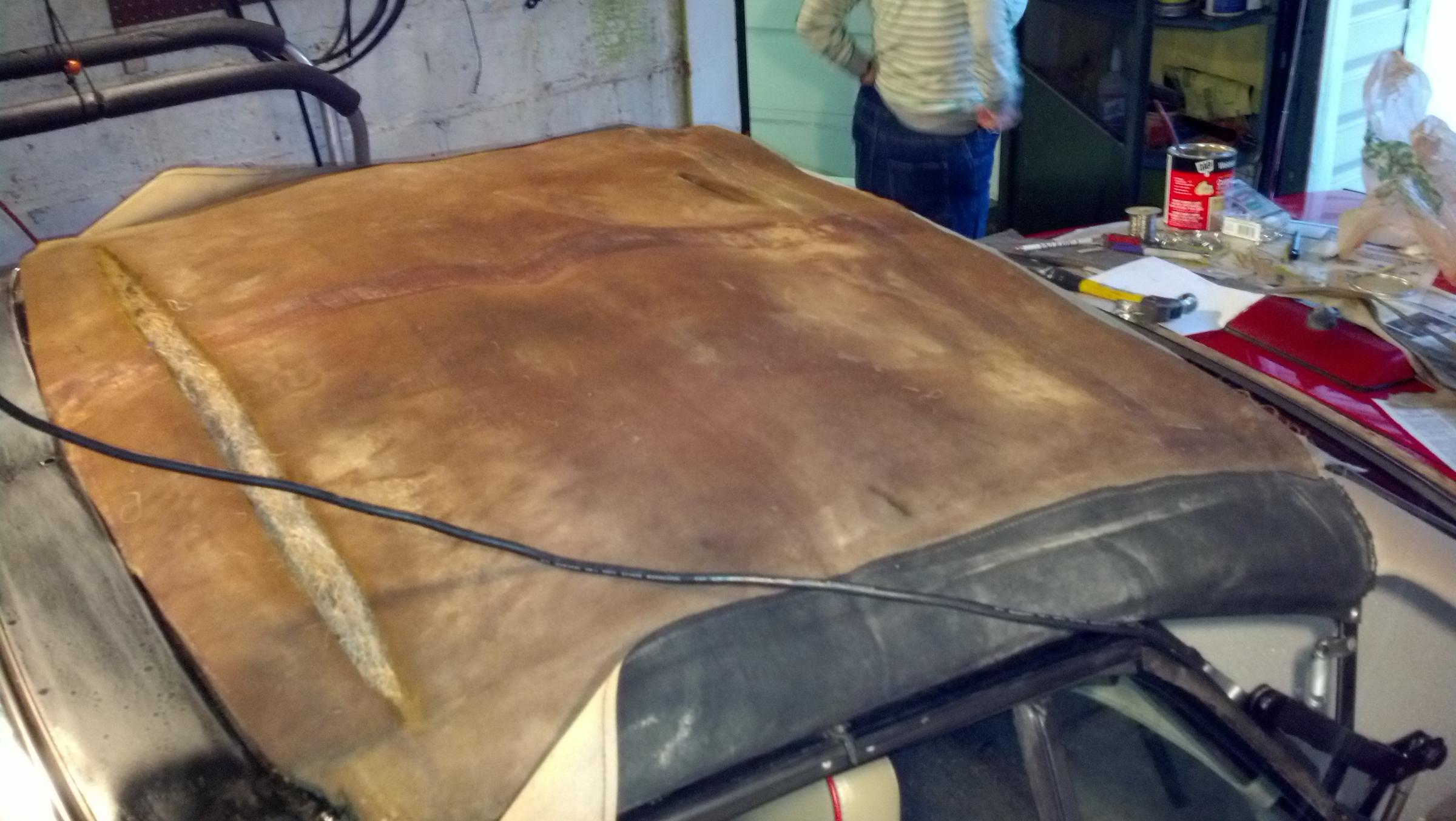

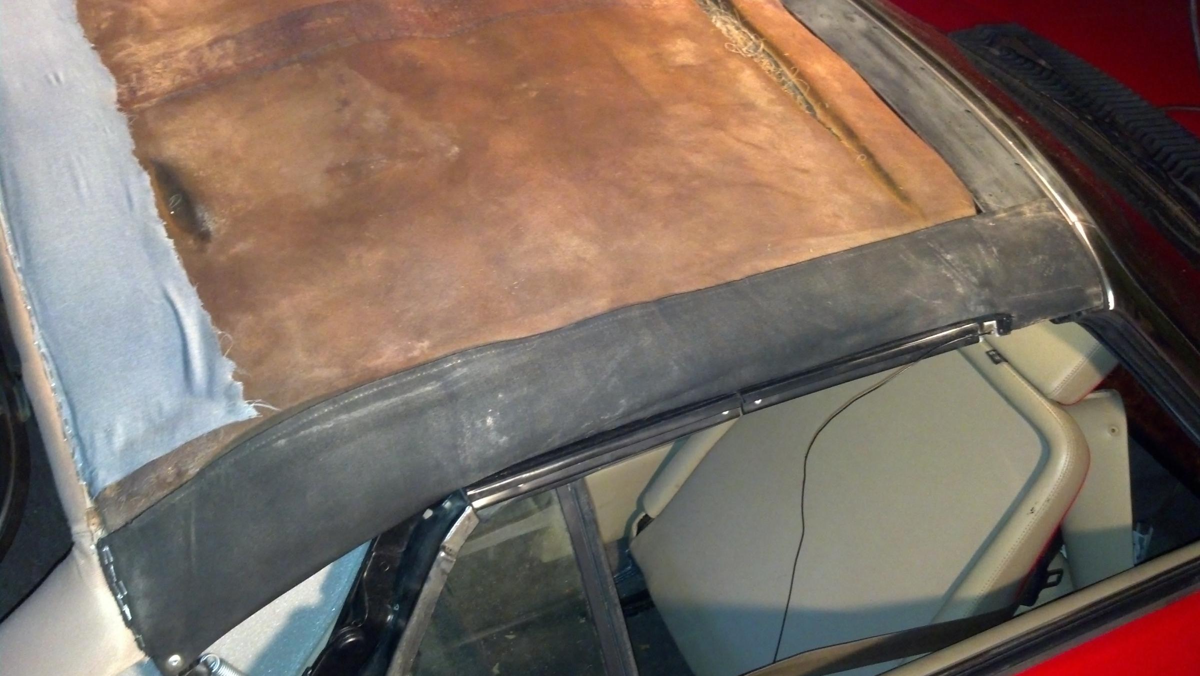

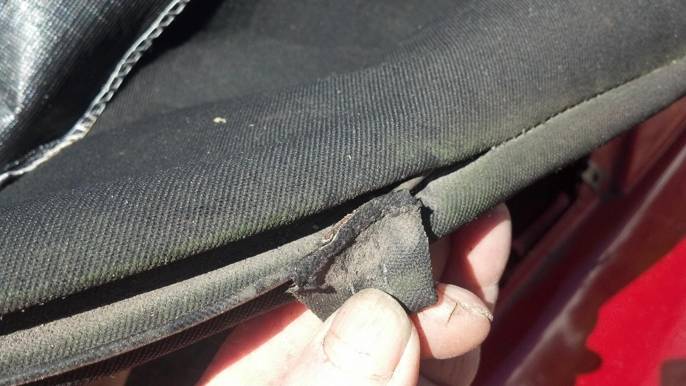

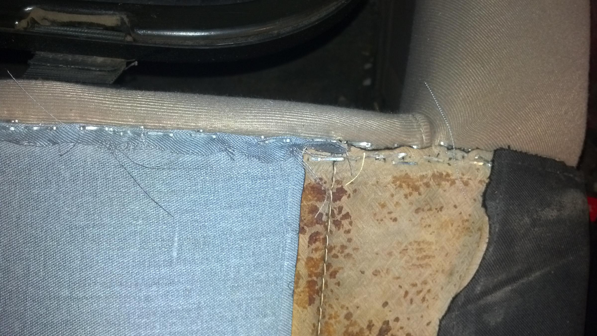

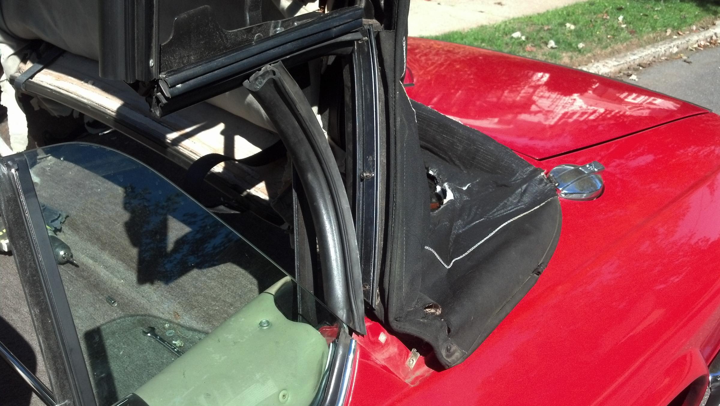

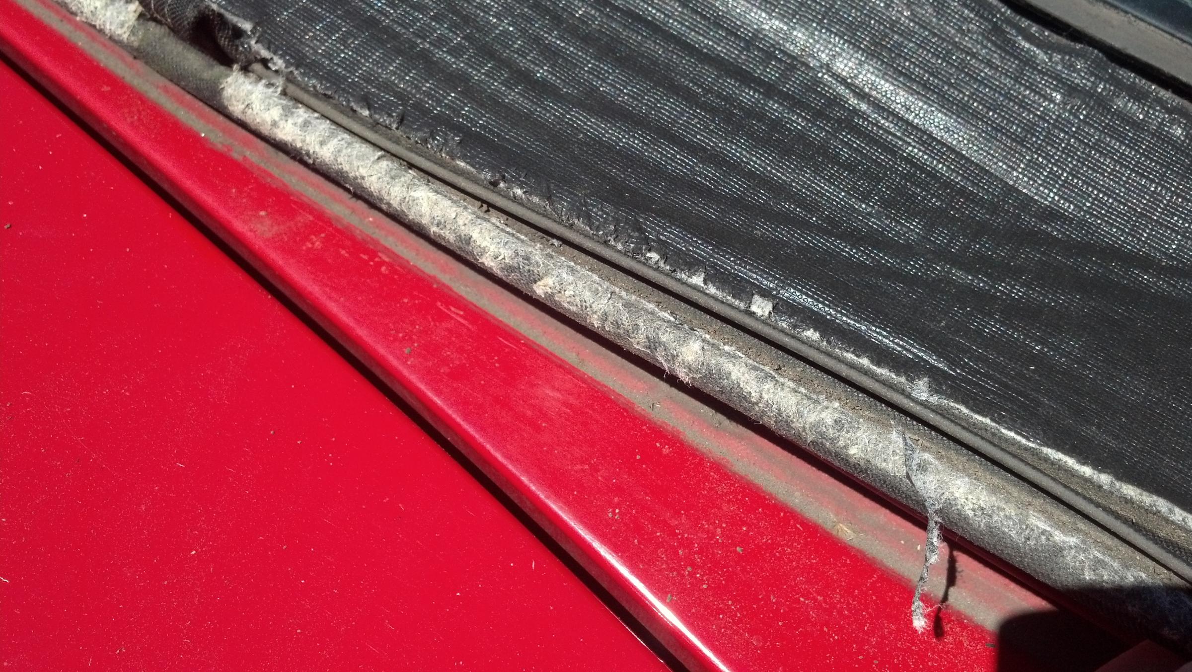

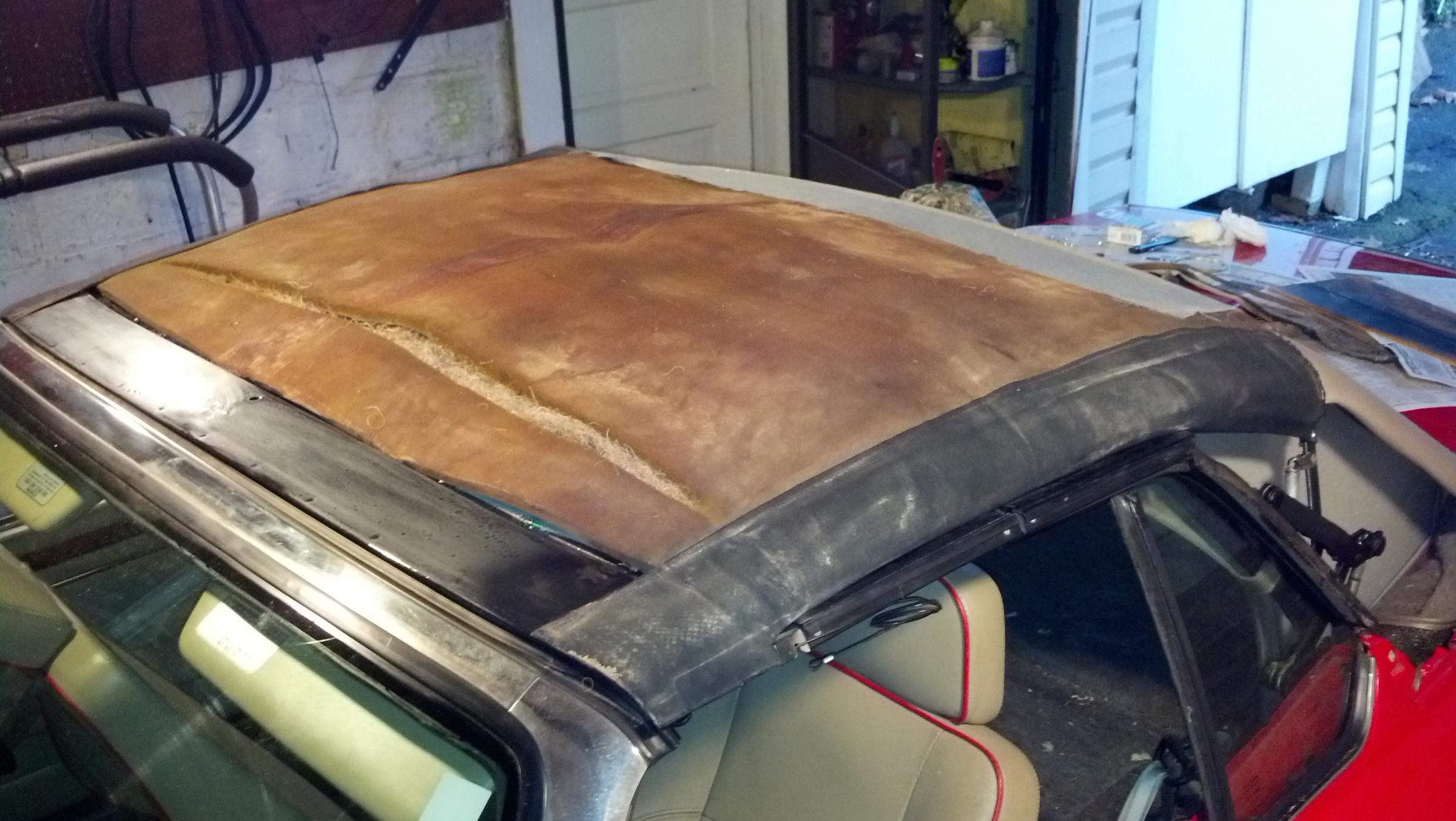

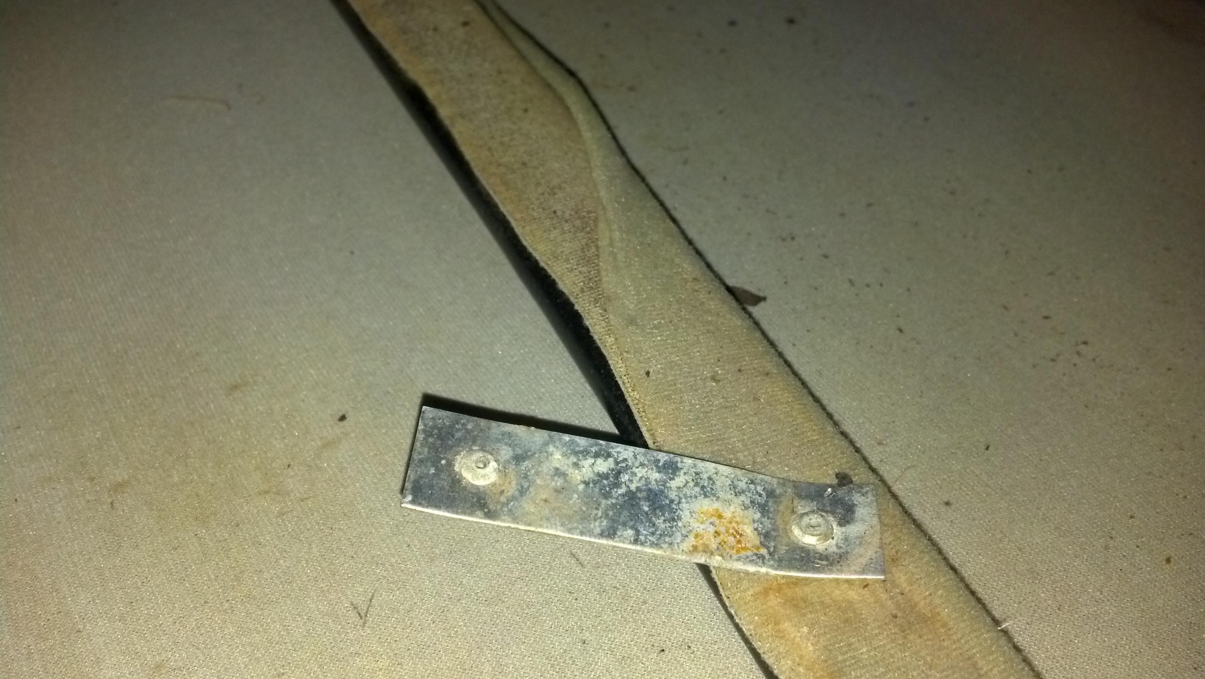

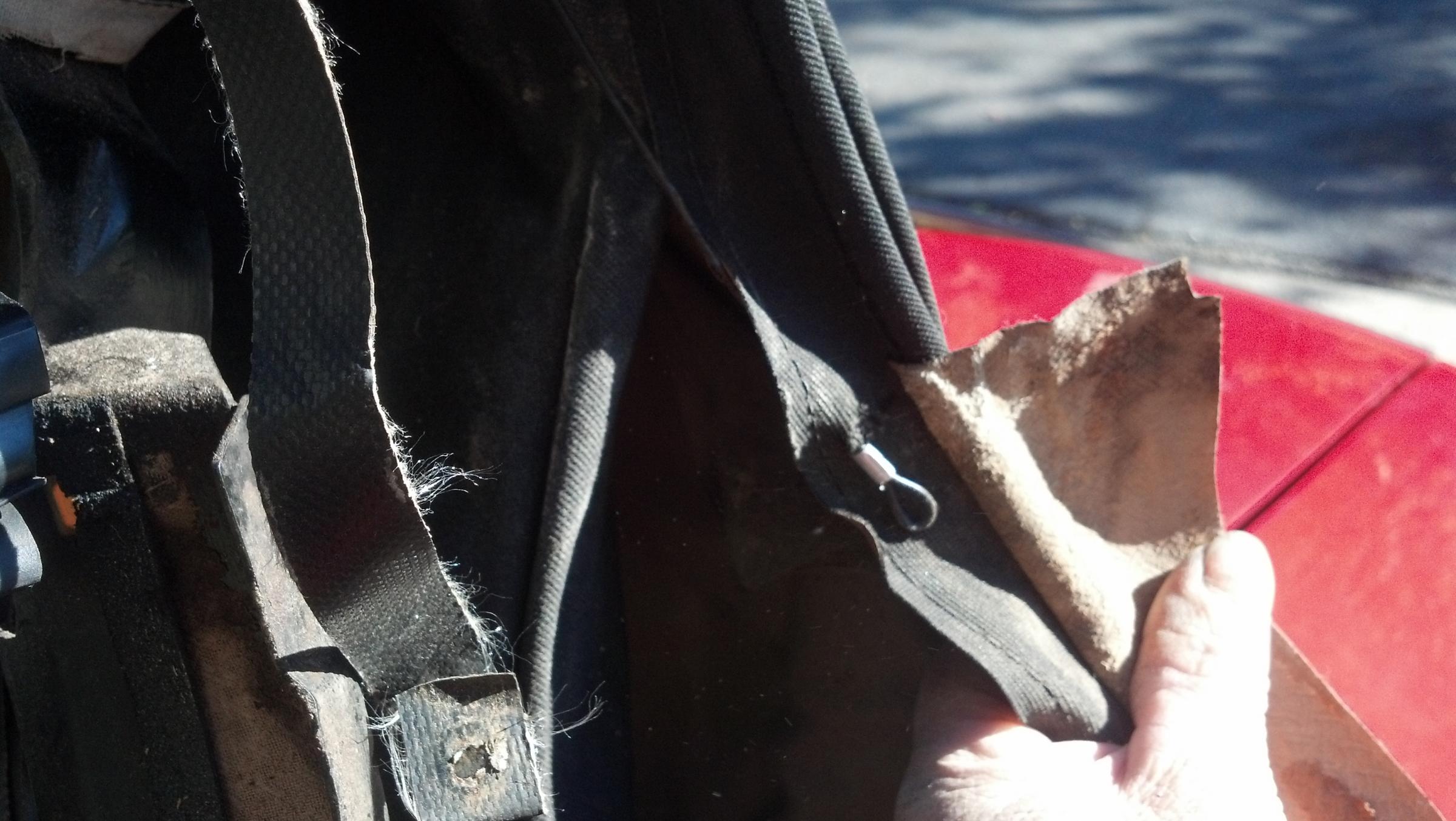

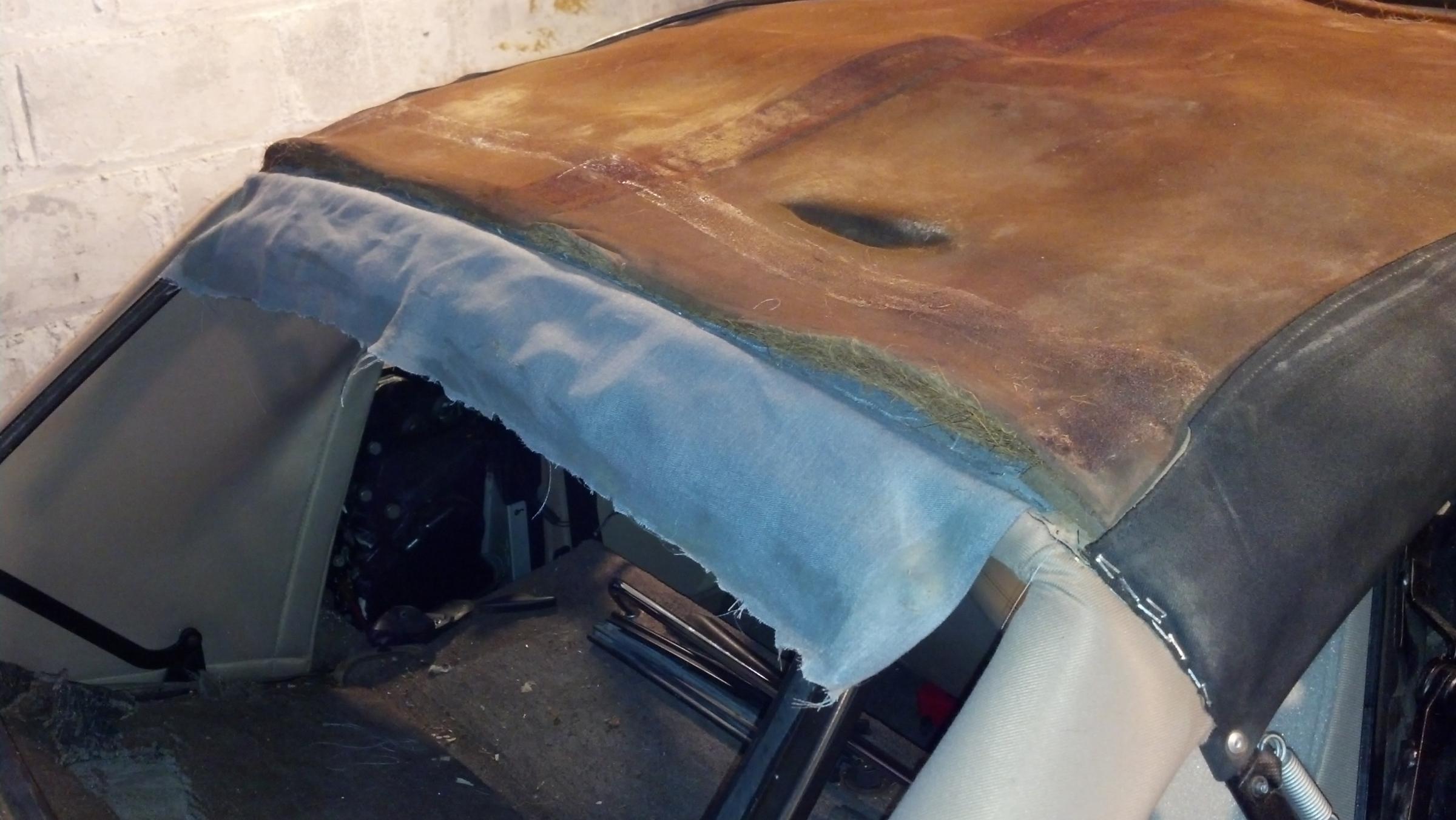

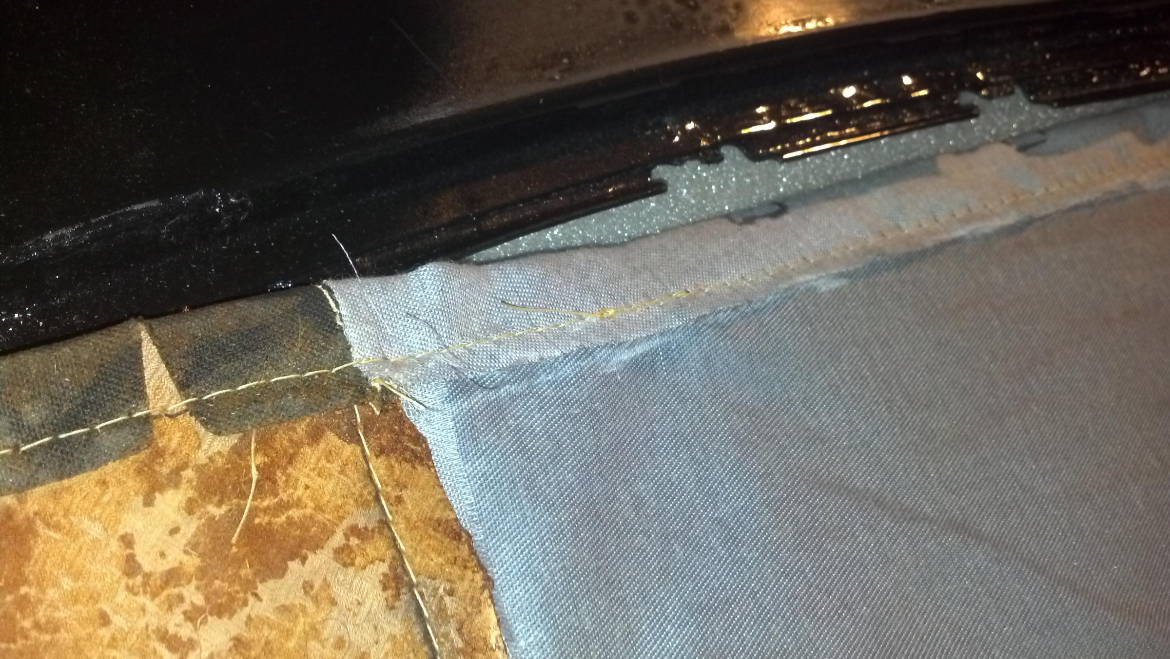

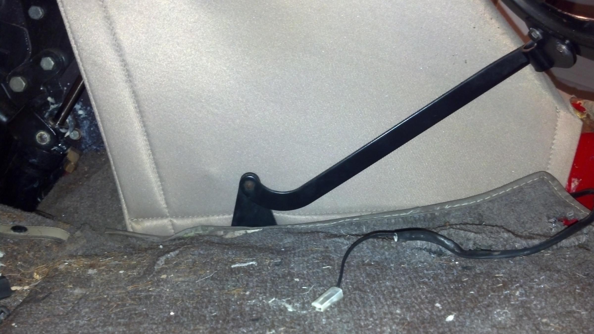

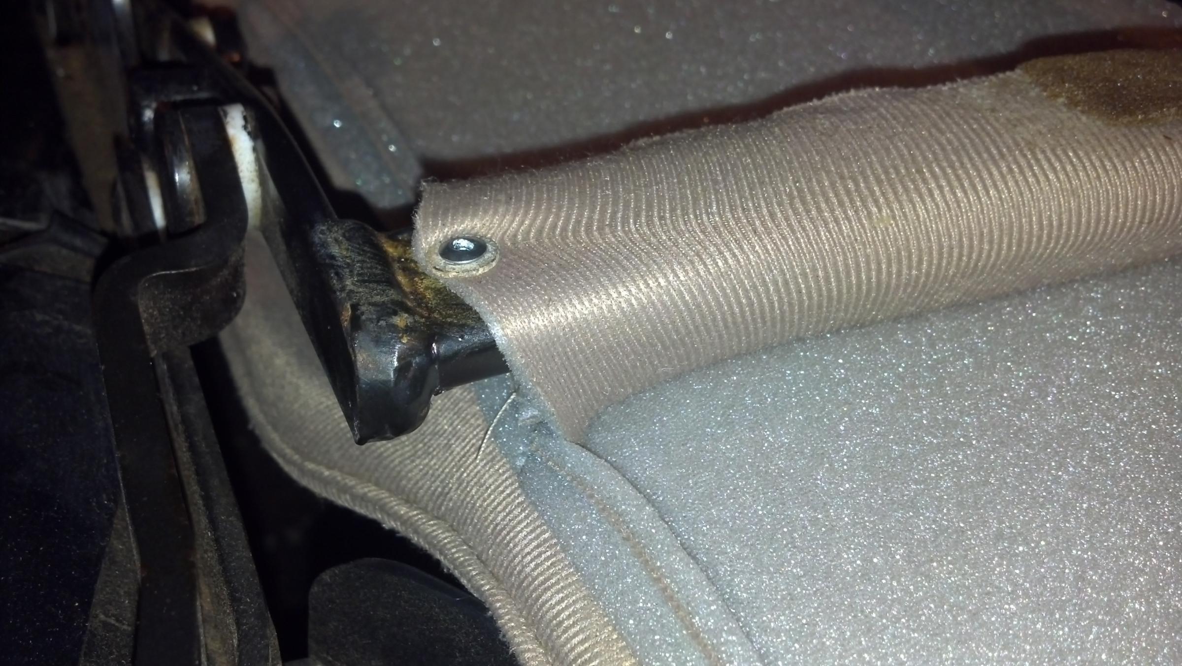

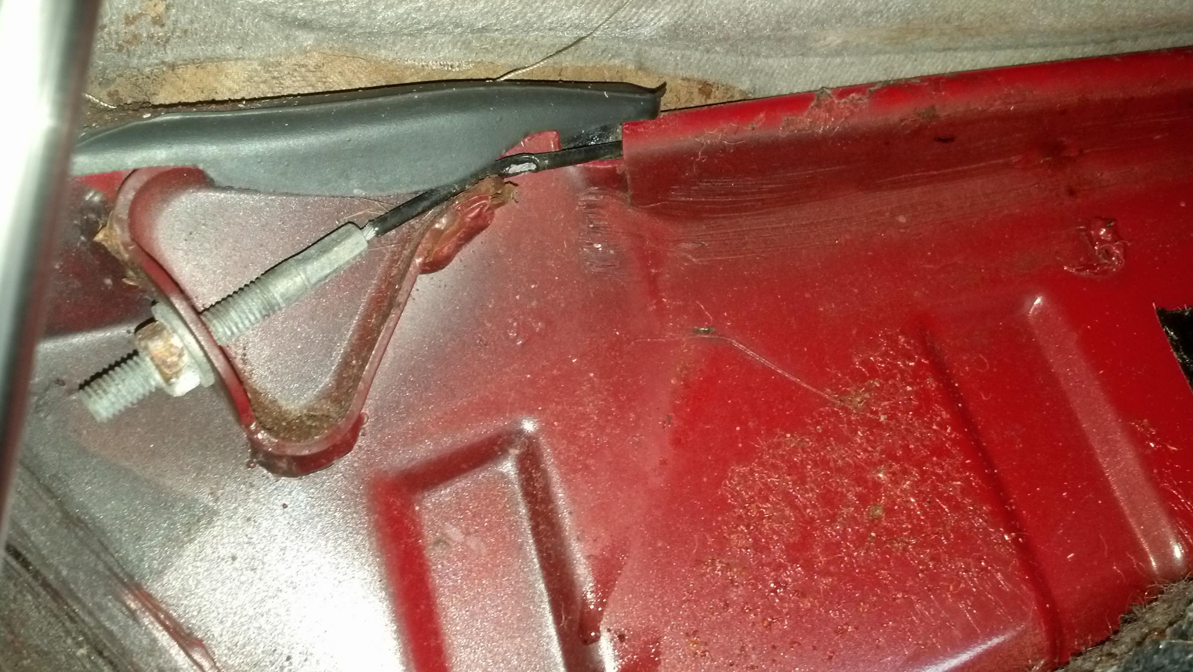

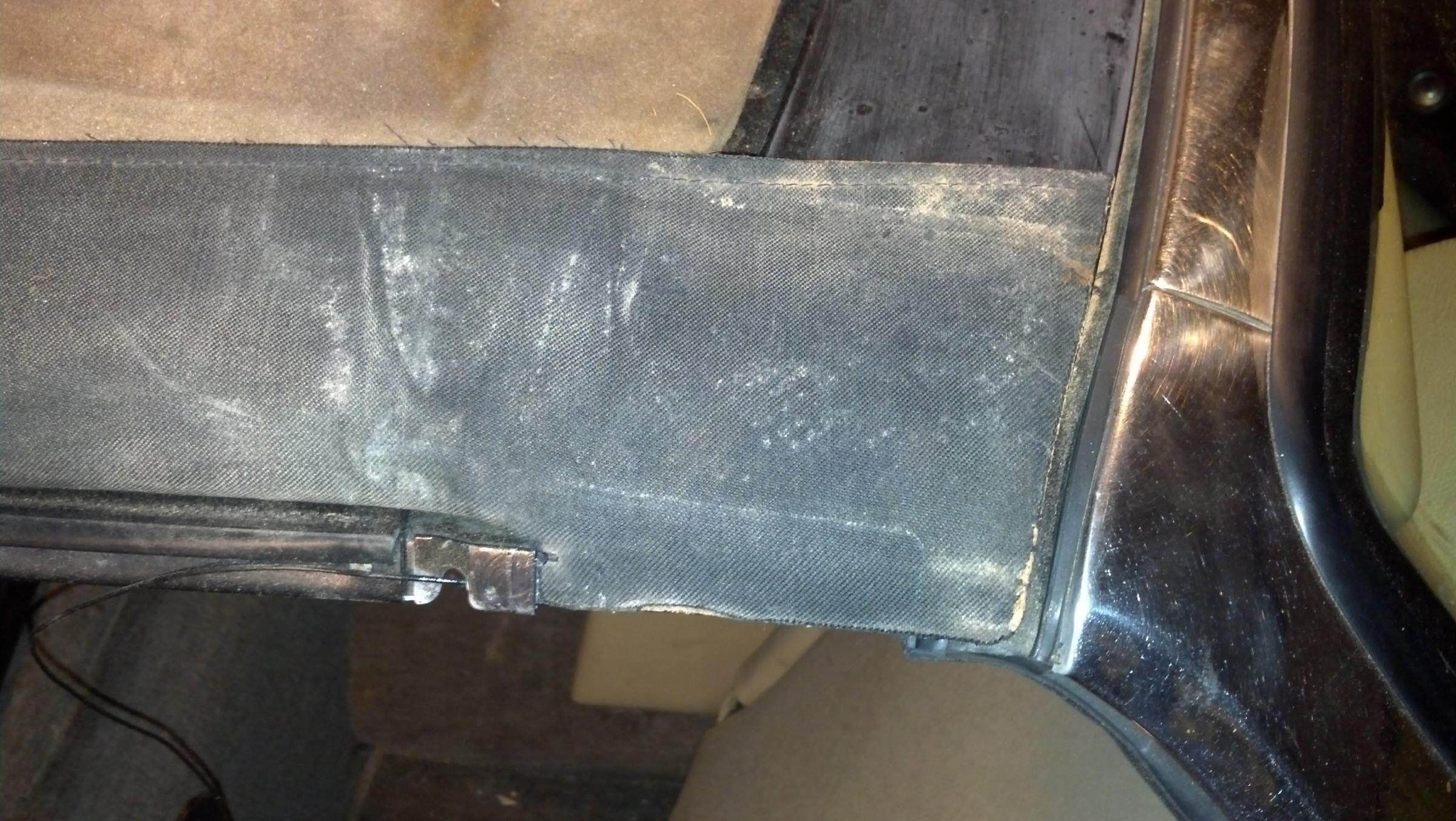

To try to simplify explaining every aspect of the top renewal I thought I'd do this. Post pictures of my project and let the persons with questions give me the jpeg number and I can respond to each question per picture. Many will be self evident. The main thing to remember is that you must take your own pictures for reference and go about dismantling the top slowly and picture yourself doing each step in reverse, maybe even taking notes and drawing pictures if you need. My pictures will give you a head start in knowing what you're up against and maybe they will make it less of a MAJOR project. One note to add, you may have rust on your frame espacially on the front crossmember. If you do you'll have to sand and paint all of these areas BEFORE anything is attached to them. I have pictures showing the repair of the front crossmember. Satin black is the color. If you can't understand the pictures then ask me about them. Specifically, there is a cable that is fed between loops of the material that covers the foam. This cable is crimped in place by tabs of metal which are part of the front crossmember. On my frame a few of these were rusted away and I needed to drill two 1/16th holes on the remaning area and use stainless steel wire to clamp the cable down but you will not only see this on your car but in my pictures. On my car this CLOTH was in tatters and I had to collect the pieces along with the two side canvas pieces and bring them all to an apholsterer to fashion a new piece and sew the two side pieces to the center cloth. Again, as you take your top apart, all of these parts will become obvious.Hopefully for anyones sake there will be few decrepid parts making the install much easier. The pics may not be in order. Here they come. Bud, More pics on next thread reply
Attached Thumbnails Convertible top replacement-2012-09-29_14-08-30_274.jpg   Convertible top replacement-2012-10-01_15-21-16_698.jpg   Convertible top replacement-2012-10-01_15-21-21_793.jpg   Convertible top replacement-2012-10-01_15-14-53_697.jpg   Convertible top replacement-2012-10-01_13-43-40_873.jpg
Convertible top replacement-2012-10-01_12-37-19_968.jpg   Convertible top replacement-2012-10-01_12-37-29_895.jpg   Convertible top replacement-2012-10-01_15-09-32_64.jpg   Convertible top replacement-2012-10-01_15-22-18_243.jpg   Convertible top replacement-2012-10-01_15-09-21_73.jpg
Convertible top replacement-2012-10-01_15-09-06_616.jpg   Convertible top replacement-2012-10-01_13-42-45_315.jpg   Convertible top replacement-2012-10-01_12-37-09_287.jpg   Convertible top replacement-2012-09-29_14-22-16_190.jpg

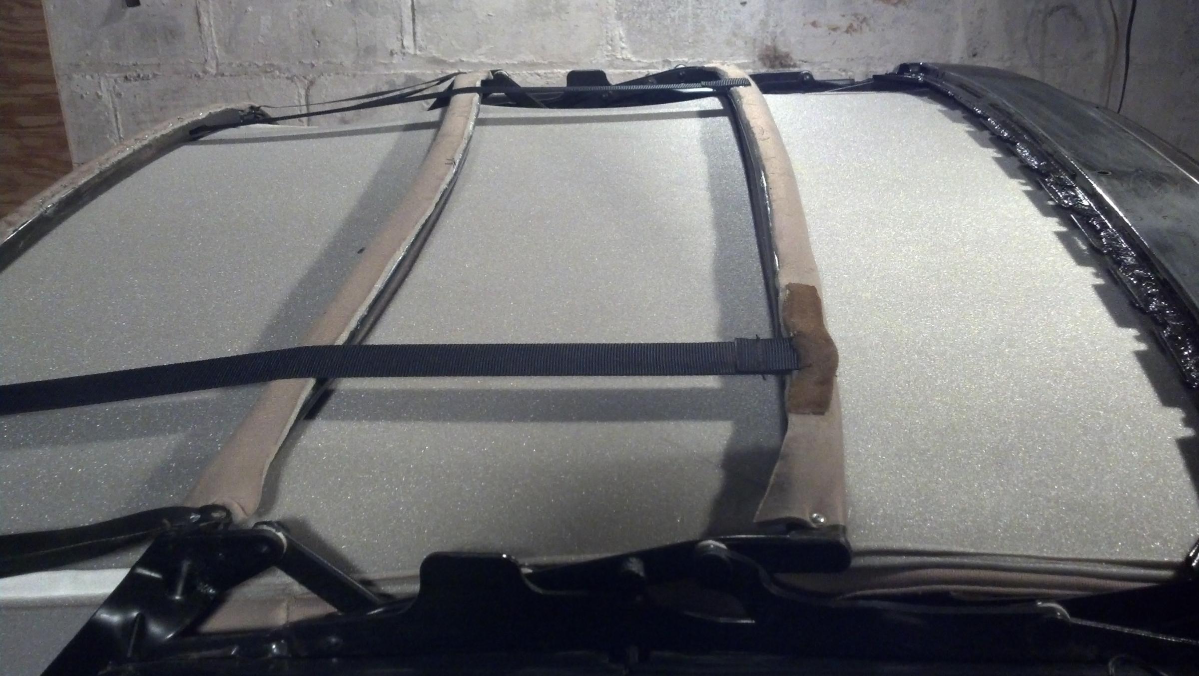

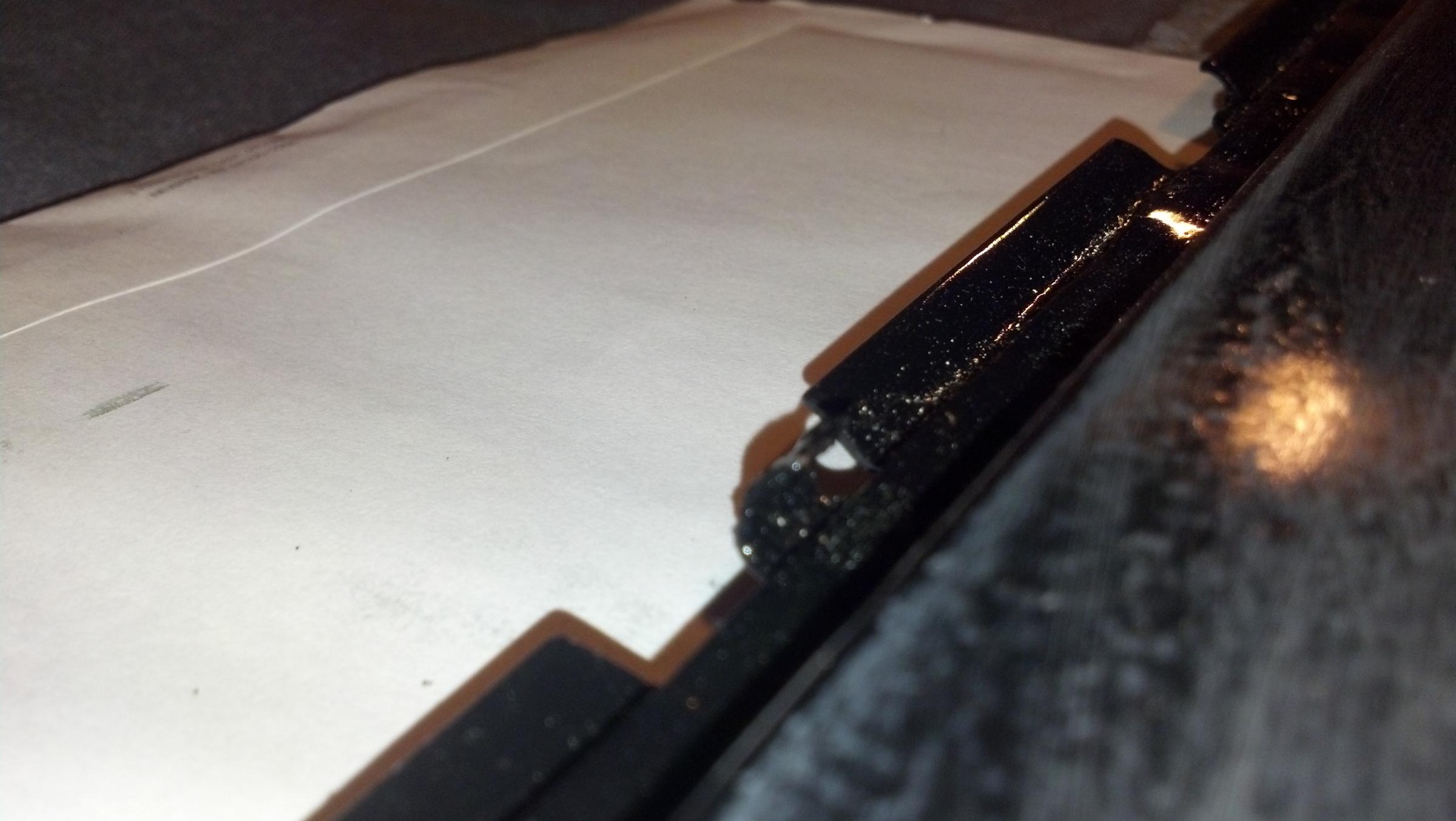

Default More pics Headliner

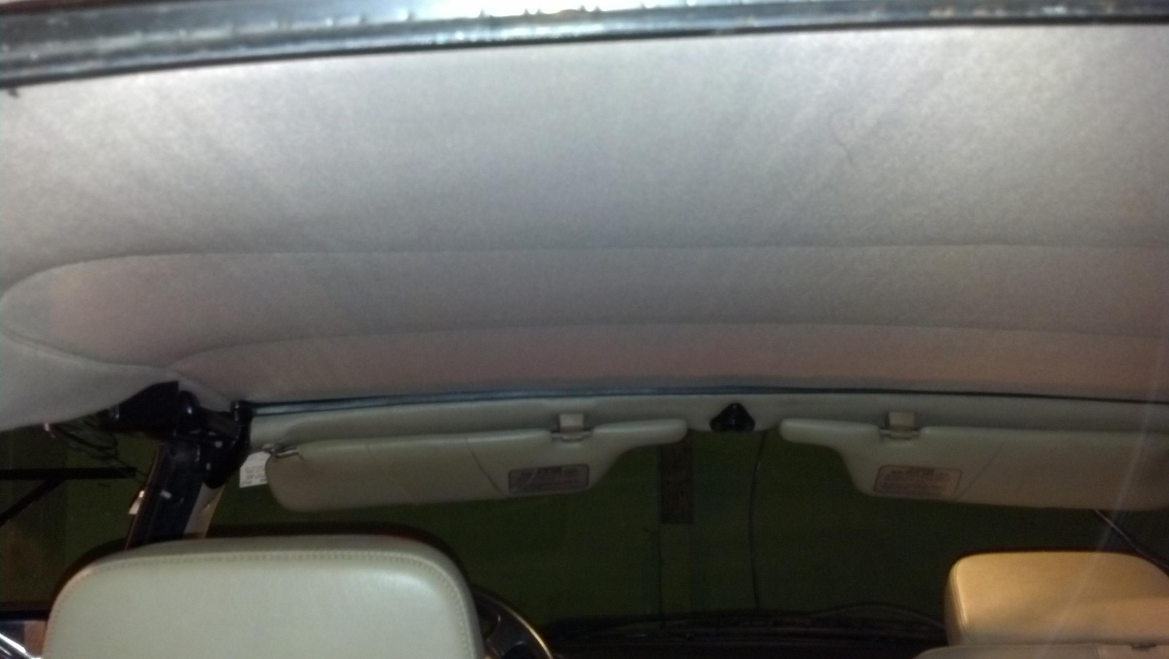

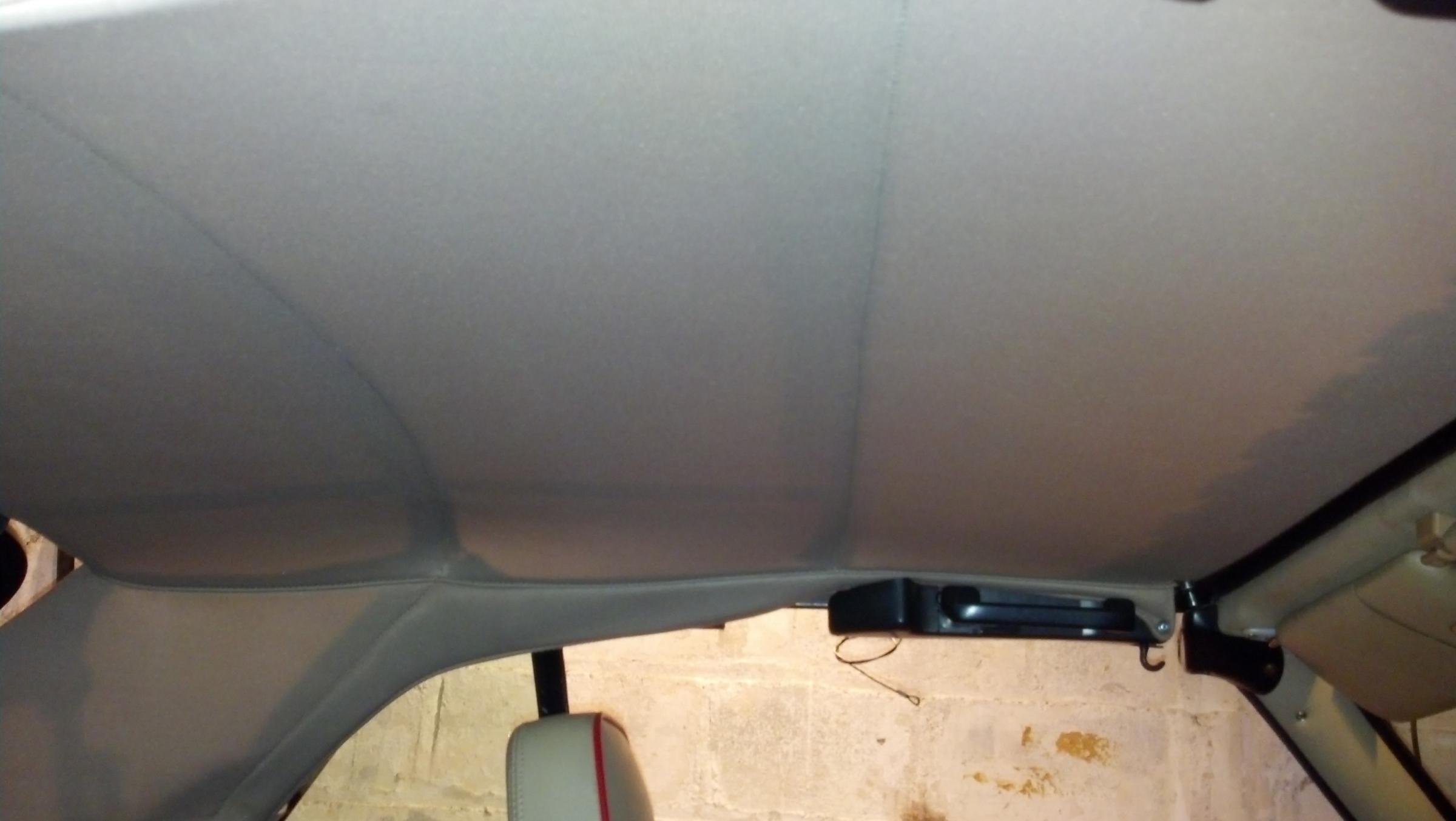

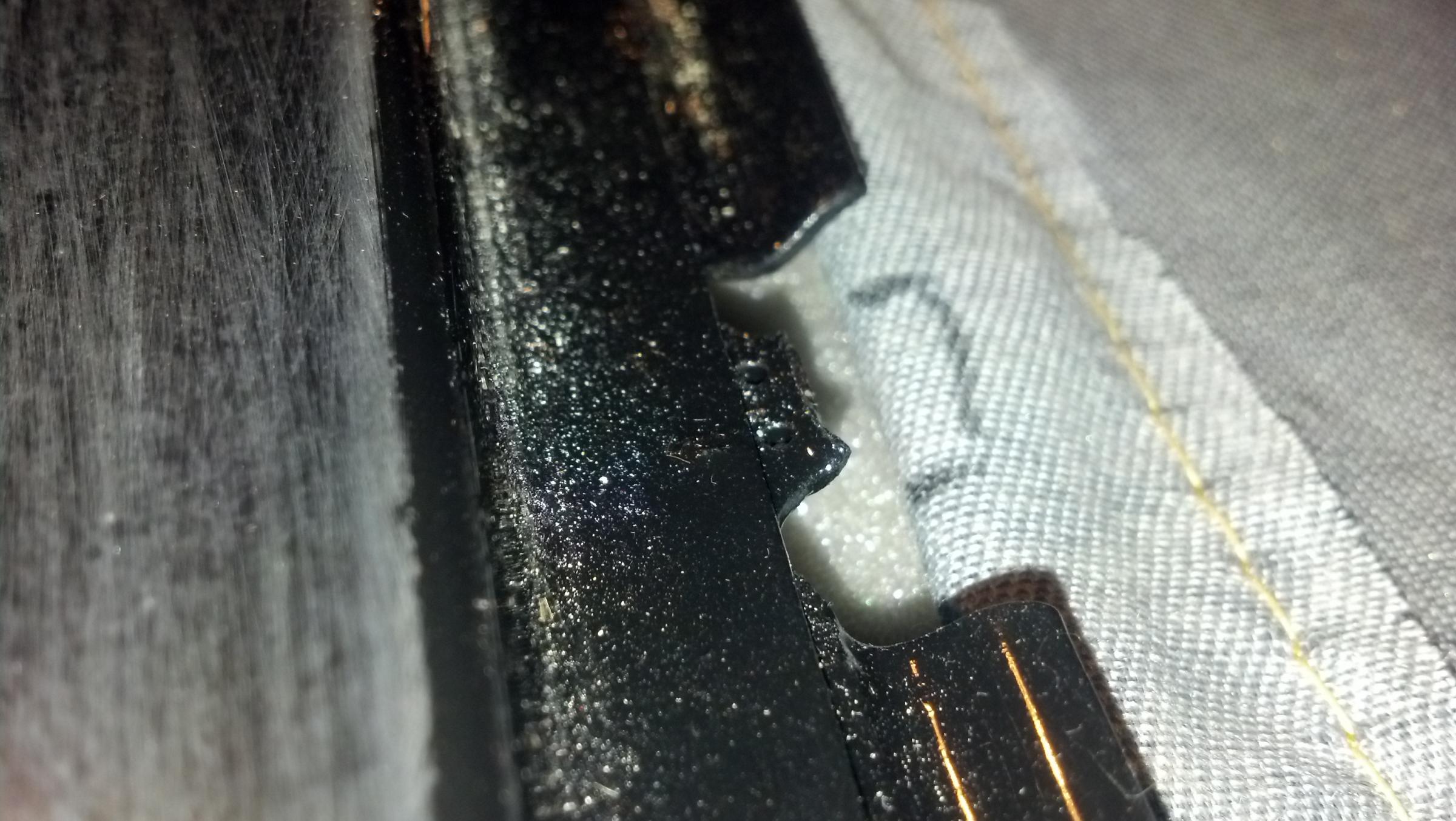

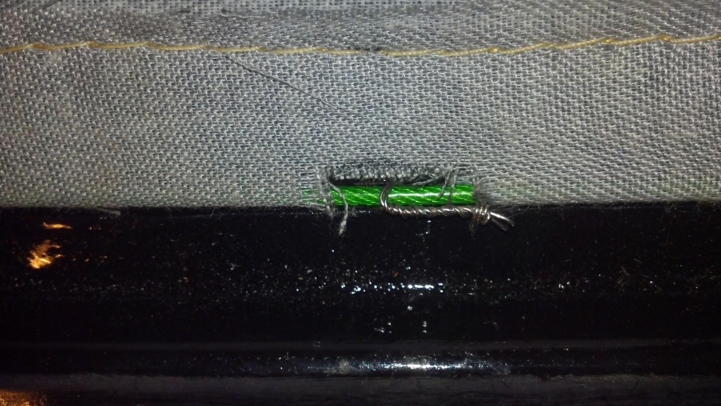

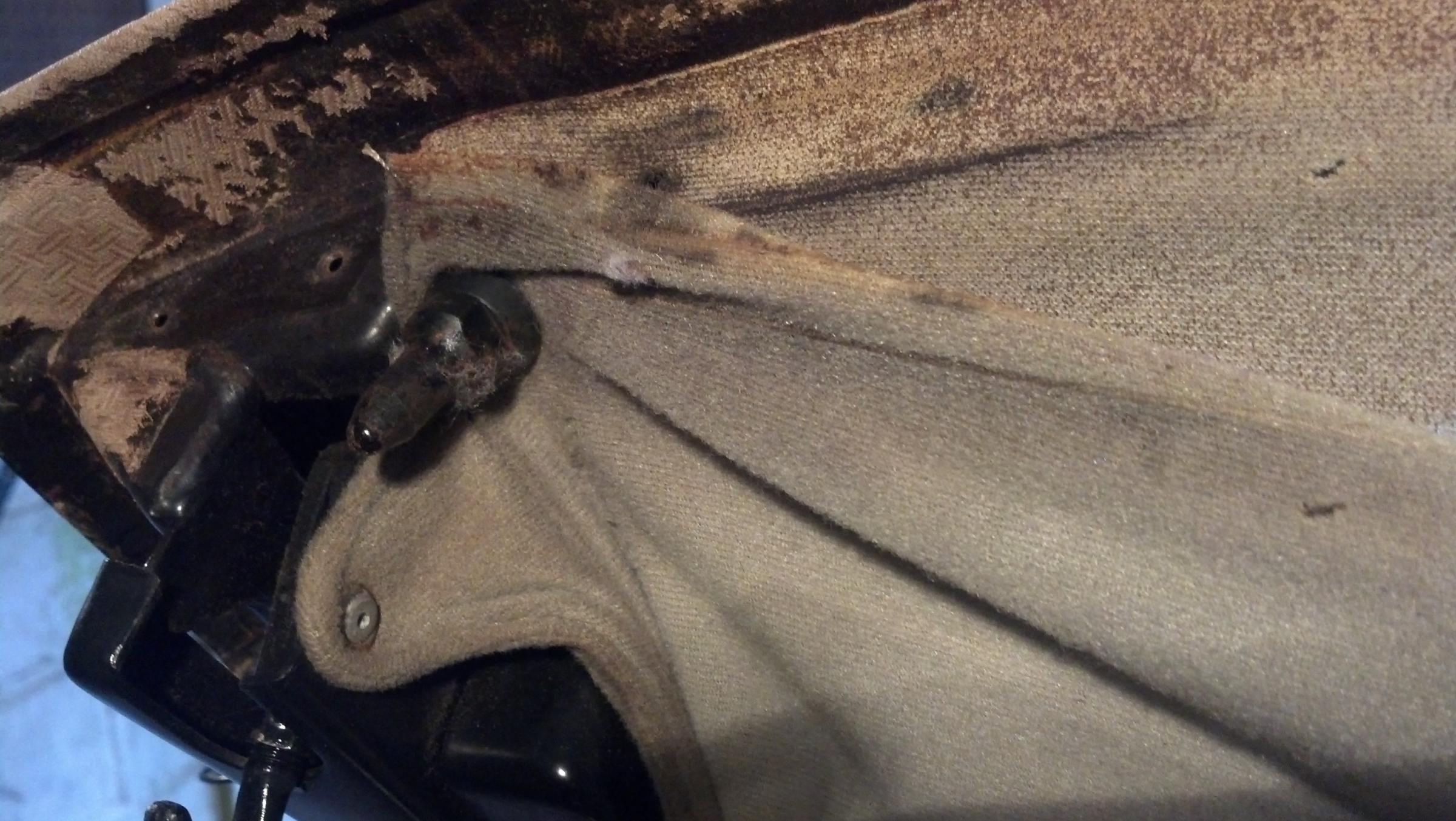

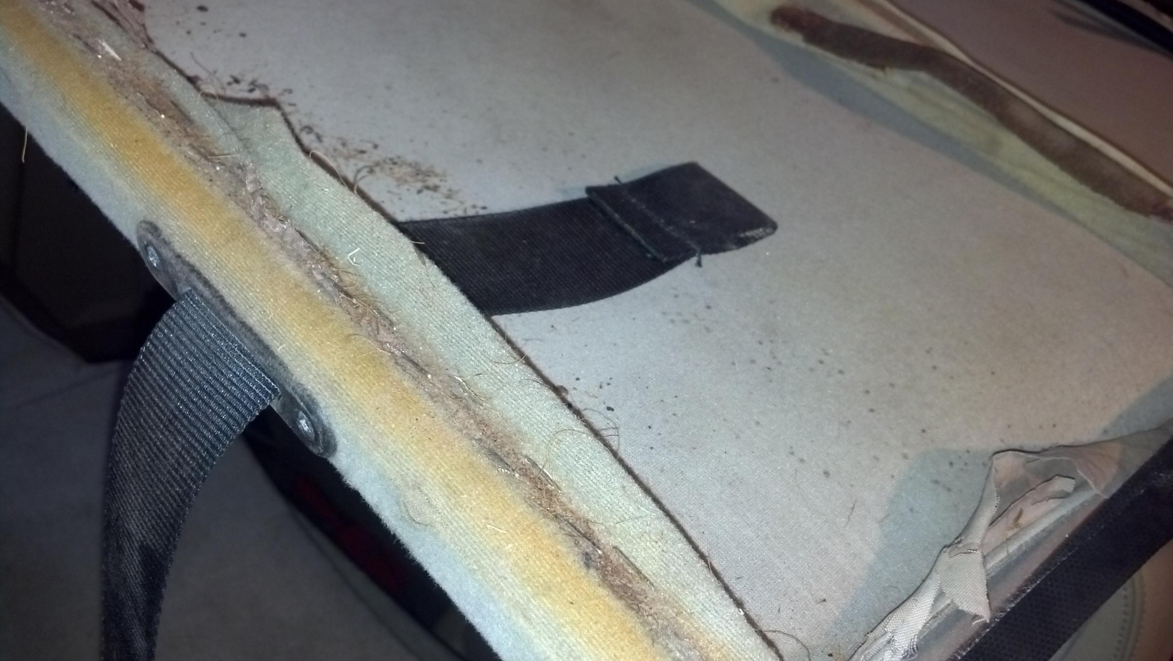

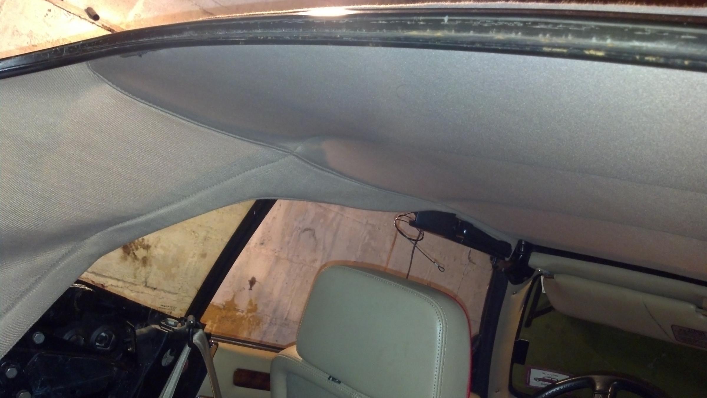

The convertible top replacement job has three sections involved. 1 inside, the headliner. 2 above the frame is the padding. 3 the final canvas top covering. Each of these procedures is a project in itself, but for anyone who likes a challenge it's for you. AAAAAnd you'll save thousands in labor costs and make your car look soooooooooo nice! Don't forget if your frame has rust it's another project to get rid of it and repaint before the install. For the headliner the frist thing you need to do it find center points on the ribs and mark them on the front side(so you'll be able to see the mark and not be covering it) and top and also mark the center of the flaps that will be glued to the ribs. Note that the front rib must be marked on the rear and the second rib on the front as the pic shows how the flaps are installed. This is the first step in installing the headliner. line up the marks (after glueing both the flap and the rib with the afore mentioned contact cement) and press lightly from the center in spots. if it's aligned properly then press firmly to complete. First the front rib then the rear. Keep in mind there will be a bit of mild stretching going on here to keep the liner taught. Take a breath and go to the next step. The rivets on the alumin. plates that hold the straps will have to be drilled out and the plates reinstalled on top of the neww liner material. A thin 1/4 thick layer of foam rubber will be glued on top of the plates. There is also a thinner side strap that must also be reriveted on top of the new headliner (see pic). Anyone attempting this task I'm sure will have a degree of skill for upholstry or at least some self reassuredness that they're up to the challenge to do this renewal themselves. These pics are meant to help anyone never having done this specific job. I'll post some more relevant pics and explanationa on the next thread. Till then soak this stuff up and ask any questions.Bud
Attached Thumbnails Convertible top replacement-2012-10-04_19-50-24_476.jpg   Convertible top replacement-2012-10-04_19-51-02_385.jpg   Convertible top replacement-2012-10-04_19-50-35_734.jpg   Convertible top replacement-2012-10-04_19-51-40_906.jpg   Convertible top replacement-2012-10-02_08-51-29_344.jpg
Convertible top replacement-2012-10-02_08-51-22_381.jpg   Convertible top replacement-2012-10-02_09-46-22_539.jpg   Convertible top replacement-2012-09-29_14-27-58_204.jpg   Convertible top replacement-2012-10-04_19-50-51_145.jpg   Convertible top replacement-2012-10-04_19-53-58_324.jpg
Convertible top replacement-2012-10-04_19-51-34_656.jpg   Convertible top replacement-2012-10-04_19-54-11_24.jpg   Convertible top replacement-2012-10-04_19-50-02_58.jpg   Convertible top replacement-2012-10-04_19-50-19_369.jpg   Convertible top replacement-2012-10-04_19-51-48_88.jpg
Convertible top replacement-2012-10-04_19-51-54_438.jpg   Convertible top replacement-2012-10-04_19-52-33_722.jpg   Convertible top replacement-2012-10-04_19-54-34_286.jpg   Convertible top replacement-2012-10-04_19-52-21_734.jpg   Convertible top replacement-2012-10-04_19-50-11_217.jpg

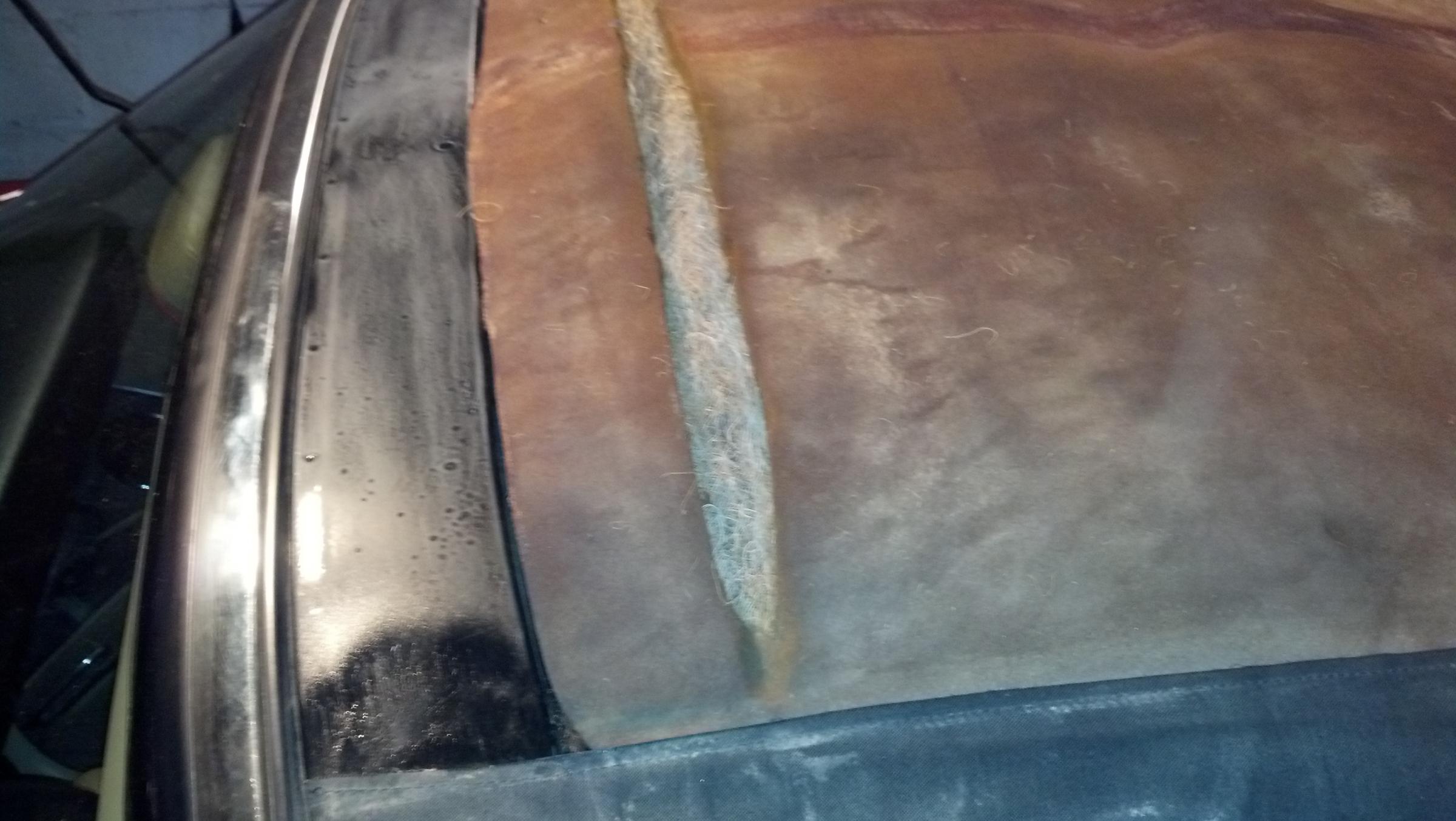

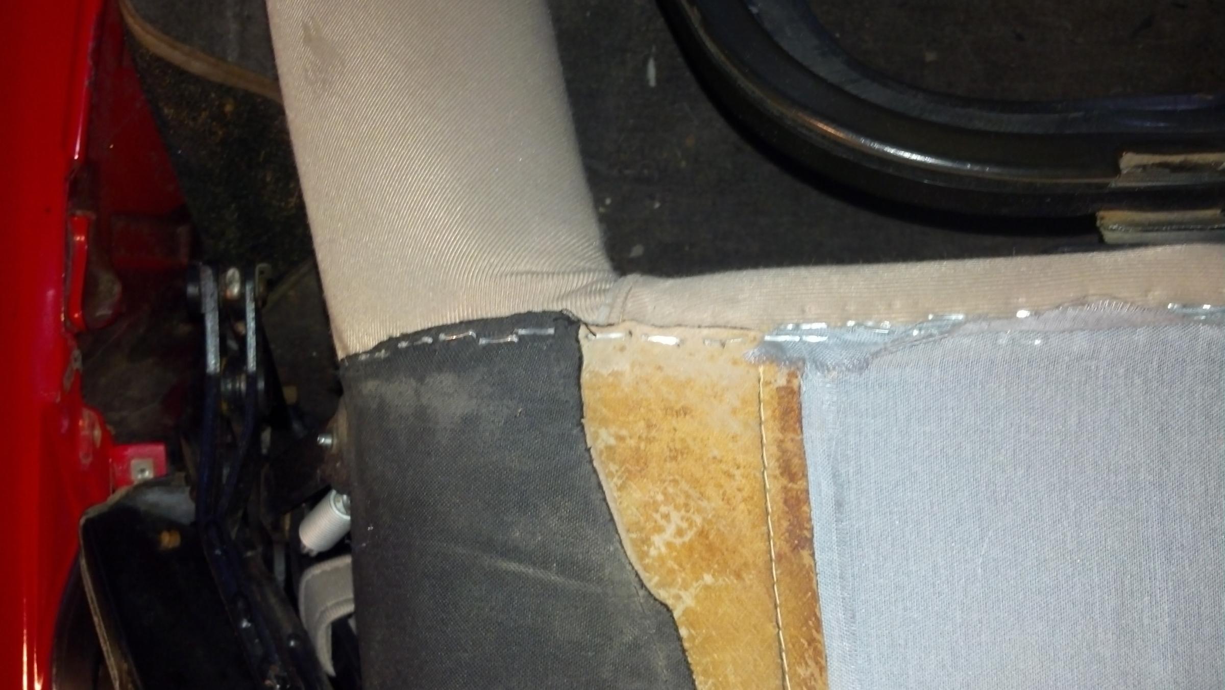

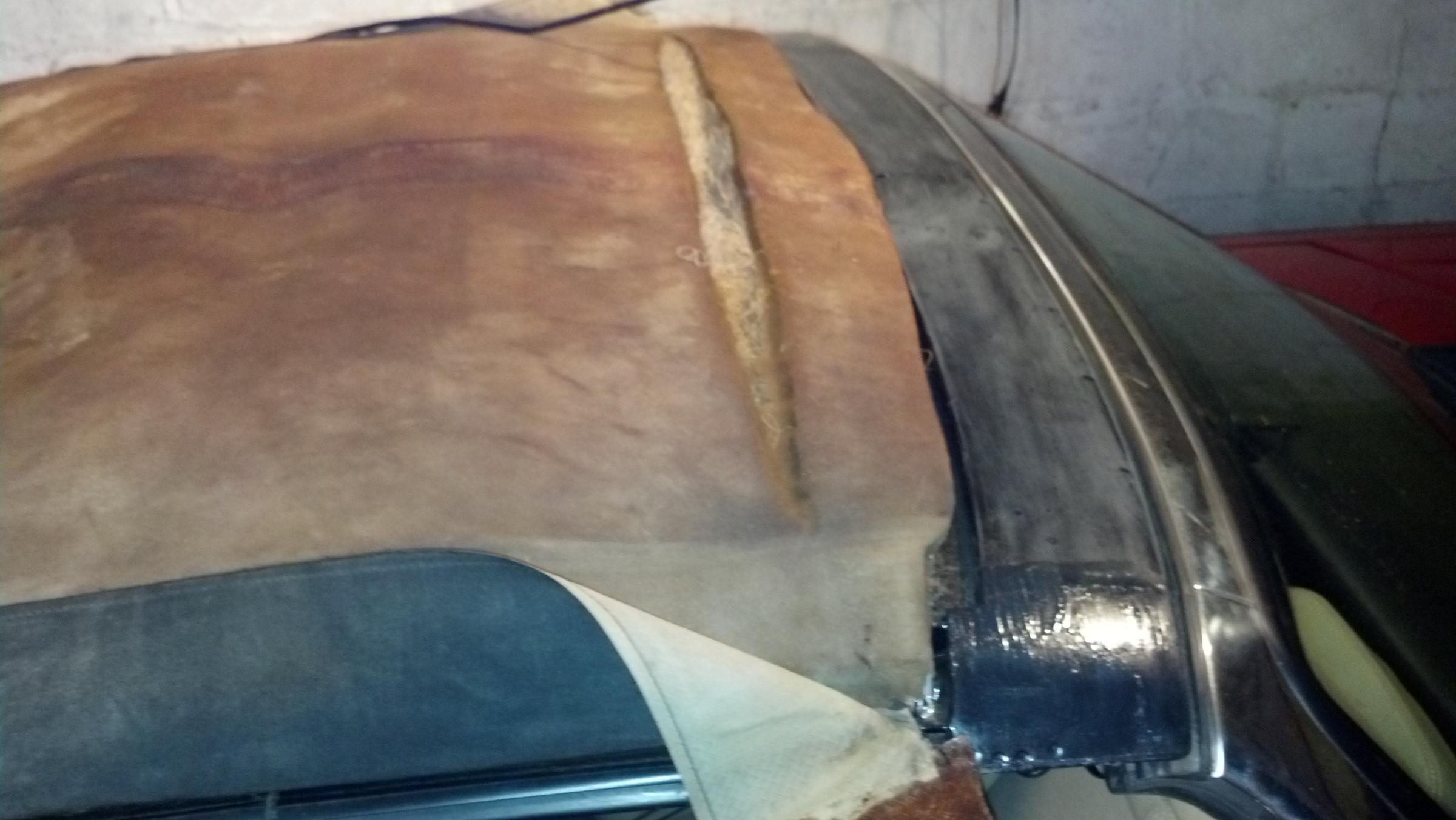

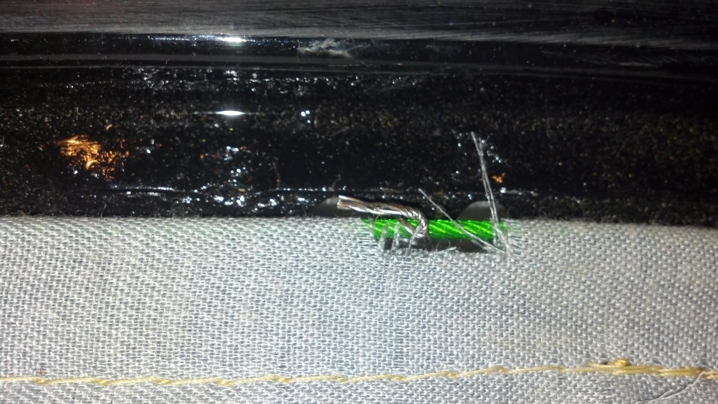

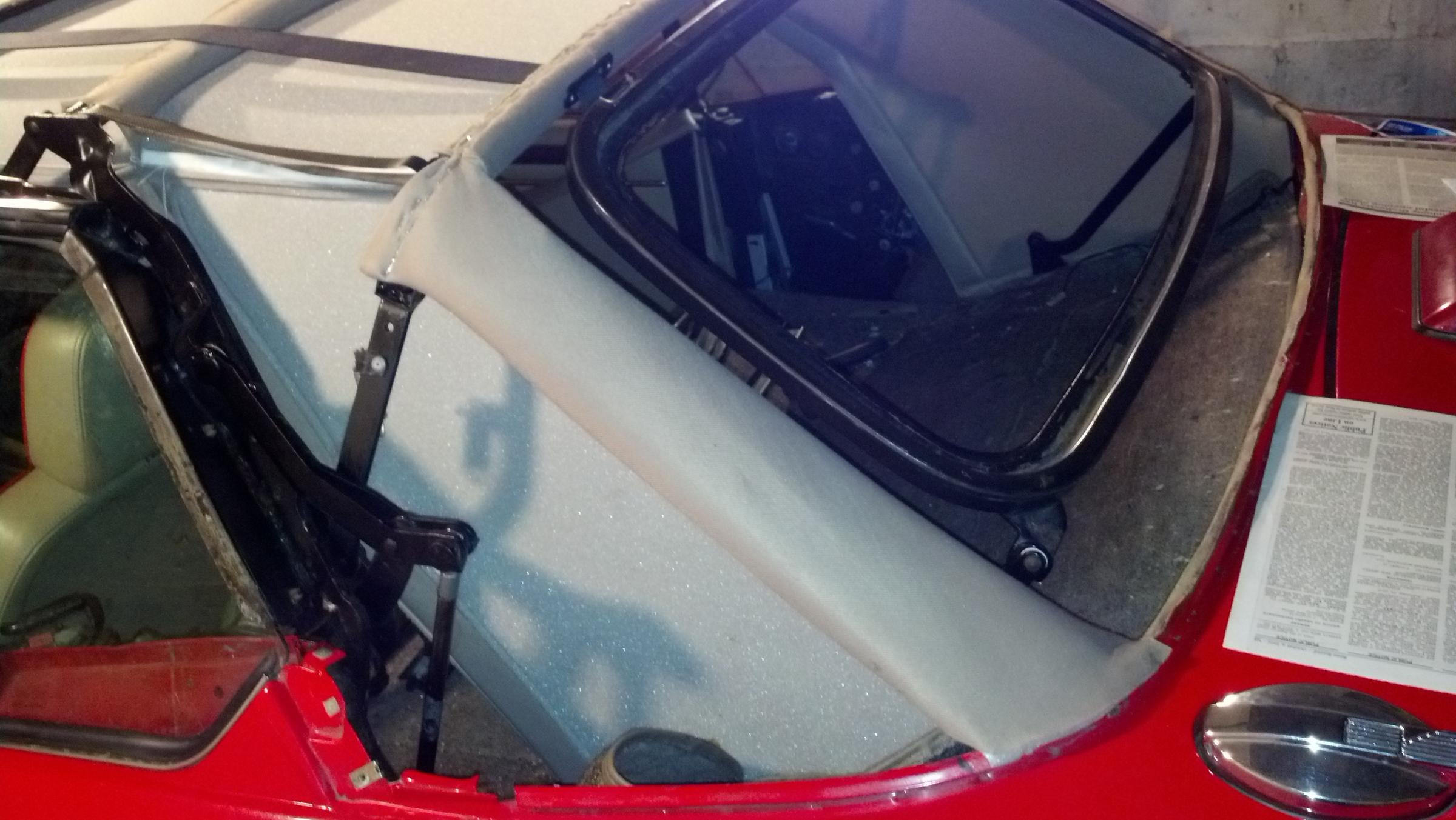

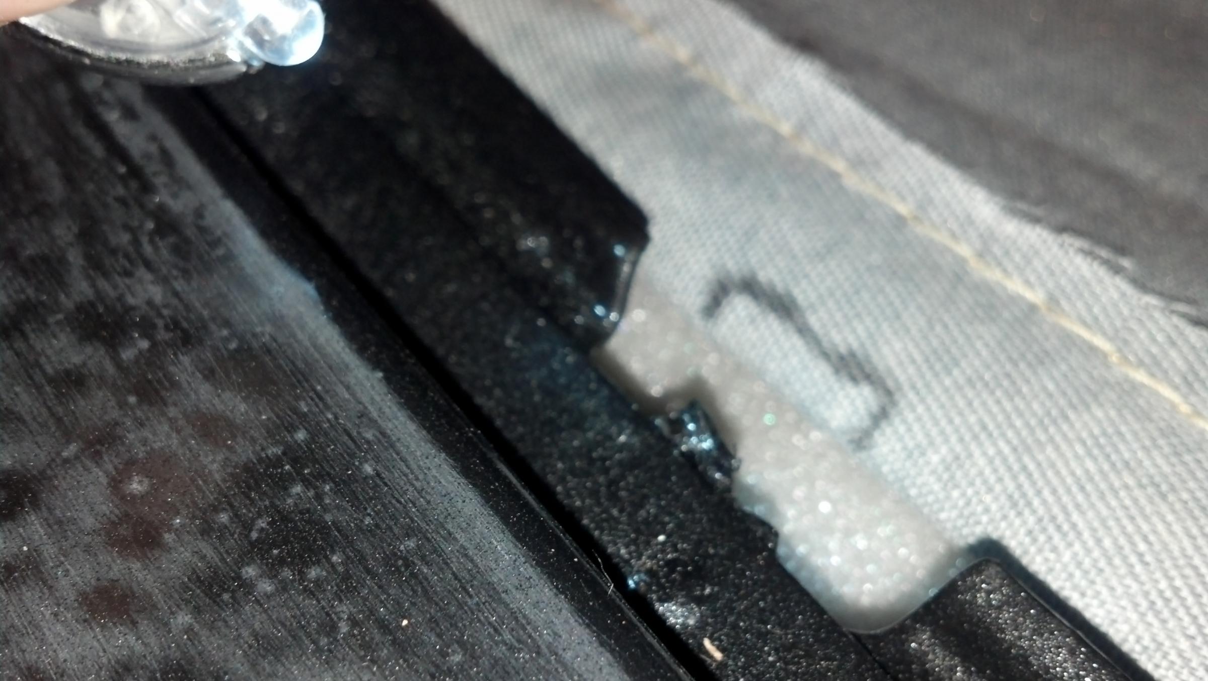

I just lost a 3 hr. thread explaining the middle padding section install with 20 pics. So.... Now i'm going to post it again in a different way. First, all the pics, then, when I can sit down again for 3 hrs, it'll be soon but I don't when just now. I'll explain the procedures for this part of the convertible top renewal. Meanwhile, everyone can digest the pics and anyone with questions can either ask or wait for the instructions.
Attached Thumbnails Convertible top replacement-2012-10-09_13-35-46_927.jpg   Convertible top replacement-2012-10-09_13-35-56_66.jpg   Convertible top replacement-2012-10-09_13-36-55_35.jpg   Convertible top replacement-2012-10-09_13-37-05_429.jpg   Convertible top replacement-2012-10-09_13-37-57_562.jpg
Convertible top replacement-2012-10-09_13-38-45_808.jpg   Convertible top replacement-2012-10-09_13-39-51_605.jpg   Convertible top replacement-2012-10-09_13-43-16_873.jpg   Convertible top replacement-2012-10-09_13-44-13_7.jpg   Convertible top replacement-2012-10-09_13-44-46_273.jpg
Convertible top replacement-2012-10-09_13-45-37_197.jpg   Convertible top replacement-2012-10-09_16-21-18_532.jpg   Convertible top replacement-2012-10-09_16-21-28_789.jpg   Convertible top replacement-2012-10-09_16-21-41_508.jpg   Convertible top replacement-2012-10-09_16-21-57_949.jpg
Convertible top replacement-2012-10-09_16-22-08_949.jpg   Convertible top replacement-2012-10-09_16-22-53_663.jpg   Convertible top replacement-2012-10-09_17-08-18_365.jpg   Convertible top replacement-2012-10-09_17-08-29_517.jpg   Convertible top replacement-2012-10-09_17-08-40_365.jpg
Convertible top replacement-2012-10-09_17-08-57_984.jpg   Convertible top replacement-2012-10-09_17-09-27_614.jpg   Convertible top replacement-2012-10-09_17-09-57_812.jpg   Convertible top replacement-2012-10-09_17-32-25_823.jpg   Convertible top replacement-2012-10-09_17-32-45_62.jpg
Convertible top replacement-2012-10-09_17-32-55_724.jpg   Convertible top replacement-2012-10-09_17-33-31_436.jpg   Convertible top replacement-2012-10-09_17-33-47_737.jpg

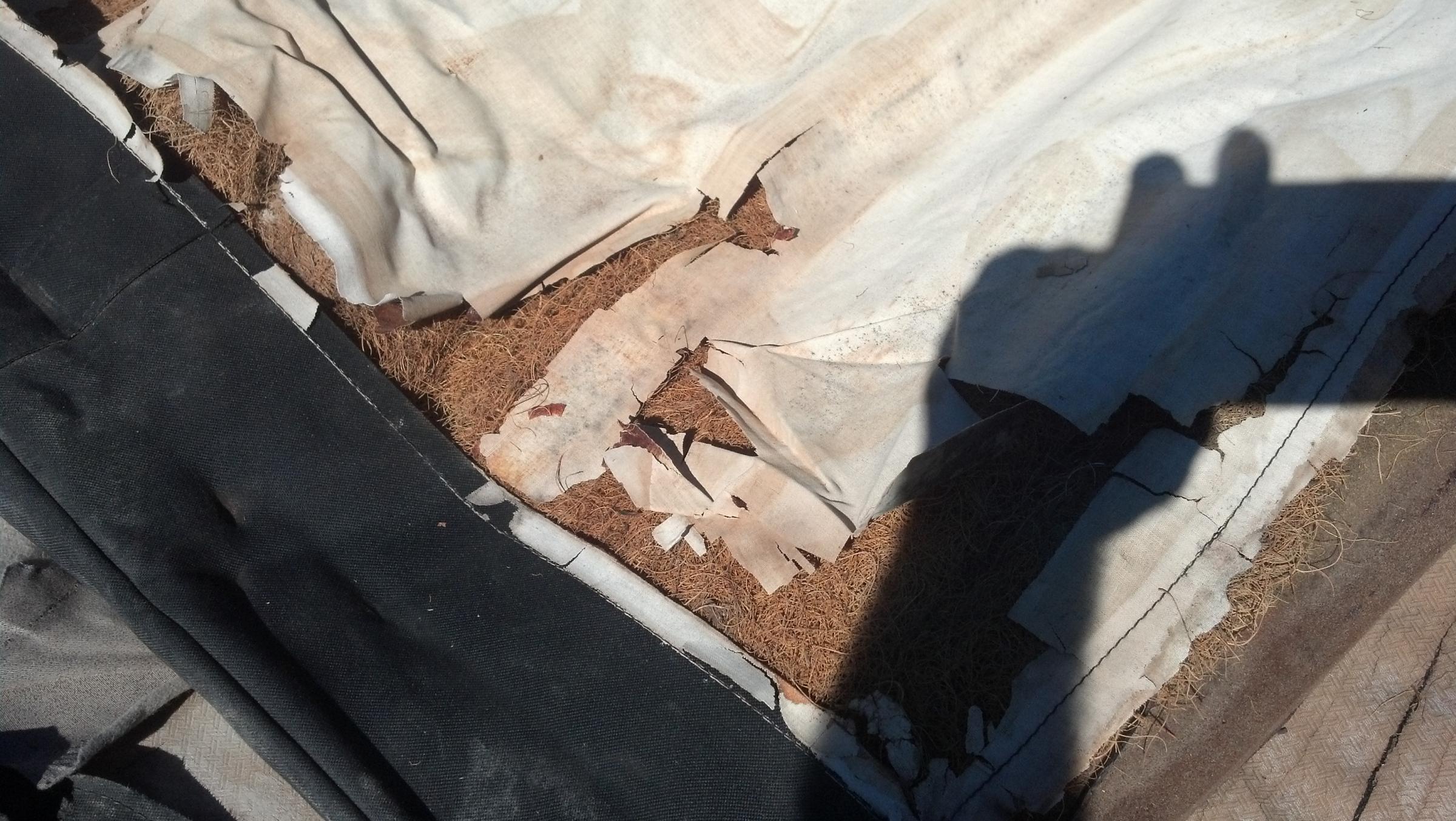

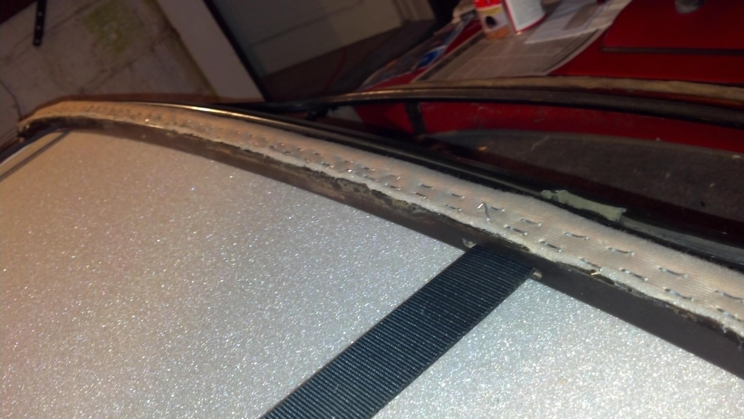

The layer above the headliner has 3 sections, 1. The bottom canvas. 2. The fiber. 3. the foam. The canvas or (tough cloth) layer provides a foundation for the fiber and foam layers and has the convertible top material edging (to withstand the frame wear), sewn to it, hopefully this is intact and you can use it over. The cloth section may or may not be rotted and need to be replaced . You've avoided a lot of work if it's intact. If not, then the easiest way to reproduce this cloth (if there's enough left to work with), is to gather the remnants and spread them out on a table(along with the top material edges), and make careful measurements, then take them to an upholsterer to be reproduced. If you let the upholsterer make the measurements it may cost you a lot more. When you get the cloth back, you need to make a center marks on the front and rear, and the front and rear cross-members, and line them up. The front has a looped edge that a cable will be fed through. This cable attaches to the front cross-member by way of small metal tabs. You will need to cut small sections out of the cloth to allow the metal tabs to crimp the cable or as in the pics to allow room for the stainless steel wire to wrap around the wire. This wire will replace any rusted away tabs. Notice in the pics that there are 2, 1/16th holes drilled into what's left of a metal tab. These holes allow the wire to be fed through for an attachment point. The cable may or may not have survived rust also if it has then you only need to drill out the two rivets on the ends and re-rivet. If not you can go to your equivalent Home Depot and get the 1/16th thick vinyl coated wire and make a new cable. you will also need new end hardware. Make a loop on one side off the car. feed it through the looped end with the cutouts. Pre-wire the holes with the wire or make sure the tabs are bent enough to accept the cable. Put a 1/8th drill bit in the remaining rivet hole and wrap the cable around it to make a loop mark on the cable for the cut length. Don't make the cable too taught as you need to stretch it up to the tabs after riveting it to the cross-member. Twist the wires around the cable and tuck them in and, or, crimp the tabs to hold the cable. There is an OEM rubber edge part that originally covered the metal tabs after they were crimped but if there are a lot of wired areas it may not have anyplace to hold onto. I eliminated this part with no consequences. The front is done. Now you must stretch the cloth at the rear and mark it long enough to have one fold left (for stapling strength) and cut the length. While holding it taught, line up the center marks you made and staple the center twice as seen in the pics. Then while still holding it taught staple from the center out to the edge on both sides. Do a double row of staples and hammer them down so they are very flush. There is a 5 in. piece of the same cloth that must be stapled to the rear rib. This will be folded up and glued over the foam layer to form a rear edge. A 1/8th X 1 in. piece of foam rubber will be glued over the staples for padding. You have to fold the vinyl sides up but wait till you have the foam layer on. The convertible top material sides are riveted at the rear, but should not be until the foam layer is installed. The front is glued. The next layer is the fiber. I believe it's purpose is to provide an air layer as the top gets VERY hot in the summer. Hopefully you gathered this layer up carefully as I don't know of anywhere to get more or a suitable replacement. Put the fiber layer over the cloth and try to level in uniformly. It can be pulled a little to do so. You're now ready for the foam. Place the foam on top of the fiber and glue in pieces of pre-cut and formed foam into the spots where it's gone. Make sure they're flush as the top will conform to any irregularities. Fold over and glue the cloth at the rear from the center out making sure it's smooth. rivet the rear of the folded up convertible top material edge and glue the front to the cross-member. This part is done. Please feel free to ask any questions. I'll be sure to answer if I know. NEXT!! The top. Soon. Bud
