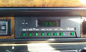

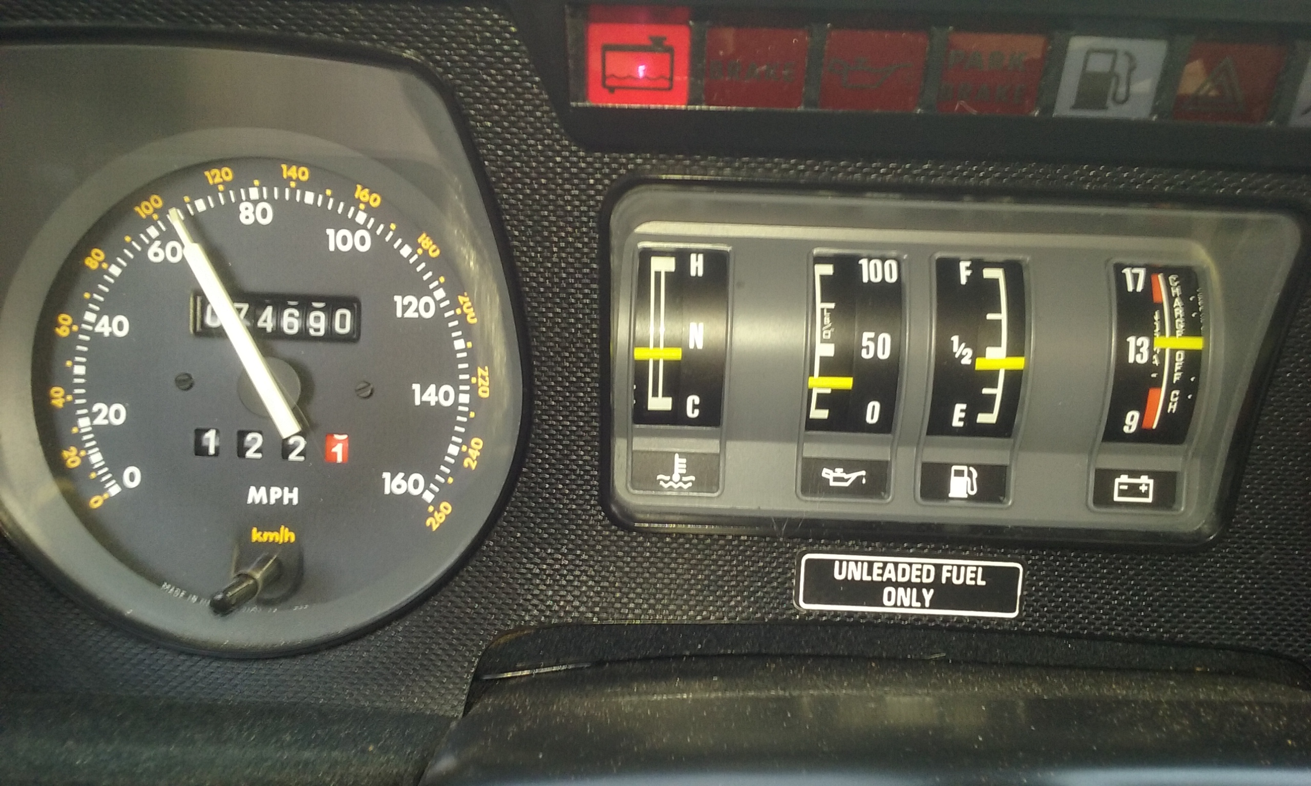

So cool: My XJS 'Princess' goes 70 mph in 90 degree weather without cooling problems. My mechanic replaced the entire cooling system except for the radiator, even 26 hose clamps.
And on her 200 mile test run she even earned her H.E. badge at 17.2 mpg.
It is a good day in lala land.
