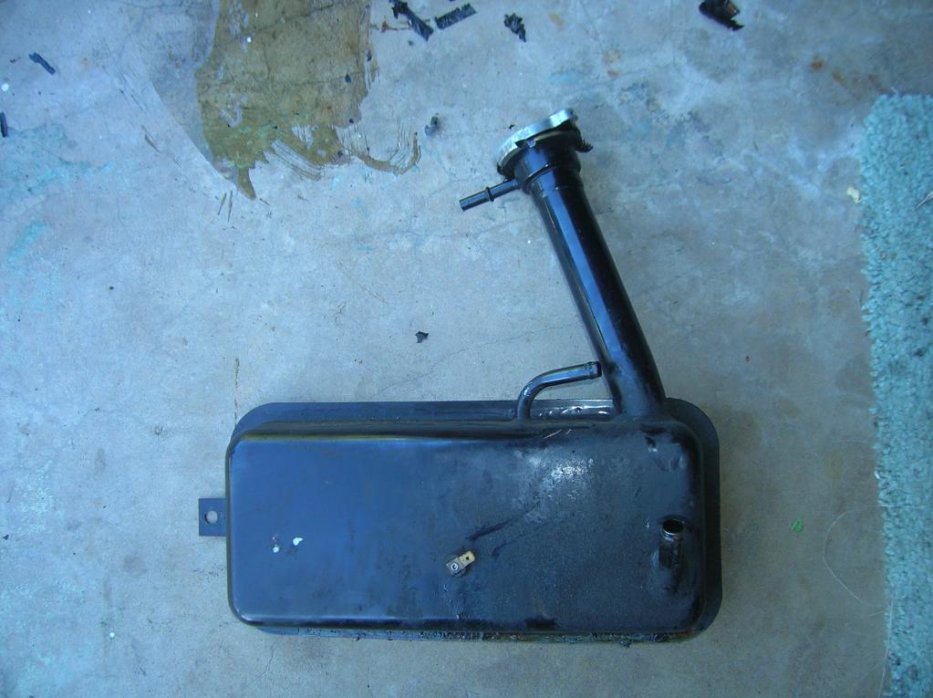

I got the tank out, here's a pic. It's rusted and leaking from multiple spots on the bottom. I'll take it to a radiator shop and see what they can do. Is there a sensor of some sort inside this that I need to be aware of?
Thanks for the help!

Being that rusted, I'd bet the connection at the plastic tank (in the fender) is clogged. One tell tale sign of that is a rusted fender just behind the wheel and above the rocker panel...
Yeah, that's a low coolant sensor in the side. Might wanna order a new seal if a radiator shop is gonna be applying a lot of heat <shrug>
DD
