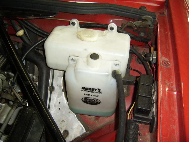

My atmospheric tank is the "Moreys bottle" and it is 1ltr capacity, and been there for years. Just too slack to remove the label.
