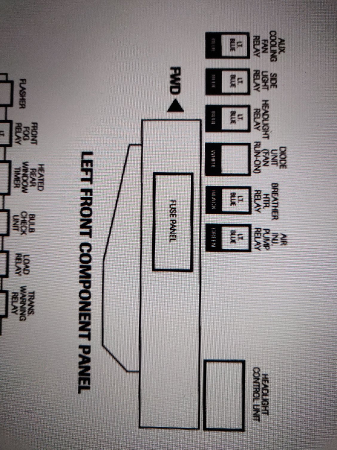

Hi, sorry for a basic question but I’ve looked at the diagram for item 24 the diode pack for the fan. It looks like it would be in the middle of the engine bay under the windscreen, but I can’t find it? Is it under the bonnet or is it accessed from inside the car somehow?
Thanks in advance
Old Sep 4, 2020 | 06:46 AM
malc4d's Avatar
Posts: 1,704
Likes: 470
From: Orlando
On my car its under the bonnet in the left side row of relays. This a '93
