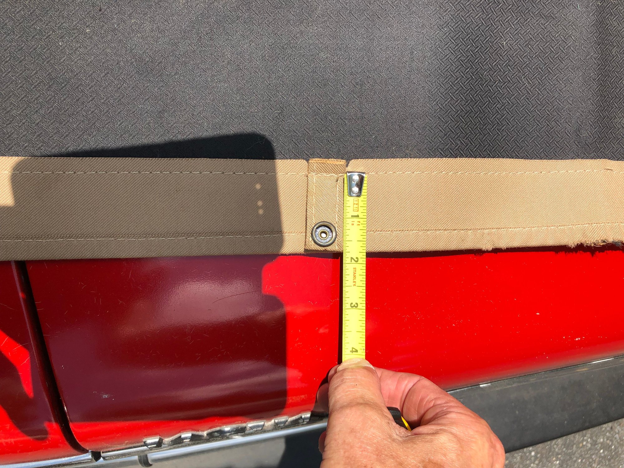

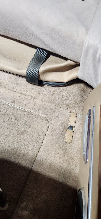

I have a 1993 2 seat convertible with the rear locker. For this car the procedure is to first fit the outside of the cover using the 6 loops on the hood itself to engage the matching clips on the cover. Then attach the press studs on the rear quarters ( the paintwork behind the rear window glass on the outside and on the top of the upholstered panel inside the rear window glass. Then you may have two loops on the cover which the straps behind the ends of the rear locker go through and/or two snaps on the small vertical carpeted surface above the back of the locker. If the top has not been fitted recently, it will likely be very tight. You must make sure the top is fully lowered and the fabric and glass has all folded down nicely. Hope this helps. Tim

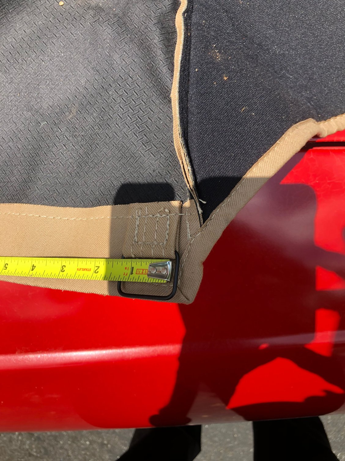

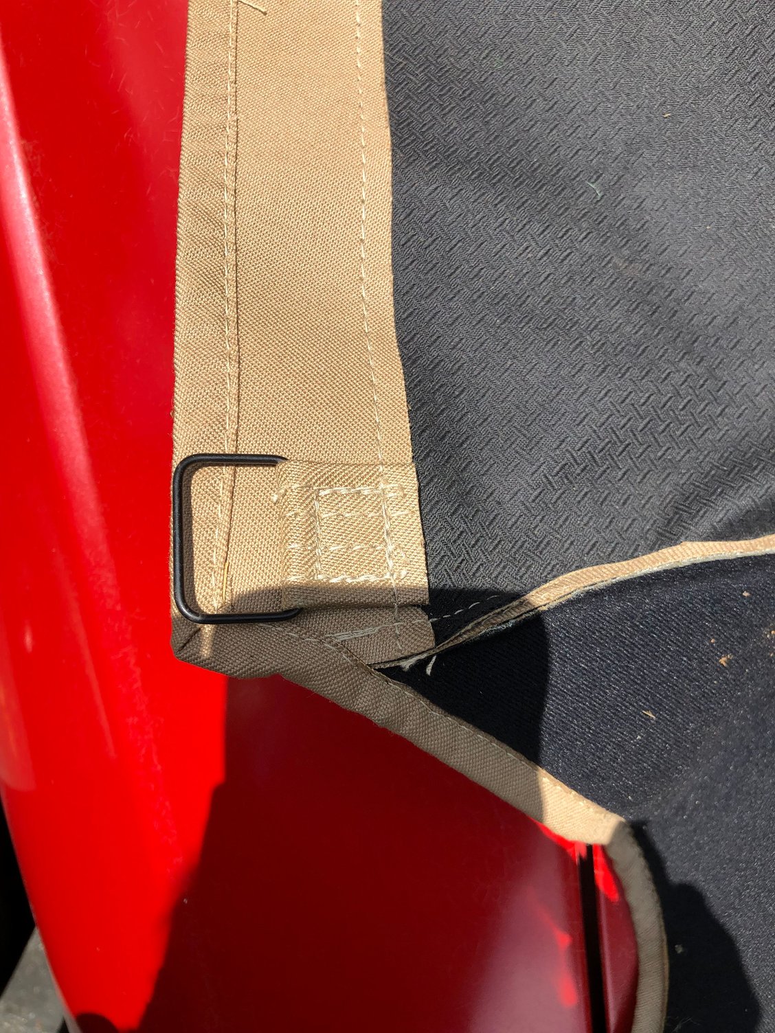

The cover should have two black rectangular wire loops attached to it at the same places as the straps. The straps unsnap and pass through the wire loops and snap back down in their original locations.

4 pics attached, showing the loop and metal wire rectangle, that the straps pass through, the strap in place and the snaps for the center buttons.

Thanks for the pis, I definitely don't have the correct top..., I don't think mine even goes that deep into the rear seat...

Ahha, we are talking about the folded top cover, not the top cover. Yes, you need to get the top cover fot the 1988 to 1994 one.
