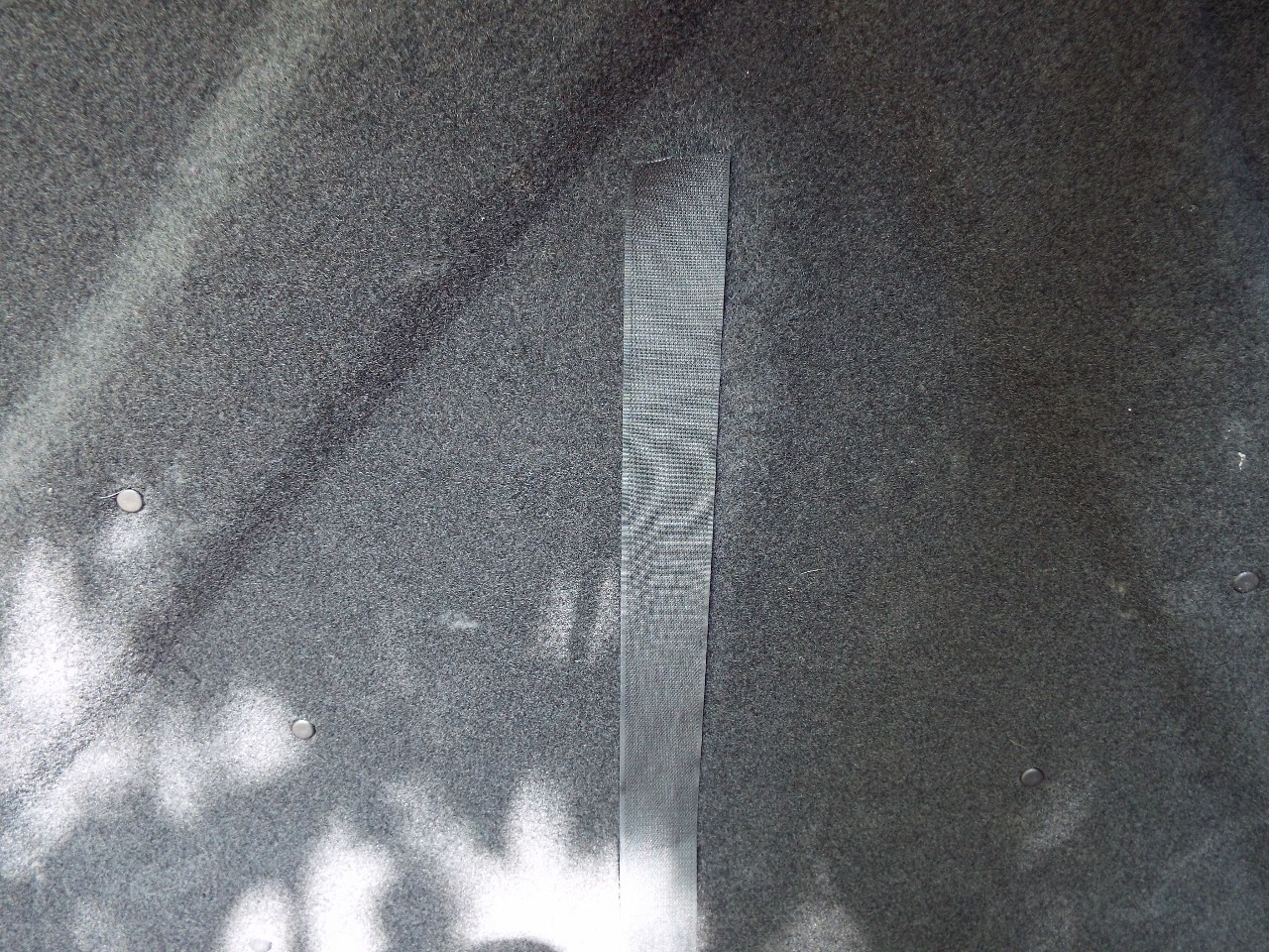

I also was unhappy with the tonneau flopping and rippling too much at speed, so I had the hook side of velcro sewn to each of the 3 flaps that tuck into the trunk. The velcro straps are about 16-18" long and attach to the felt liner on the underside of the trunk lid. I pull them quite taut, and there are virtually no ripples or flex at any speeds ( including those that are 50 mph over the legal limit). I will take photos later after an appointment and post them. It's an easy fix for under a couple of dollars and 5 minutes of time.

Pictures as promised. See below. Absolutely no flapping. I have also added two pieces to the sides that velcro to two pieces of the loop velcro that I have glued to the undersides of the body where the side wings tuck in. In addition, I have sewn a strip of the hook velcro to the front flap that tucks in behind the back seats. The hook catches the velour so that you don't see a big gap any longer between the back seat back and the tonneau.

Looks like a nice clean fix tberg.
