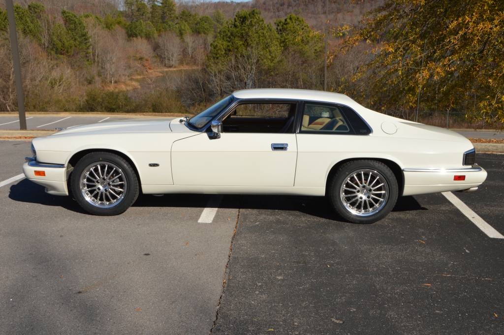

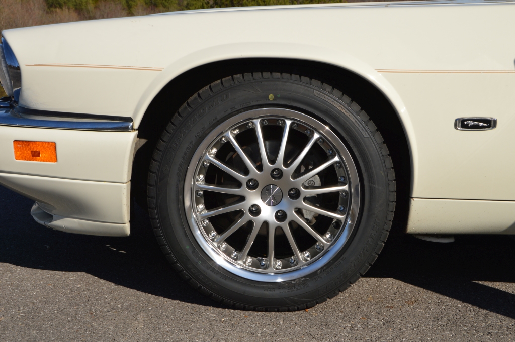

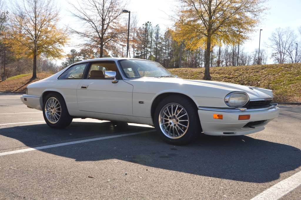

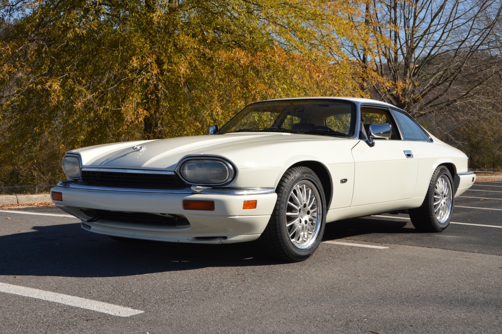

Got a Christmas present for my '94: AutoAnything had a 15% off special on TSW wheels, so I yielded to temptation and bought some 17"x8" Coventry Whitley Hyper Silver wheels for my '94 XJS 4.0 Coupe, that had been sporting TearDrops.
Specs are: COVENTRY WHITLEY 17X80 5120.65 ET25 CB 73.9 HYPER SILVER W/MIRROR CUT LIP TSW ALLOY WHEELS, 1780COW255121S73.
I mounted them with $75 Sumitomo tires from TireRack. Specs are: 225/55R-17 SUMITOMO HTR A/S P02 (W-SPEED RATED) XL.
So, for ~$1000, I got a beeeeauuuuutiful set of rims w/ tires. OMG, they are gorgeous. Plus, I can eBay the TearDrops and/or the Daytons off my '90 parts car and gain some of that back.
So without further adieu:
Coventry wheels on my '94, and refresh update-sdsc_9676.jpg Coventry wheels on my '94, and refresh update-sdsc_9644.jpg Coventry wheels on my '94, and refresh update-sdsc_9647.jpg Coventry wheels on my '94, and refresh update-sdsc_9656.jpg Coventry wheels on my '94, and refresh update-sdsc_9665.jpg Coventry wheels on my '94, and refresh update-sdsc_9674.jpg Coventry wheels on my '94, and refresh update-sdsc_9681.jpg
With 17" rims, I chose the 225/55 tires so that the overall diameter would match the OEM 15" or 16", approximately 26.8". With a quick drive and GPS speed test, the speedometer matches perfectly.

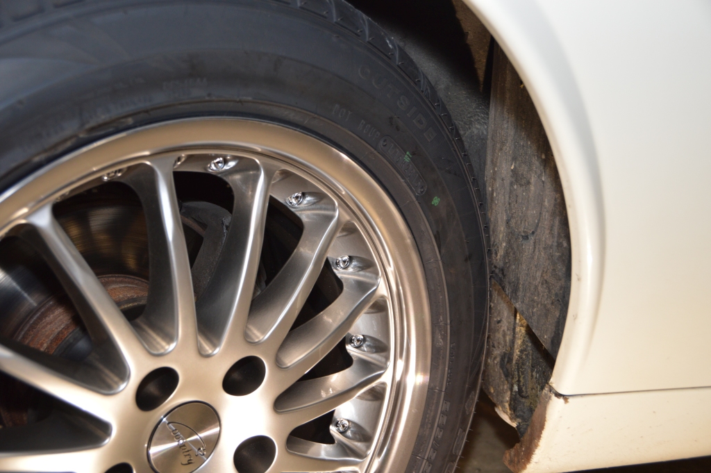

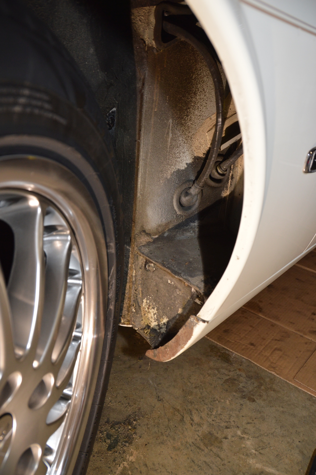

However, there is some rubbing on a *full lock* steering wheel turn on the front tires, back of the wheel well. I have some 10mm spacers to try if I can't figure out another solution (hammer). I'm glad I didn't try 235 or 245 tires.
I am very very pleased with the new looks and how it rides.

After being so used to 15 inch wheels, those look almost Photoshopped. Surprised 225 mm rubs - that's pretty standard (and width remains constant over wheel sizes) and if the overall diameter is the same... Why the rub? Aye, that's the rub....
I guess it is the wider rim (8J) compared to the original 6.5J, making the tire bulging a bit more on the rim lip, perhaps ....

Pulling it out at the inner edge, you mean? Could be. The photos look fairly flat, mind.

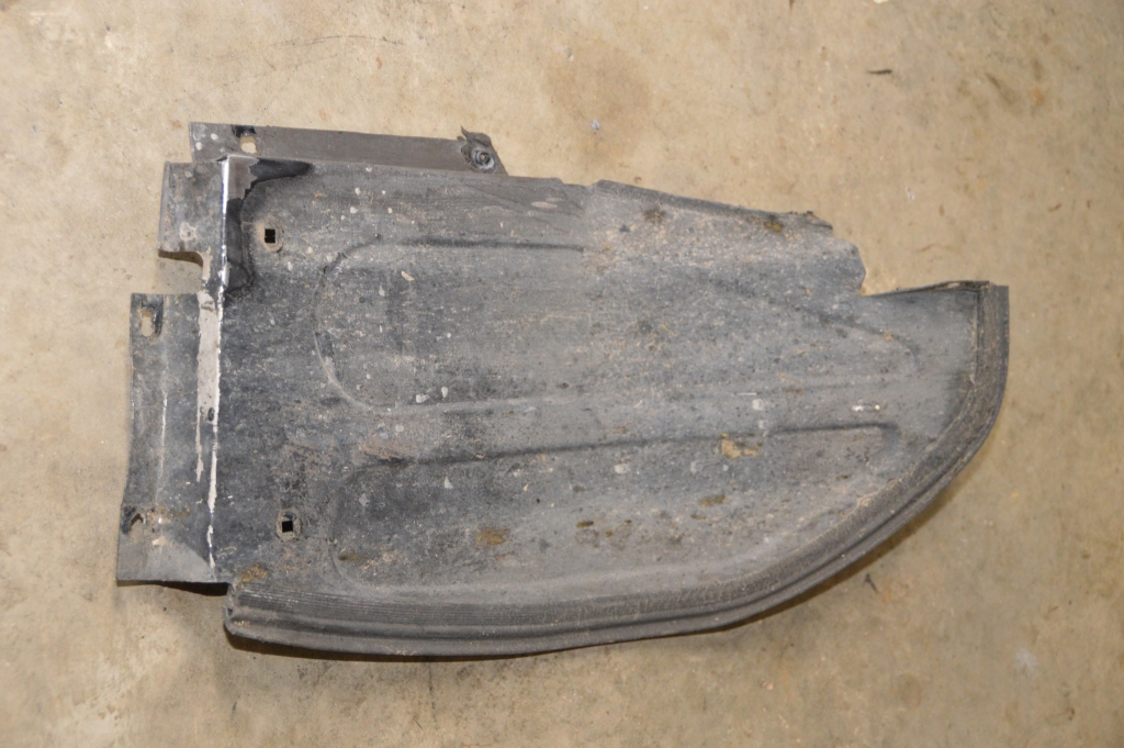

Here's the culprit, the "protrusion" on the rear outboard side of the driver's (LH) side wheel well. Just need to figure out what it is and whether it can be "adjusted".

I have an idea. My car is an XJwuzza 6. But, Jaguar's resemble each other a lot under the skin. The panel, just aft of that front wheel can be removed. It seems to have been intended to keep road debris from accumulating in the lower wing edge. It soes exactly the opposite. Removal to excavate is recommended for folks like me that own the sedans.
Same for the XJS, can't say for sure, but, I think so.
Therefore, remove it entirely or remove it, clean the cavity and reshape it before reinstalling it.

Merry Christmas to you, Carl! You were, of course, correct.
Pulled it out, no rubbing, and no protection, but I'm sure I can get creative.
