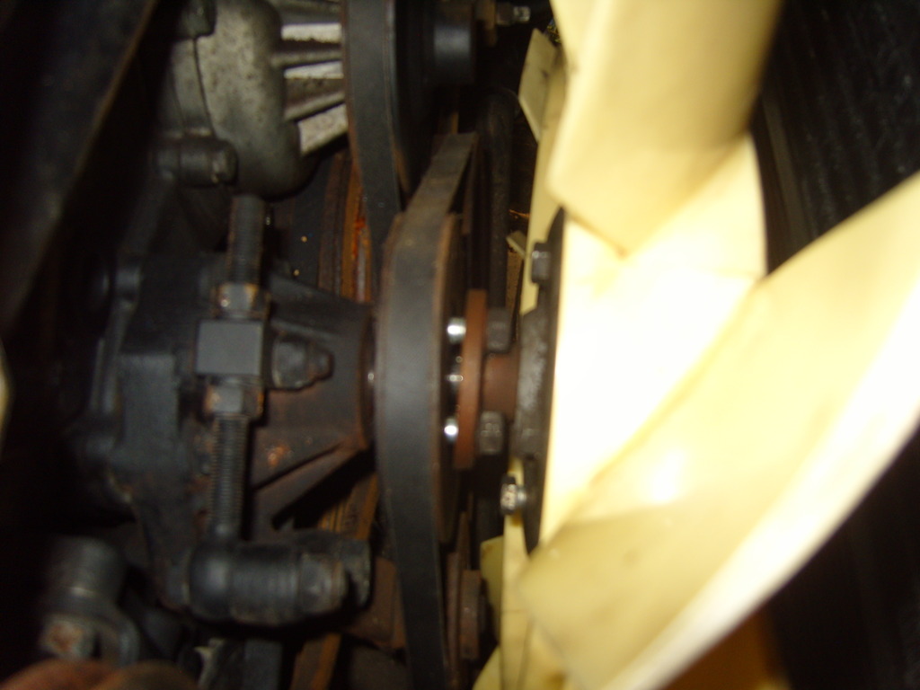

Although I was tempted to leave the old fan, I felt I had to take it off to have a proper look at its condition.
As in the event that it shattered, then it could take out not only the Rad but put a big dent in the Bonnet/hood.
How hard can it be?
The truth is a whole lot easier, than I could have ever imagined, its only held on by 4 bolts, where the only mistake that I made was undoing the wrong ones!
I should have undone the bolts that were close to the pulley but mistakenly thought that the Yellow blade bolts would have to be undone first.
I also thought the Fan housing would be on a shaft and need some sort of puller to be able to get it off, or may even need to be drifted with a FBH.
But not so! its only 4 Bolts.
The Technique I used@Grant@Greg, was first to back the nuts off as far as I could and while I managed to get 3 of them, I couldn't get to the fourth one, which was underneath and out of reach of a spanner.
As I had the Car on my lifter, I also tried to get it from underneath.
'Nice Try but No Cigar' I couldn't reach it.
Plan 'B' was to slack the Pulley Belt off, so I could turn the Fan Blade Boss, to a much better position, but as the adjusters were very tight and also very little room for me to try and undo them.
I ended up giving the Engine a Spin on the Key, as with so many wires disconnected, I knew She wouldn't Start.
DO NOT UNDER ANY CIRCUMSTANCES TRY THIS ON AN ENGINE THAT WILL START, OR THE LOOSE FAN WILL WRECK THE RADIATOR AND DO SOME SERIOUS DAMAGE TO EVERYTHING UNDER THE BONNET/HOOD
Once I got to the last nut and backed it off just like the rest, all it then took was a tap with my hands at the top and the bottom, then it virtually fell off and eventually did just that once the nuts had been fully undone.
Put a big sheet of rag underneath the Car, to catch any nut that may fall.

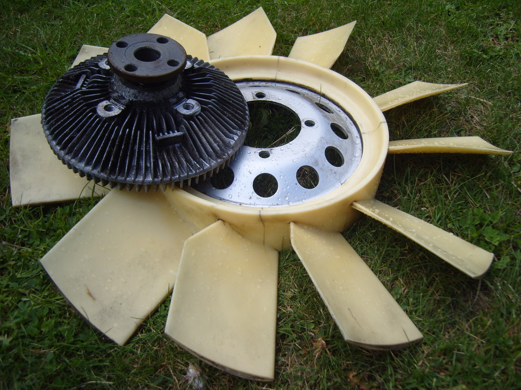

As you will see from the Photos, the Fan was much worse than I thought, as there were Stress Cracks all over the place and it was very clearly just about to shatter.
The Clutch itself felt very OK, and so I will use that again.
And this is also a really good time to slacken off and Copper Grease all the Adjusters, in case you need to change any belts in the future.
If you still have the Rad in, protect it with a nice big sheet of Cardboard@PTJS.
Backing Off the Nuts

Stress Cracks all over the Fan
