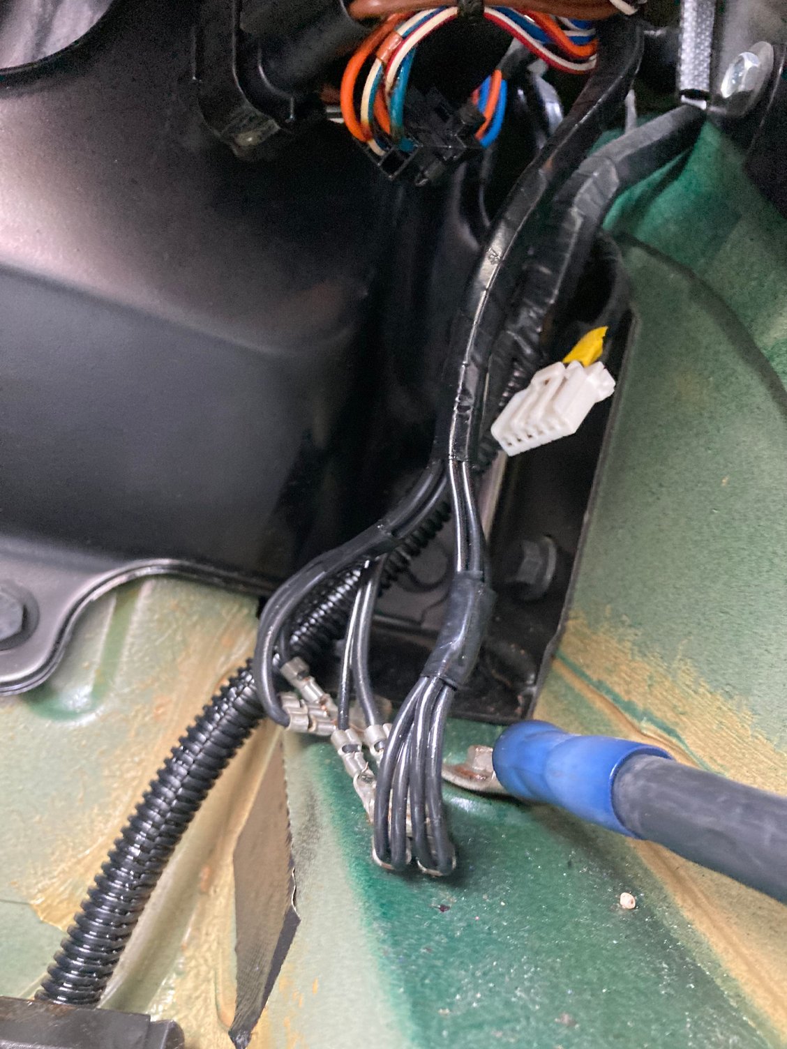

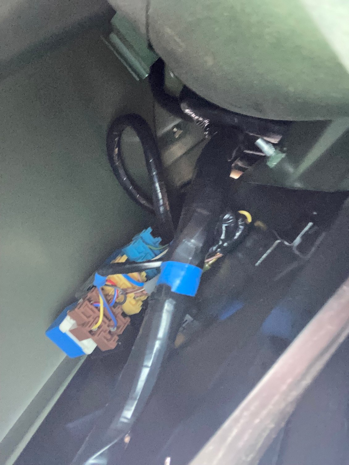

So in mu search for the fuel pump relay i came across this white plug not hooked to anything. Its located on the right rearinside fender next to the battery. Does anyone know what it belongs too? Also i found the relays up under the right rearwheel well but the looked positioned as to not allow clearence to remove. Can that whole cluster be positioned downward to ease servicing? See pictures. Thank you,Jeff

That looks like the plug for the second fuel pump...which you don't have. Jaguar used the same wiring harness for the v12 and the i6.
Is this tucked in near the battery?

On my 94 that plug was for hooking up trailer lights.
I also wanted to move that group of relays to the other side of the support.
Never got around to it, but the relays should pull out of their sockets.

Do yourself a big favor and remove and clean those grounds in the second picture. This is unrelated to your actual problem though.

The middle one of those 3 Relays (The Silver One) is the Fuel Pump Relay and there is enough room to unplug but don't do that unless you have another one to replace it with
