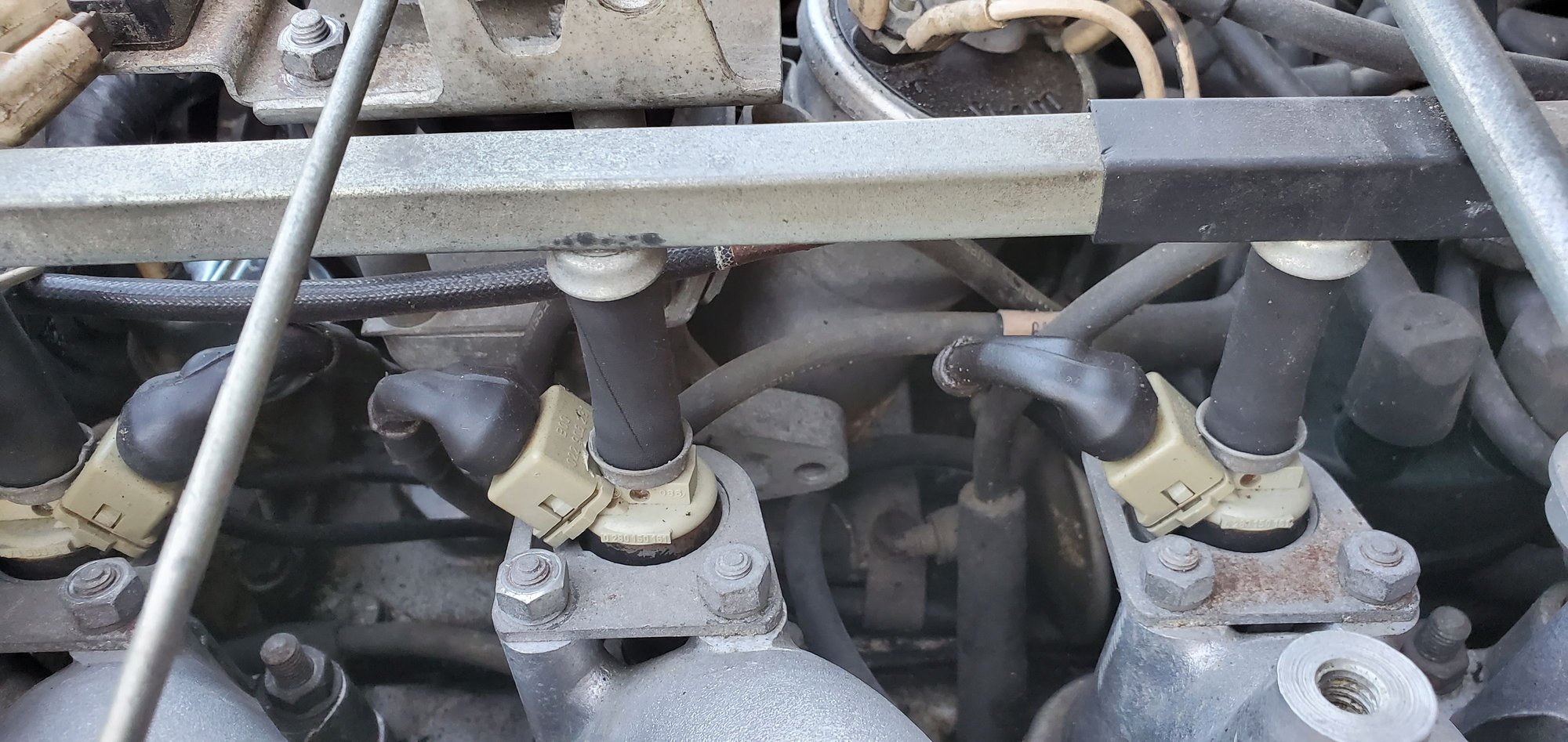

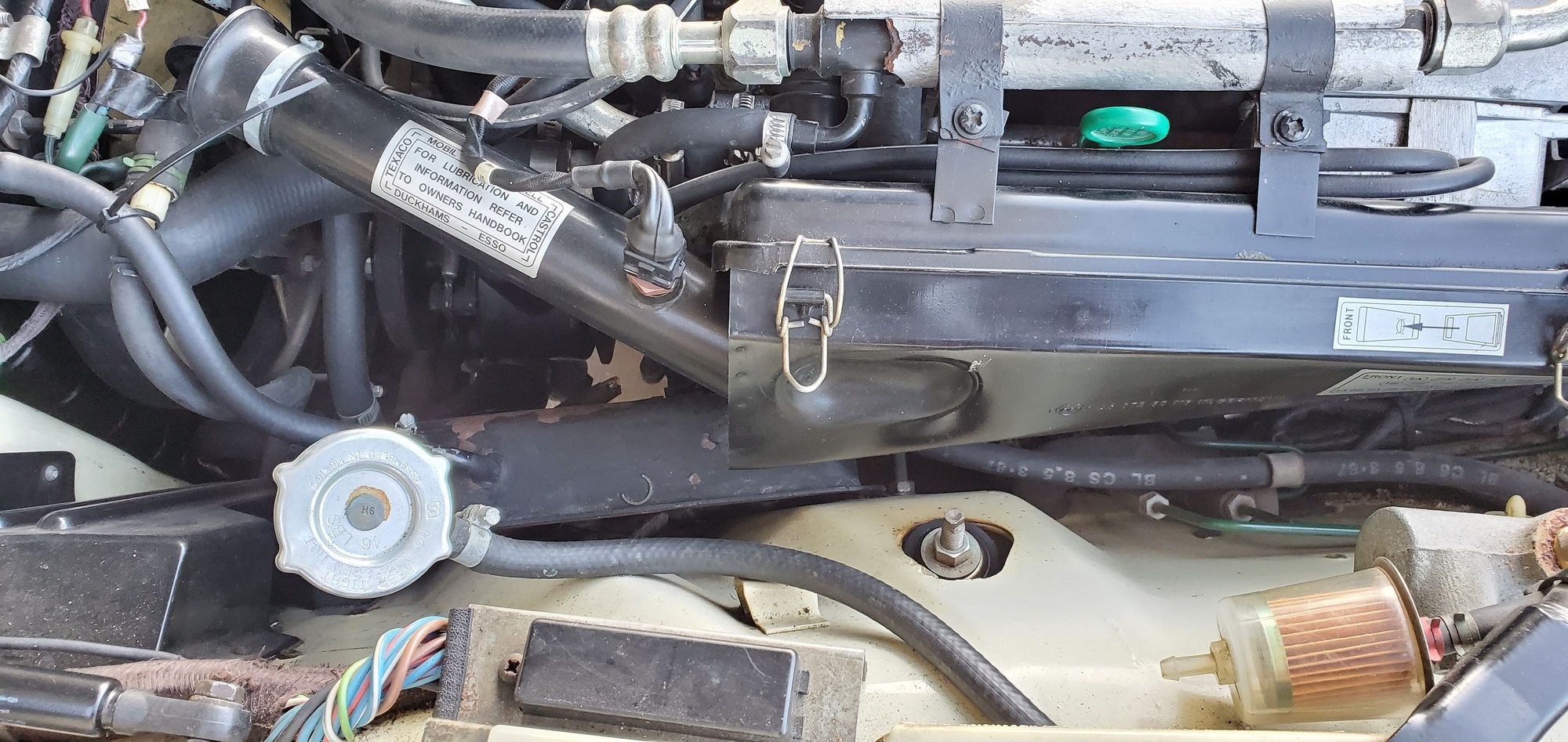

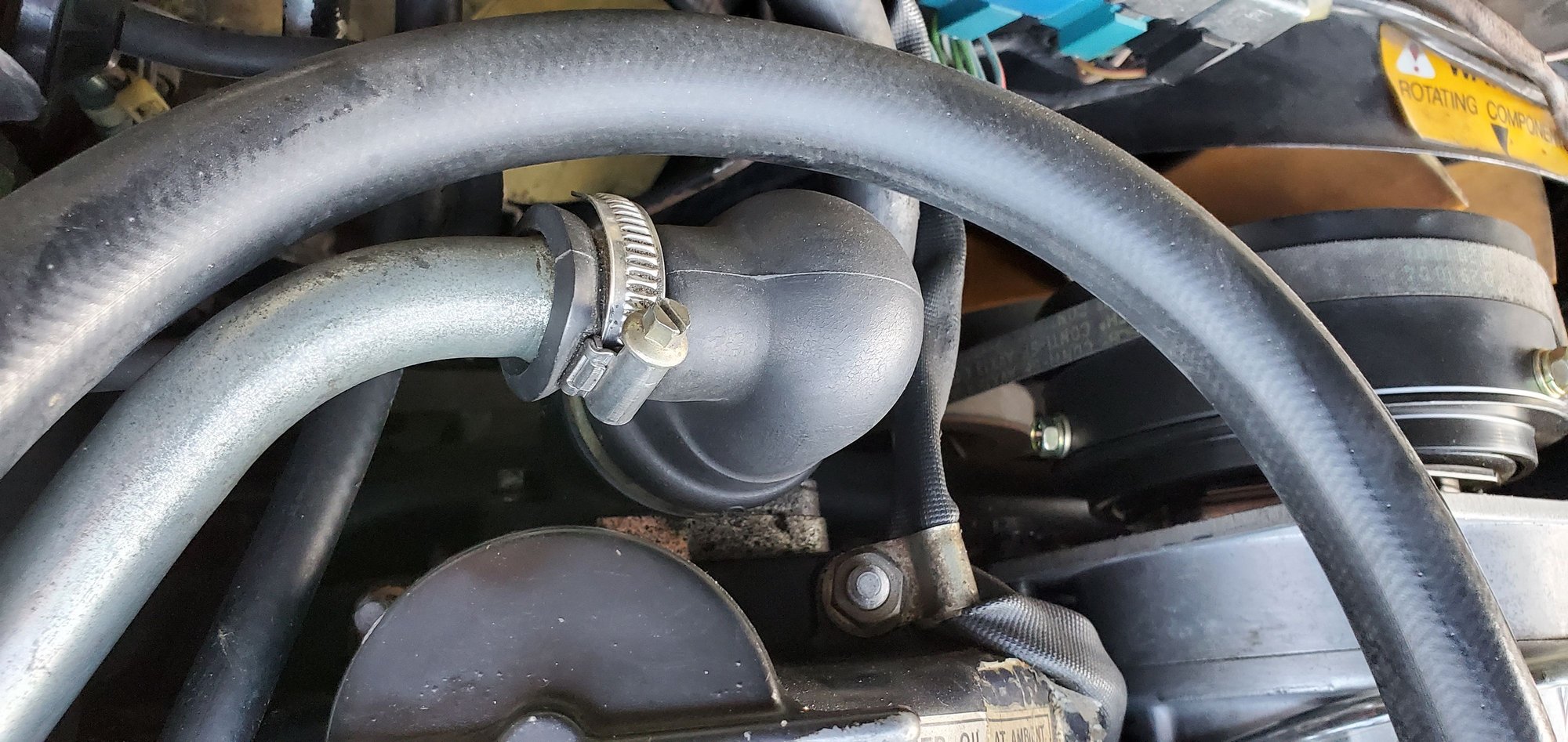

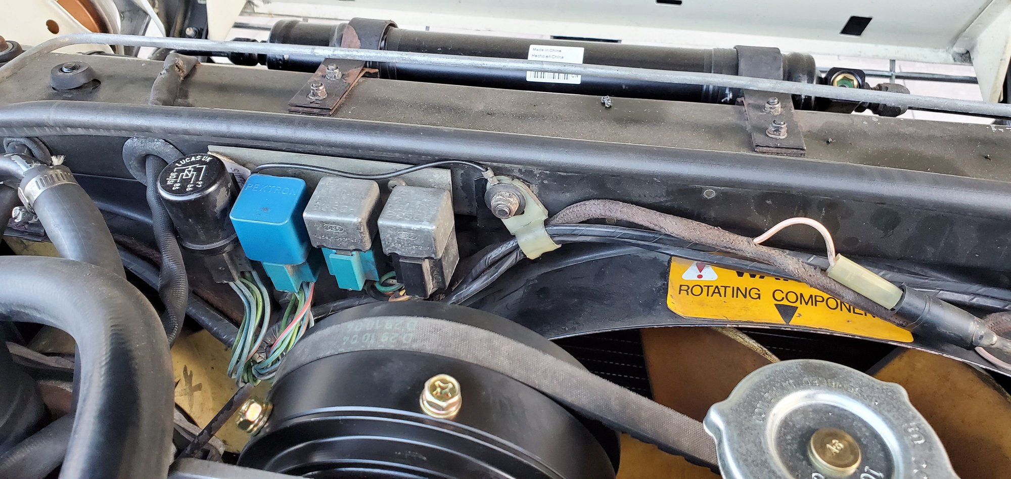

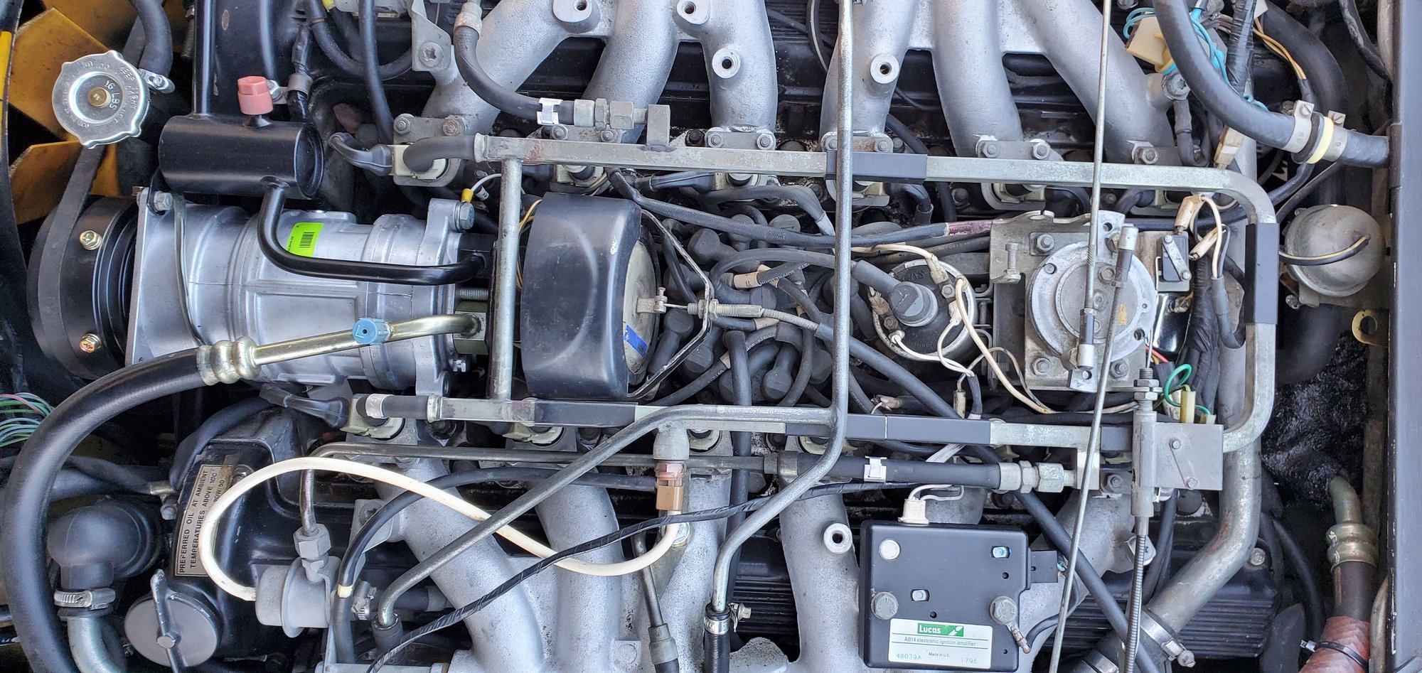

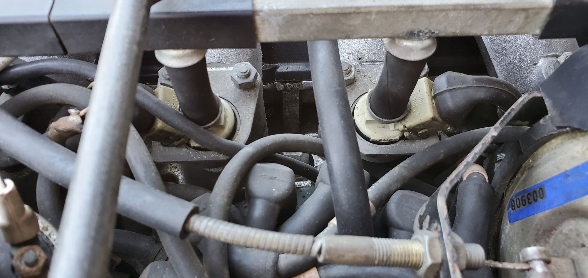

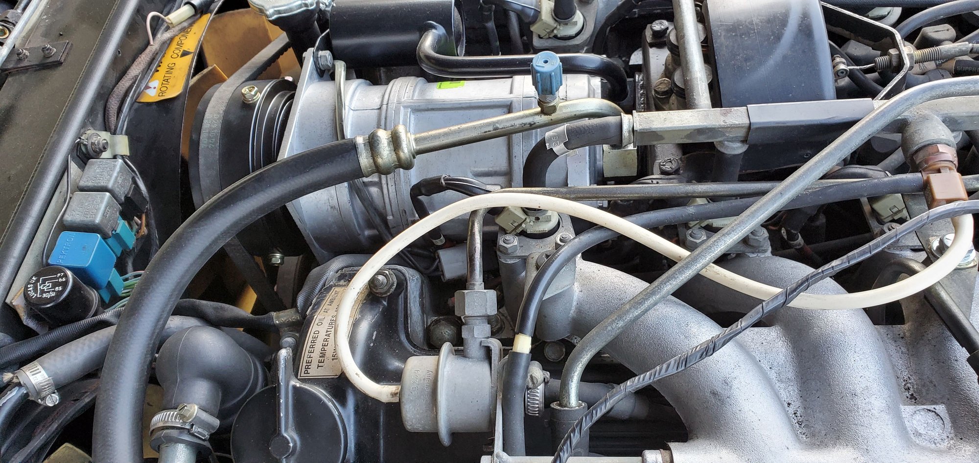

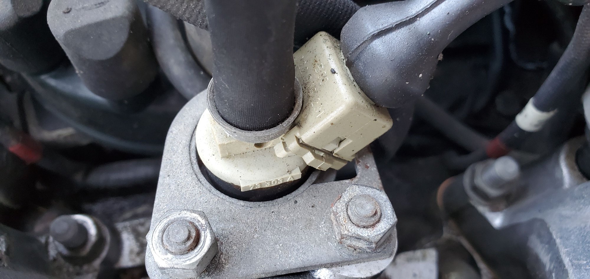

OK I have some pictures!! To be clear, my grandfather took extremely good care of the car for 30 years.

Looks like a nice, well kept Jag.
A couple quick remarks:
- Those fuel hoses look original. replacing them should be put high on your list
- The cover over the cruise control bellows is upside down. It goes underneath the bellows :-)

Agree with Doug.
I am not doubting the care that been given that car.
AGE is against any Non-metalic item under that bonnet, and that is just plain fact.
With those OE fuel hoses, I would not be starting it at all, I have been nearby a couple of fuel hose related engine fires, NOT funny at all, and they erupt in less than a heartbeat.
I understand. also, that I am a tad pushy, its the Aussie, but really, things need to be attended to, and that car will see you out, and make an awesome daily driver, if thats what you want.
The XJS is rising on the "must have" list, and good examples, like yours, are way at the top. Down here that would fetch serious $$.
