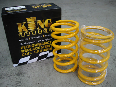

King is a spring manufacturer in Australia. They are one of the very few companies that make off-the-shelf performance springs for the SI-SIII XJ6 and XJS. If you're in the US, you will either pay shipping from Australia (very expensive) or order from their US distributor and possibly wait 4-6 months for them to arrive by boat.
I have a set of the lowering King springs on the rear of my XJ6 with a set of KYB shocks. The setup is a little stiffer than stock but not as stiff as I would like - not sure if that's a result or the springs, the shocks, or both. I was only able to install one of the front lower springs before my car went into storage - I don't think it lowered the front of the car. Maybe it needs a little time to settle.

Thanks, for the King Spring education... The KYB shocks are the ones I have decided to use on my XJS. Did the front springs maintain the same height as stock? I want to raise mine up about an inch or so. My spoiler is taking a beating on some of our speed bumps. I will find the King distributor in the US or go direct if I don't find an equivalant spring source.

Only the first few years of DB7 springs work, and I believe lower the car about 3/4". You can also lower the car a bit by removing most or all of the spacers above/below the front springs. Also, you can place spacers under the spring pan, between it and the lower wishbone, to lower the front. According to Jaguar Monthly, these spacers result in lowering twice the thickness of the spacer.

I had a nightmare trying to a lower a car once where the springs didn't lower it at all so I used the lowest springs King Springs sells that fit an XJS in the front. If they make it too low, I'll just add a couple of the shims back in.

Although I only have one of the two front King springs installed, I think my front end is going to be a little high. I have a supercharger assembly that should add about 120 lbs to the front of the car. If it's still too high after that, I am going to make lower spring perch spacers.
