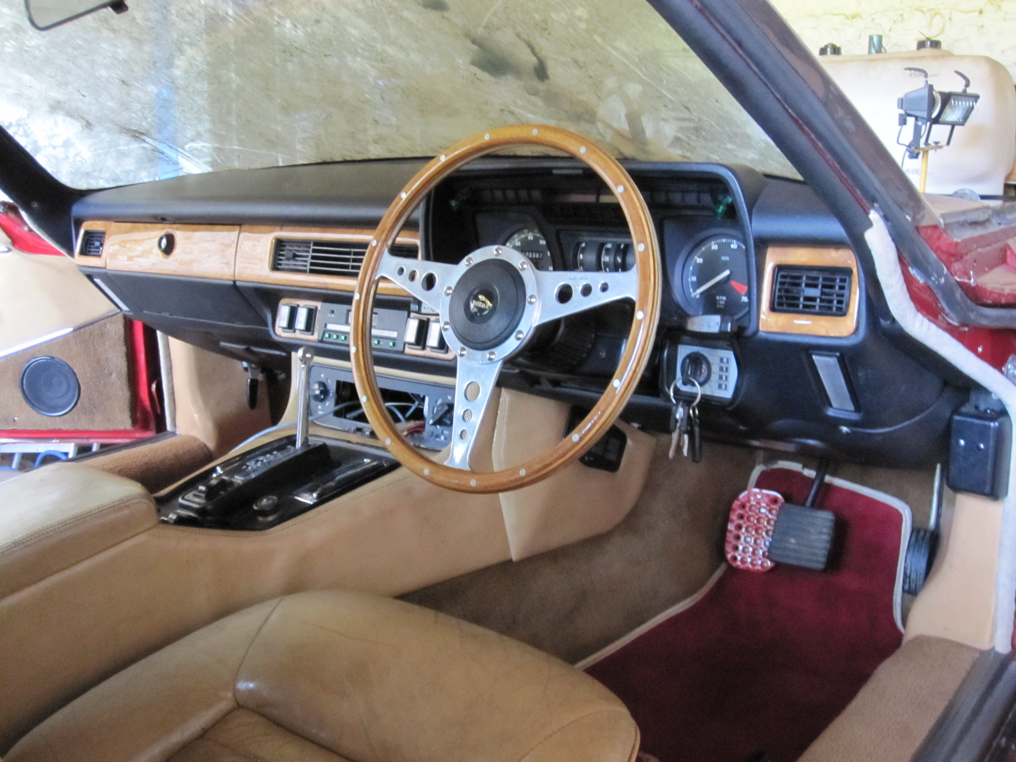

Great idea to fit one. The XJS really needs it, and when I fitted mine (albeit RHD in my case) it made the car far more comfortable to drive. You may well find, as I did, that you need to cut an inch or two off the left side of the brake pedal to give you decent room for your left foot to rest comfortably on the footrest though.
