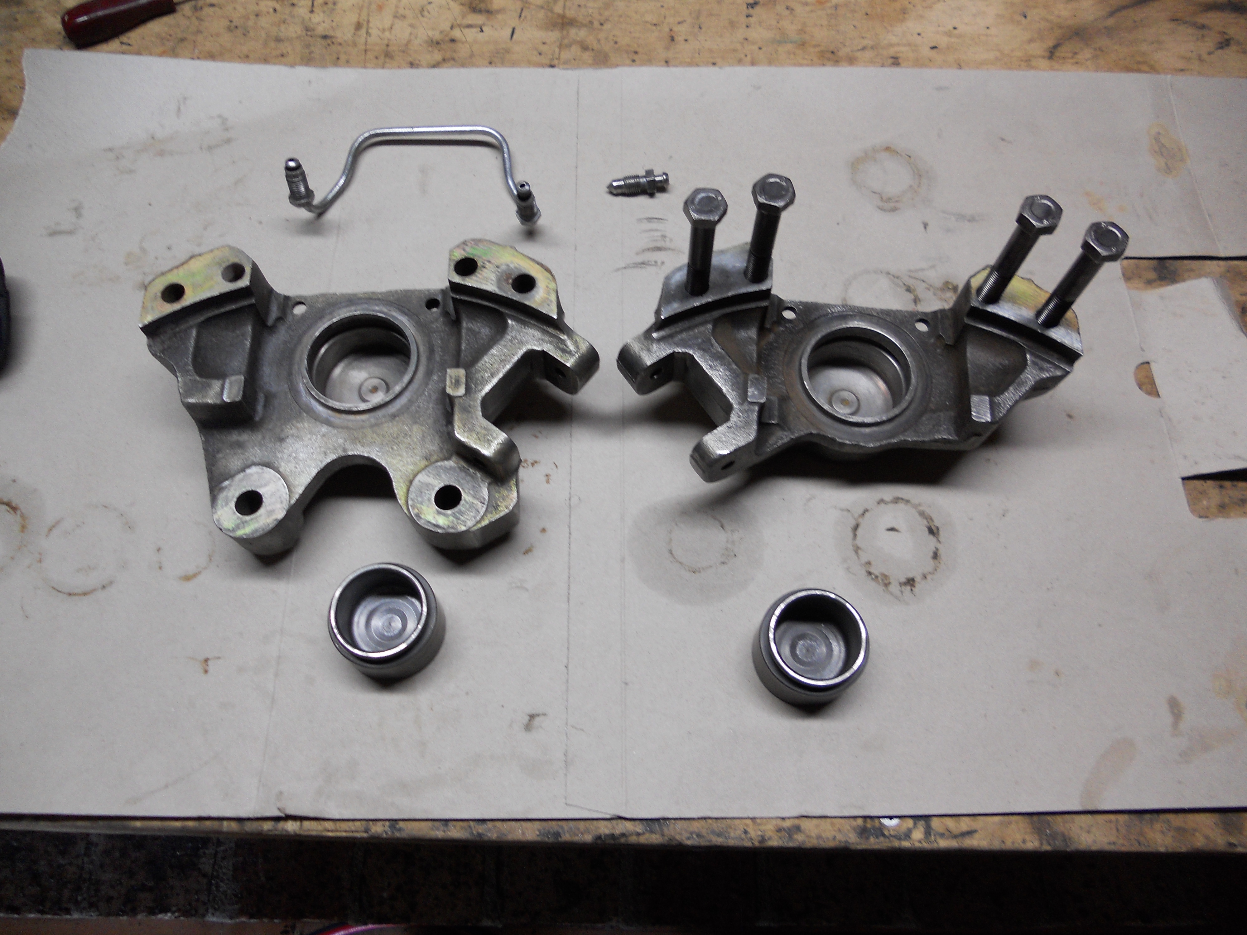

The calipers are not too difficult.
They unbolt, just make note of where the Xover pipe goes.
Before you tear them apart use compressed air in the fluid inlet to blow the pistons out. I didn't and it was a little harder.
Once the pistons are out use a spike to remove the seal and discard.
Clean the calipers fully with brake cleaning fluid. I painted mine with silver caliper paint.
When re-assembling use copper grease on the piston seals.
First pic is my front calipers. I could not find the finished pic of the fronts but the second is the rears.
Attached Thumbnails In denial about the need for New Callipers-dscn0423.jpg   In denial about the need for New Callipers-dscn0371.jpg

No external crossover on fronts but make sure you get the correct seal for the internal channel for reassembly.
Hi Warrjon
I didn't want to split them, as I've been told that's not a good idea but If I can get the Pistons out and find they are not pitted, then maybe a good clean and new seal kit would do it.
Old Sep 23, 2016 | 11:34 PM
Baxtor, Warrjon
I have never been able to find a source for the seal between the two caliper halves. Where did you get yours from, please?
Greg
Old Sep 24, 2016 | 03:22 AM
warrjon's Avatar
Posts: 4,638
Likes: 2,583
From: Vic Australia
If memory serves me correctly I used an O ring bought from my local Auto parts store. It was a few years ago now.
