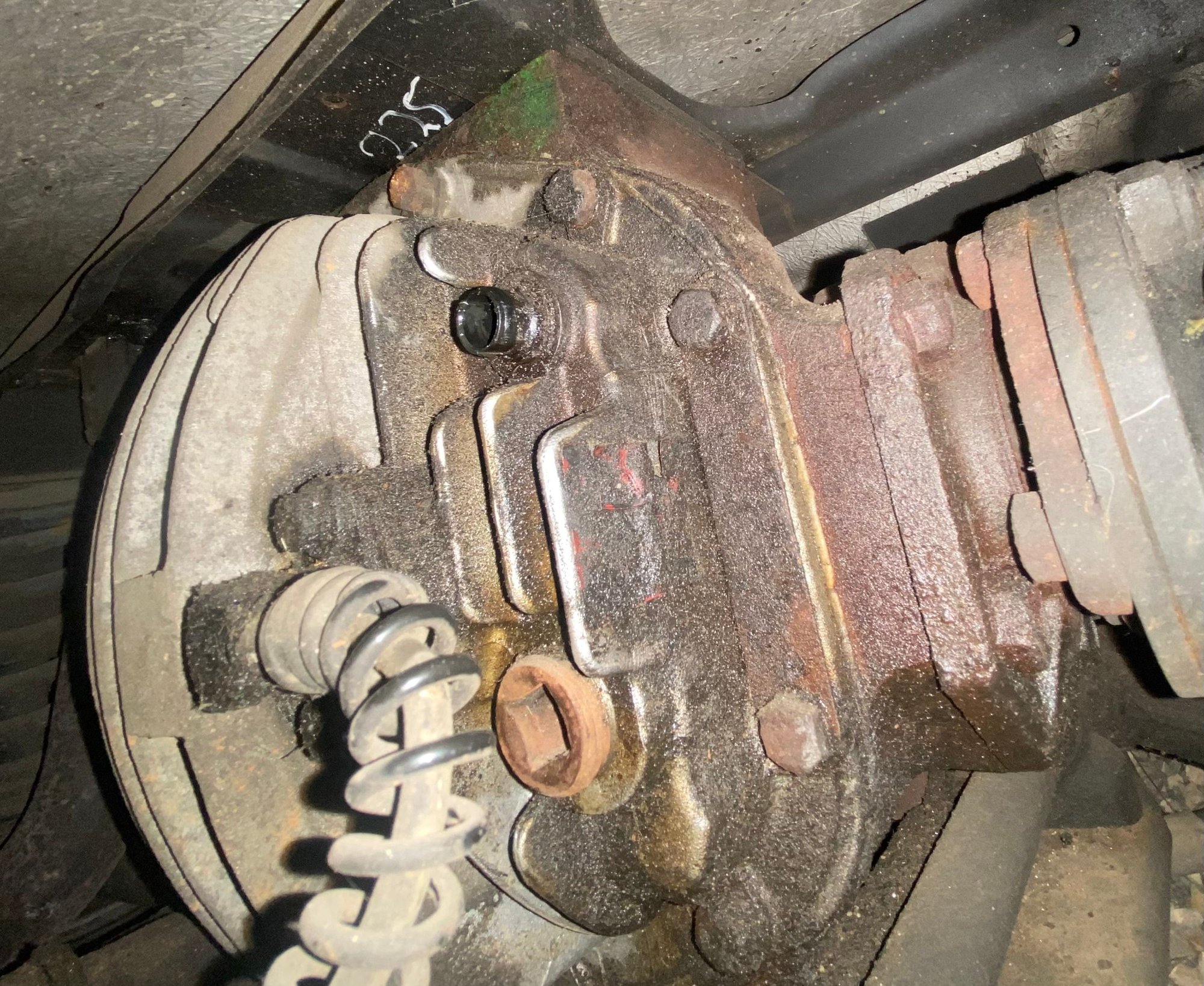

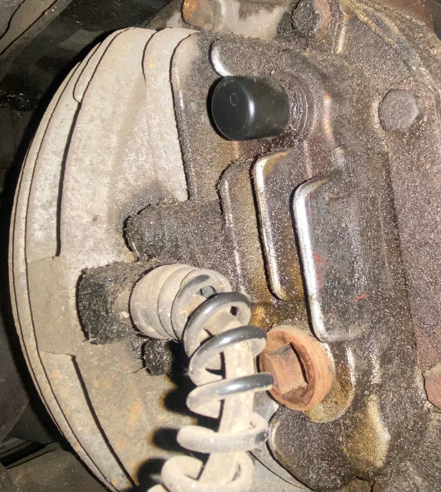

Good evening everybody,

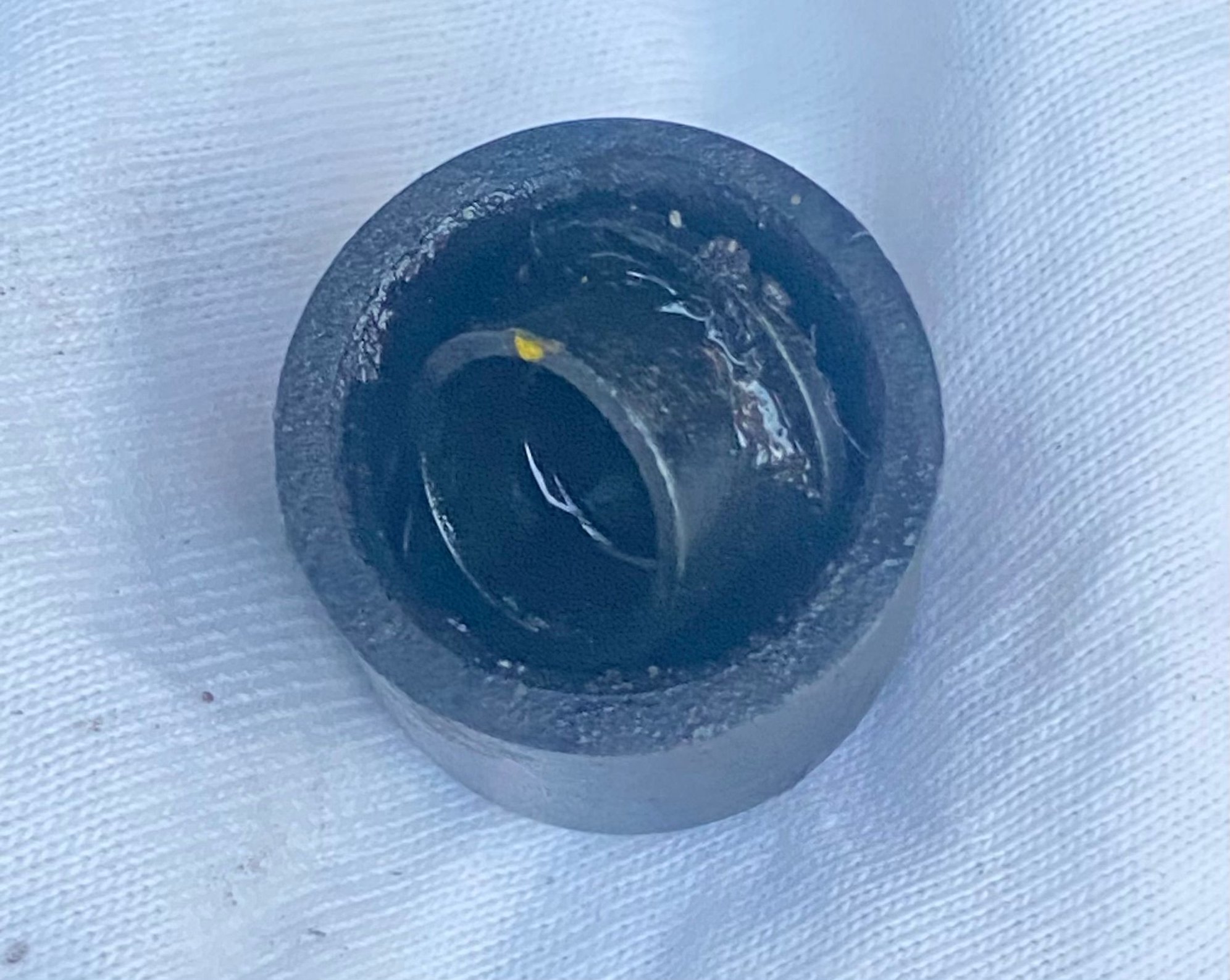

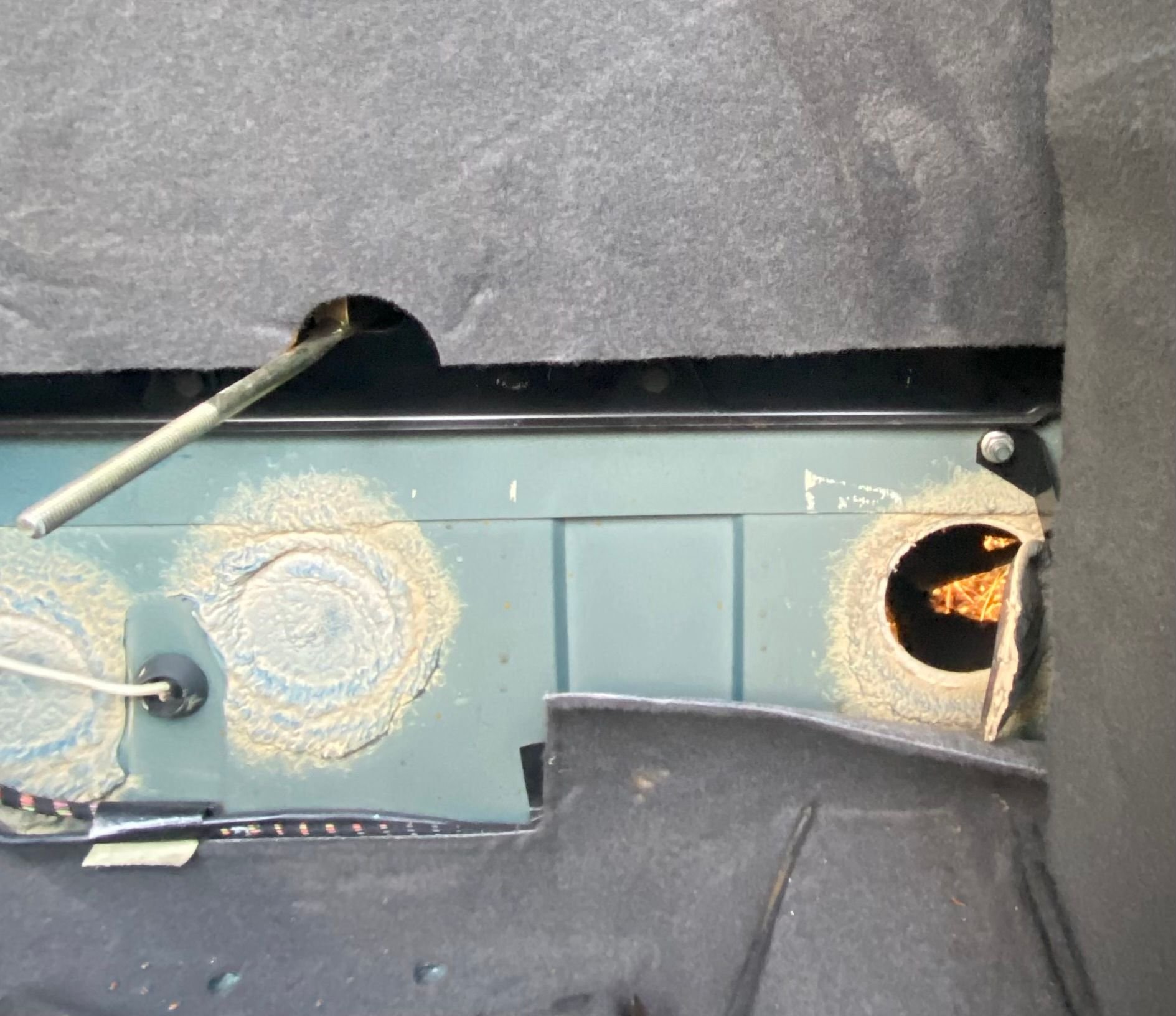

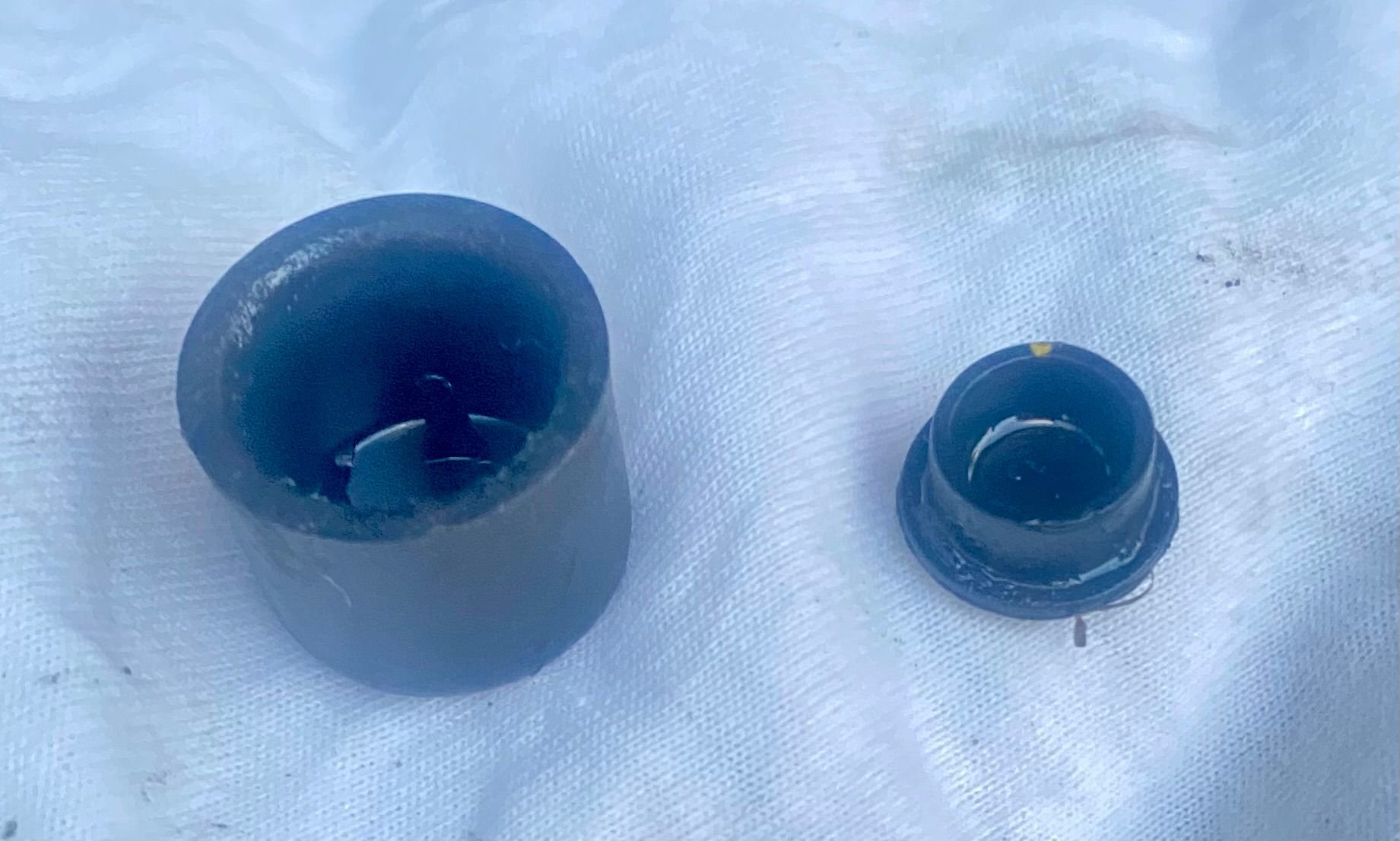

I'm on a holiday with my 95 XJS 4.0, and it seems that it's short of differential oil (strange sounds and vibrations when taking slowly narrow curves). I've read in other threads on this that there is supposed to be a 1/2 inch square male screw closing the filling hole. However, when I opened the access hole in the trunk (great invention!), I found that there is a black plastic cap, and when you manage to take it off, a small plastic plug comes out together with the cap.
I was able to poke a small screwdriver farely deep into the opening, so my question is: Is it possible that the filling hole is only closed with a plastic cap that you can get off quiet simply with your hands? Or is this an opening for some special Jaguar filling tool?
I've attached some photos that show the "discovery" process.
Thanks & best regards
Martin

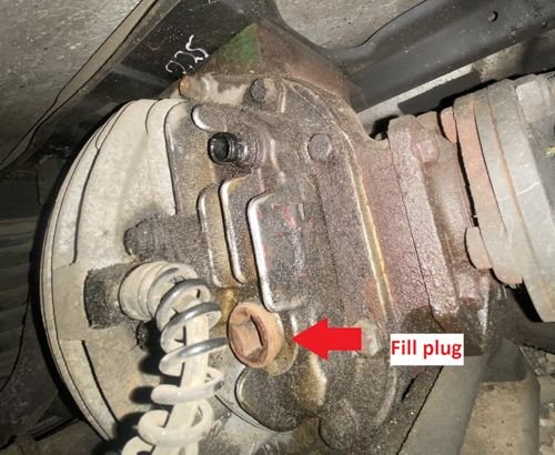

THat is the breather you have levered the cap from. The fill and level plug is the threaded plug with the square centre just to the right of the wire-spiraled thingy.

Thanks Greg, I see. Is this the differential without drain plug then? Or do I have to look for it below (not in the photos)?

The drain plug is on the bottom. Remember not to undo it until you're sure that you can undo the fill plug

Here is the filler - fill with oil to the bottom of the hole until it starts to run out, the put in the plug. I can't remember if the recess is 3/8" or 1/2" drive, but it's a standard ratchet/socket set drive. Make sure you can loosen this before removing the drain plug on the bottom!

Thanks for reminding. Actually, first I wasn‘t able to get the filler screw out, inspite of having managed to get the ratchet wrench (its 1/2“) into the plug, through the inspection hole in the trunk. The problem was that I wasn‘t able to apply much power, due to the narrow inspection hole and the limited angle of action.
I then used a second jack (fortunately I had one of those which have a simple vertical tube that is winding up, from my old Land Cruiser), and put it below the car, just at the end of the wrench handle Winding it up, I managed to open the plug.

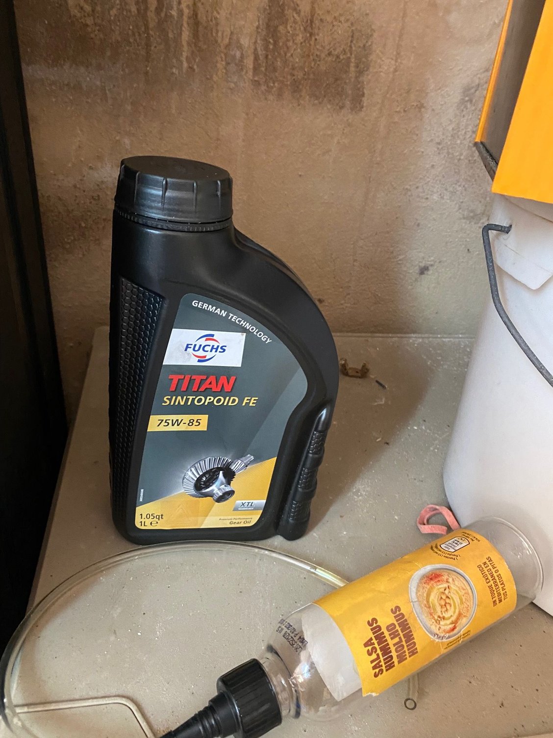

Next problem: not one drop of the needed oil (LS!) available on the entire balearic archipelago. They told me that the could get me some „within a couple of weeks“.
As I am driving back to Germany within a couple of days (1200 kms), I bought a litre of what seemed to be the closest choice: Fuchs Titan Sintopoid FE 75W-85 (API-GL5, but not LS). Some 250 ml went into the differential before the oil started dripping out, and I hope that mixing in the Titan oil won‘t cause problems - what do you think?

That oil should be fine.

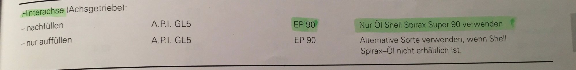

This is what my original manual says (the car was originally sold in Germany):
it seems that Shell recommends the use of Spirax A90LS when no Spirax 90 is available (see https://www.jaguar-forum.de/forum/vi...9d5c8d98c190e4 - in German).
I‘m not sure whether the original Spirax Super 90 is of LS type?

As you probably know, JB, not all Jaguars had LSDs fitted. But for sure, the addition of a little ordinary stuff will make no difference to the OP's unit.
I should have mentioned that was the recommendation for the LSD type. It was basically the English version of the photos of the manual that was posted.
