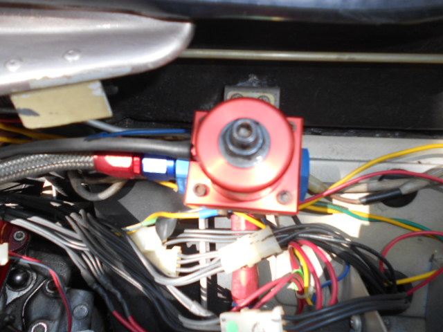

for myself,i did not like the way jag designed the fuel rails and two regulators.
pix shows a much simpler system, custom rail aluminum and adjustable regulator, i use custom larger injectors, but can control pressure for fine tuning.
it works the best with an aftermarket ECU.
at idle vac hose on vs off changes F/pressure about 5-10psi. i use an A/F ratio gage for tuning, along with seat of pants driveability.
