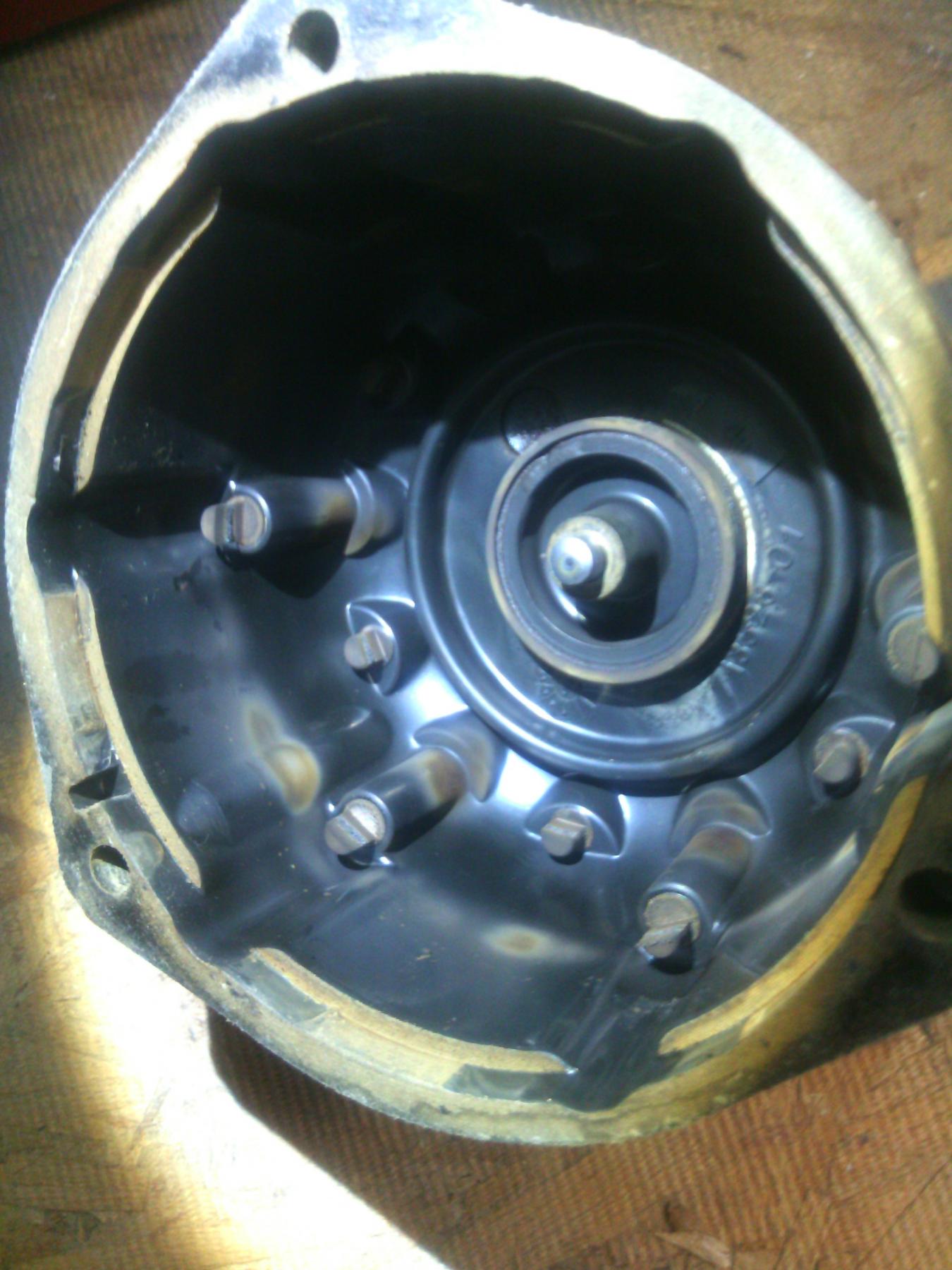

Hello everyone, moving slowly on my cam cover gaskets and half moon replacements. Took plug wires and dist cap tonight and found this inside the cap.(see pic )Is this normal for these cars ? Was going to replace cap,rotor, plugs and wires. I know very little about cap, rotor. The other question I have is about the plugs. I'm assuming they are original ones from the factory. I have been spraying them with liquid wrench, nut buster and letting them soak for awhile. they still won't break loose, any suggestion? Afraid of breaking one off or threads coming out with it. The car has 58,000 on it

I cannot help with the cap, which is a Marelli one.
As to the plugs: they will be stiff. I suggest you get a single hex plug spanner, a decent straight extension and ensure you are straight onto the plug - no universal joints. You may have to remove lots of bits to do this. Then with a longish ratchet or bar on the extension, undo. There will be a sharp click as the plugs let go, but unless you are very unlucky all should be OK. A warm not hot engine may help.

I would just simply replace the distributor cap and rotor button while you have gone this far. For the plugs I used a proper 16mm plug socket with the rubber insert, very important that the insert be there as not to brake plugs, I found out the hard way of course. Use a plug socket with a 19mm hex head, I simply just placed the socket over the plug then used a 19mm spanner open ended to turn the socket, works a charm. Be careful when removing plug 6A if you loose the socket it rolls down the top of the gearbox and gets stuck in there, lots of cussing to be had, took me a day to find and retrieve it!!!!!

The Marelli caps is very expensive and the non OEM are not worth buying. Do not get one with the aluminium tips are it will fail very quick. Try cleaning the contact points with a light sand paper. Pay close attention to the center plug and spring, this is a know failure point. Good luck!
