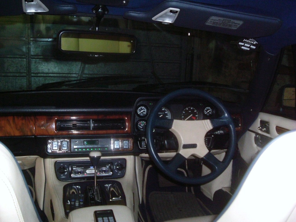

there ok and will do what you want,i bought a new one from jaguars a few years ago, i ran the wires down the a post as it needs two feeds 1 from the lights and one from ign on side, you can just see it in the picture
good luck

Thanks so much everyone for the links and pictures. It's exactly what I needed to make a decision. It looks fairly easy and not too intrusive. It looks great too.
I may or may not end up getting the one with the back up camera. On one hand I might as well since I am doing this, on the other I really see no "need" . Ill post pics when I am done
