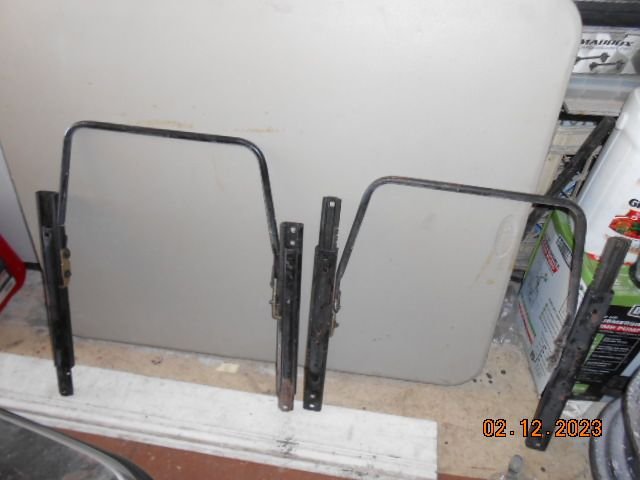

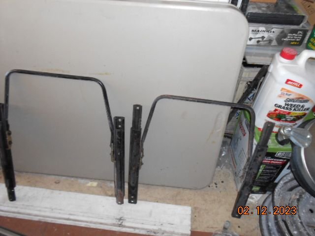

You don't say where you are located. I am in Florida, USA. I have a pair of front seat rails. PM me if you are interested.
I can post pics here if you want to see what they look like. These came out of a 1985 XJS.

Here are some pics of the XJS seat rails
85 XJS Left and Right seat rails
