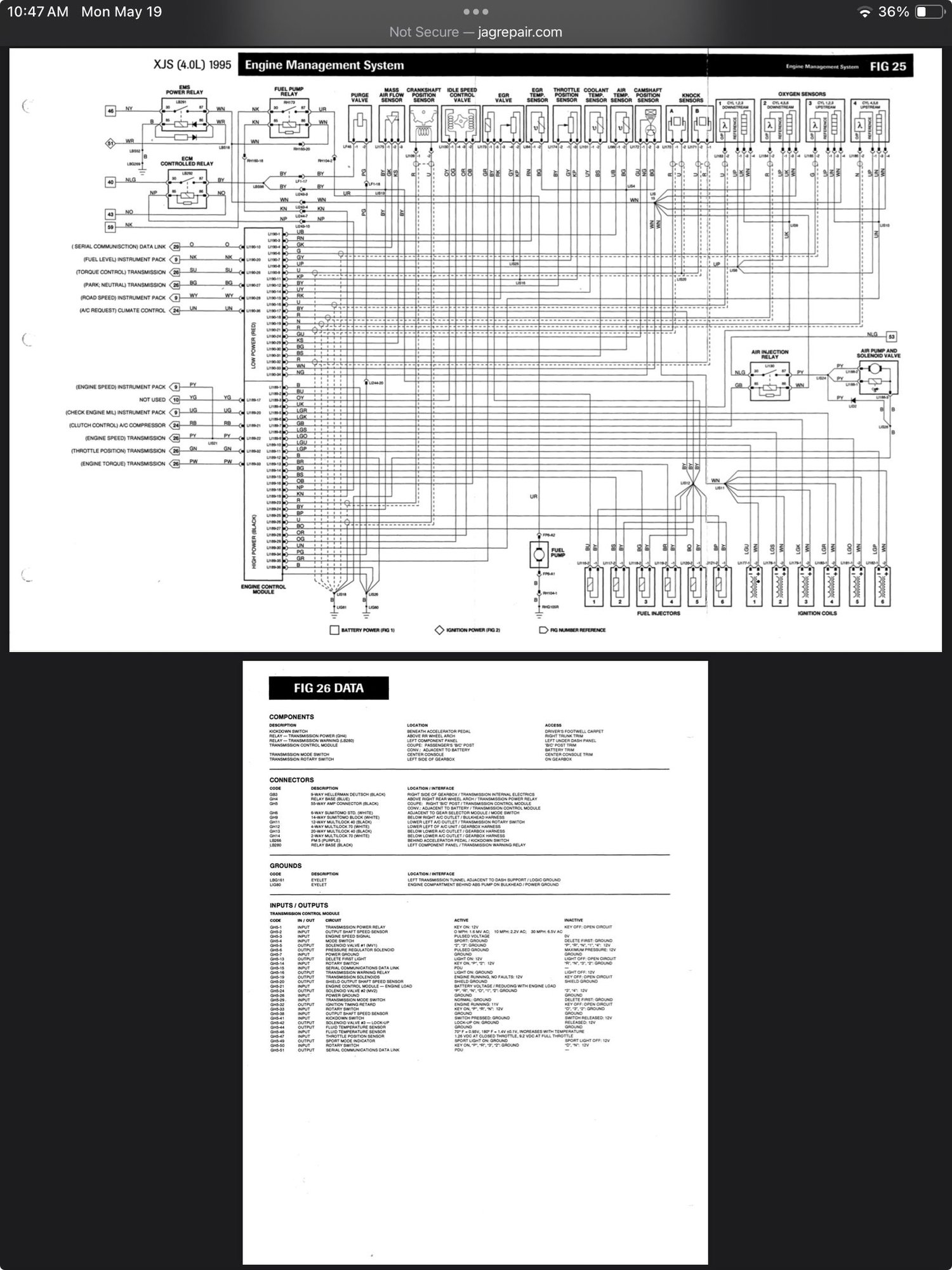

You will need a wiring diagram for the 4.0 injection; I don’t have one, but if someone posts it, I will try to guide you.

I can find that

Is this what you need.
