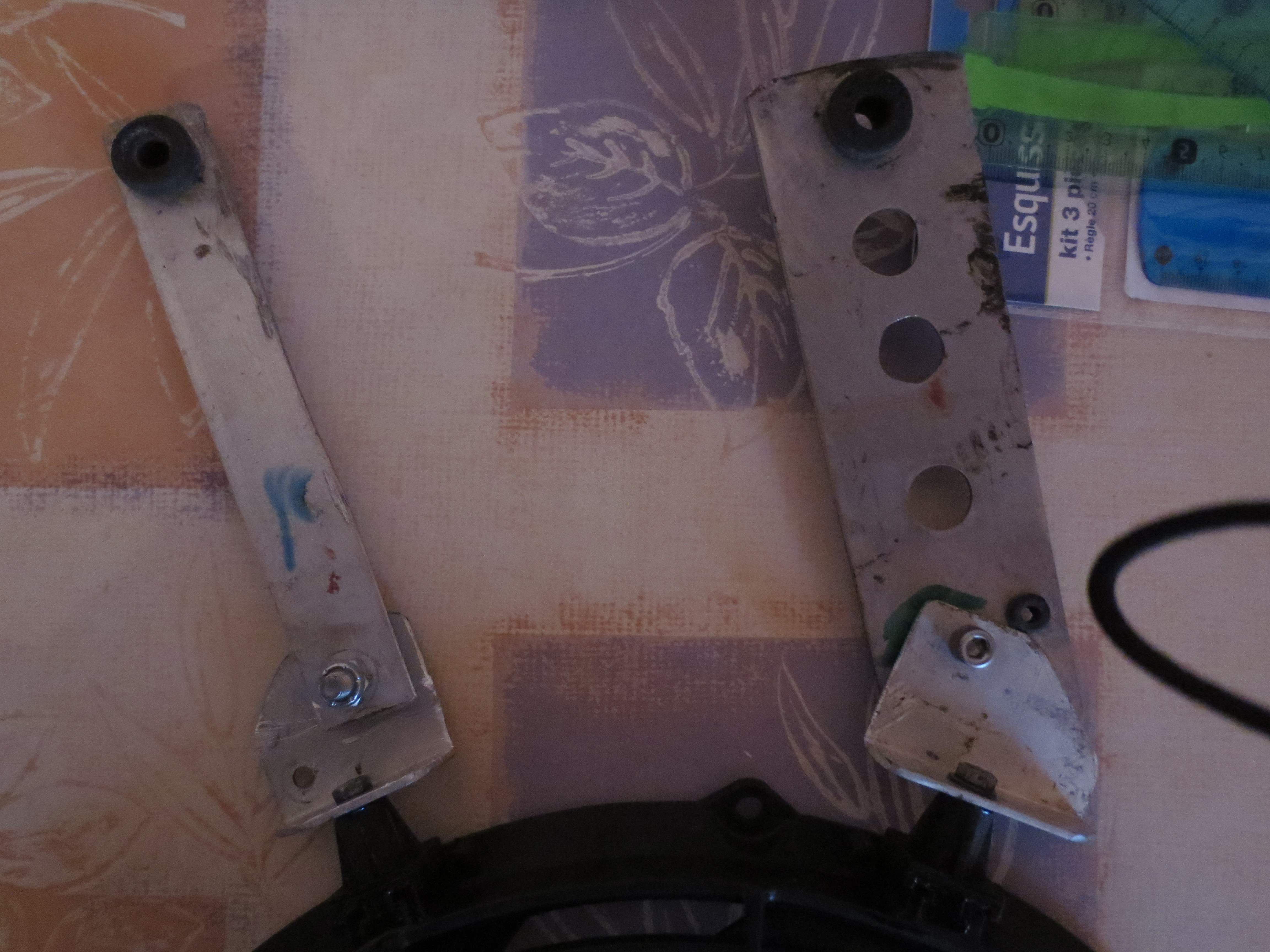

I happened to have in the GiF parts hoard two SPAL fans, brand new, bought in a previous incarnation before poverty struck, so out they came. One 12 inch and one about 16 in diameter. Naturally, the fittings were in different places and at different angles, so much fettling had to be done to get them to fit. My mounting system consists of the top of the fans being bolted to a 20mm square ally tube which is bolted up in rubber mountings to the rear flat part of the radtop panel. The bottom fixings connect to four welded studs on the crossmember below the rad, also in rubber cotton reel mountings.
All this fettling with endless in and outs to adjust, took about two days in the cold, but eventually in they went. One big advantage of the SPALs is that they are thinner front to back, so go in and out easier and also give extra welcome space in front of the engine. A good tip is to glue the fan-to-mounting plastic mortice joint pieces supplied with it, as otherwise the fan can work its way out of the plastic fixings.
The control system for the main fan is as recommended by Grant. The OEM temp switch in the water pump inlet switches a heavy duty relay to start the large fan, a second heavy duty relay (for extra reliability) is used to activate the main fan by the cabin switch. One GiF tweek is to replace the OEM thermostatic switch by one that comes on at 90 and off at 85 C, as I was experiencing too frequent ons and offs with the OEM temp switch.
Anyway, on the third day I started it up and NO vibrations, fans worked, and undetectable whether they are on or off from the cabin. Pics attached of the old fans and the new ones, installed in their chassis, including fine view of the GiF toes!.

The old fans were Pacets. The large one was 17 inches (called a ProFan, the biggest and most powerful they made at the time, and still available) and actually just a bit too big to go in that easily. So I bought the SPAL replacement a bit smaller, overall it is about 2 inches less in diameter. The large Pacet pumped a huge amount of air, but the central drive spindle was not that well attached to the blade, I actually had to thread the shaft and put a thin nut on it to prevent the blade coming off, as the circlip arrangement was not strong enough for the fan's power. It soaked up well over 20 amps. The large SPAL probably does not pump quite as much air, but it should pump plenty, come the summer traffic I will find out!
Noise-wise, the SPALs make a more high pitched motor whine, but both are inaudible from the inside of the car. The SPALs seem better constructed at the fan attachment.
