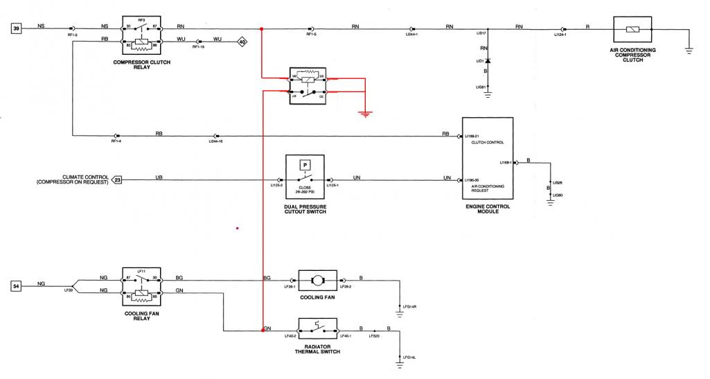

There is one easy modification you could make to the Aux Fan circuit that should serve you very well. I have made this change to several XJS models, because they have a propensity for the A/C to run warm in traffic. This causes the fan to run anytime the A/C is engaged, yet still allows the temp switch to control the fan if temperature dictates. Simply add a relay as in the illustration.
Cheers,
Attached Thumbnails Electric fan switch, or thermostatic control switch-96-aux-fan-mod.jpg

You, sir, are a wonderful, wonderful man!
That saves me from having to figure out how how to do it. That's precisely how I want it to operate. I was just thinking about looking at the harness a few hours ago, but laziness got the best of me.
I think I'll include a switch to turn the fan off on long highway drives if I'll be running the A/C most of the time.
The switch I've got now is annoying, but it works temporarily. Luckily, I was able to run the wires and mount the switch without butchering anything. Having the switch, however, gave me the idea of the fan cutoff for long drives.
I wouldn't normally be bothered about it, but I've just got to wonder how long this fan has been idle. If it's sat for long enough, it might not have much life left in it.
I'll soon find out, I suppose. This will likely be yet another part that's going to be aftermarket. It's not about the money, it's about standardization. I've learned that lesson with other British vehicles.

Awesome, Mike. This could be an option for some folks. I have added circuitry on several cars to make the aux. fan run anytime the compressor is on. This is something most owners can do themselves.
Cheers,
