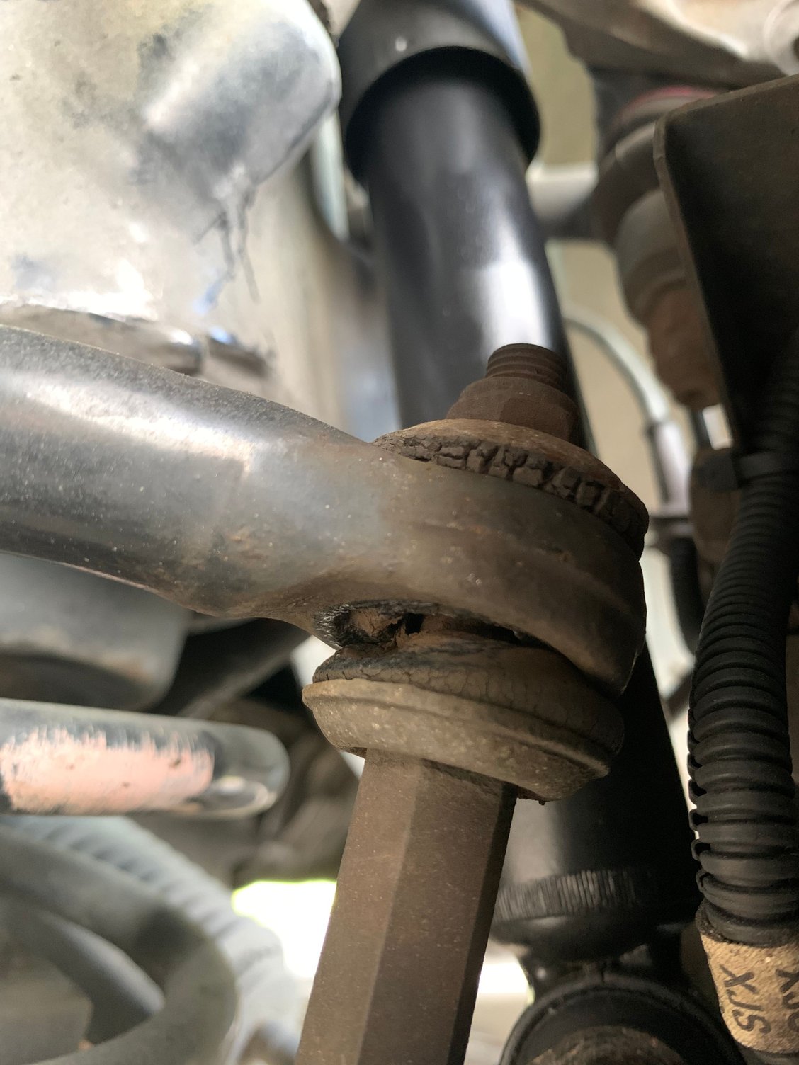

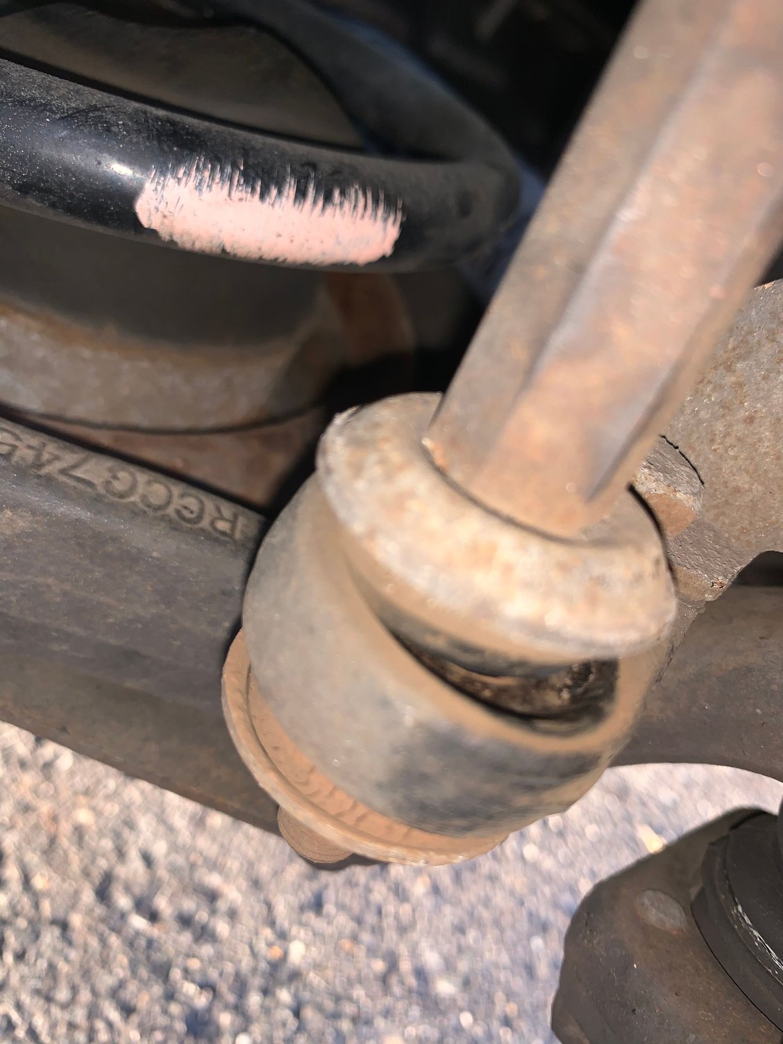

how hard can this be to replace? My service manual makes it sound like a very straightforward job…or is it? Basically unbolt the top, then the bottom, then replace the rubber, then bolt it back together, keeping the special washers in place. Could it really be that easy?
This top one is bad.
This one is probably shot too.

That is the drop link Vee. It is straightforward to change. Remove the wheel, big wooden block under the disc or very outside of the suspension under the bottom ball joint, so the car is level as if still on its wheels. That way the ARB is not under any twist load. Undo top and bottom and replace all four rubbers. If the drop link is worn, change that too.
This is a classic example of the truth of the Grant Francis motto "do it once, do it right, do it ALL". Well found, Vee, let's hope you get some decent driving with the car after all your troubles.

Yup! it's really that easy but do get some WD on those threads before the New Rubber Bushes arrive, as going by those Photo's those bushes you have on your Car look a little bit Shot away and New Bushes will also help to improve the Handling (It should take you half a day at most) if this is the first time you have done this job
See Thread Below: Step by Step Guide to Fitting New Drop Link Bushes on an XJS including Photo's these are on a Pre-facelift V12 but the principle is the same
Fitting New Drop Link Rubber Bushes on an XJS including Photos

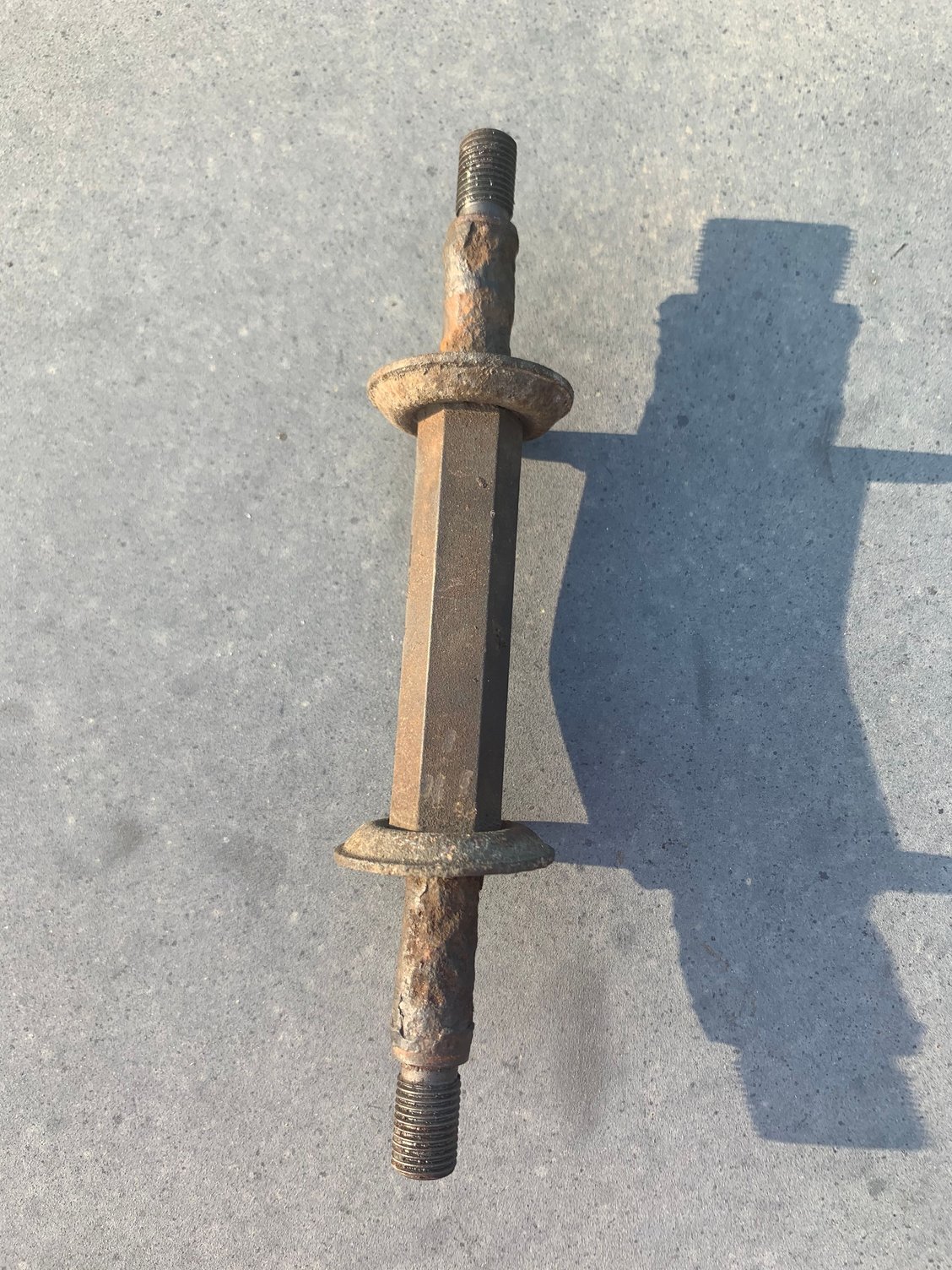

Probably tome to replace?
this was the drivers side...
Drivers side

Yes indeed, buy a kit with everything in it, link, rubbers, nuts washers, is the best idea. They are not expensive either, eg:

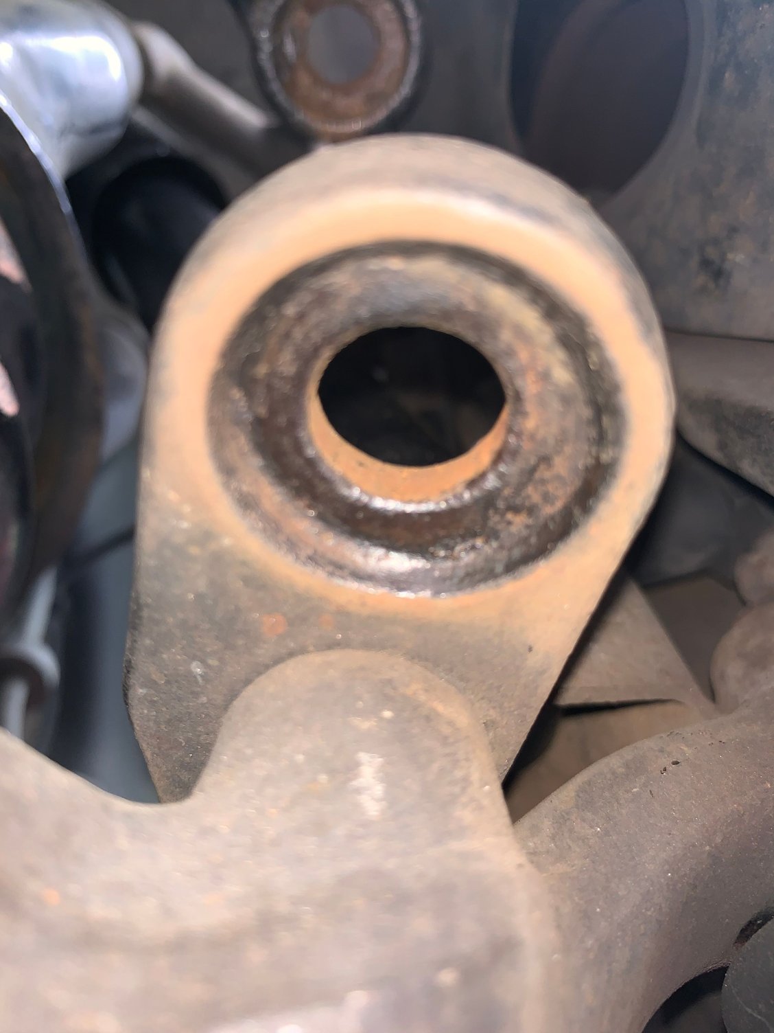

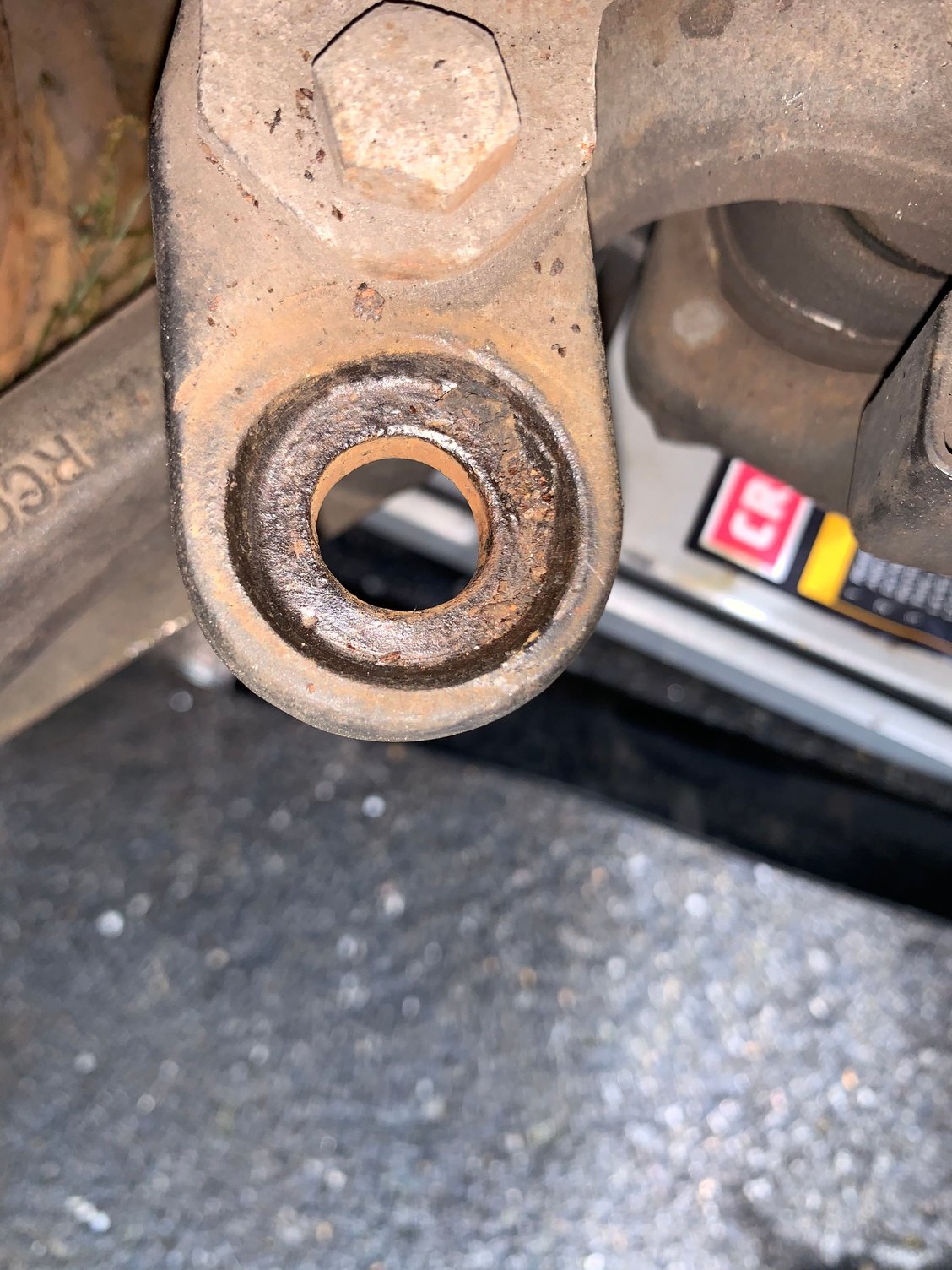

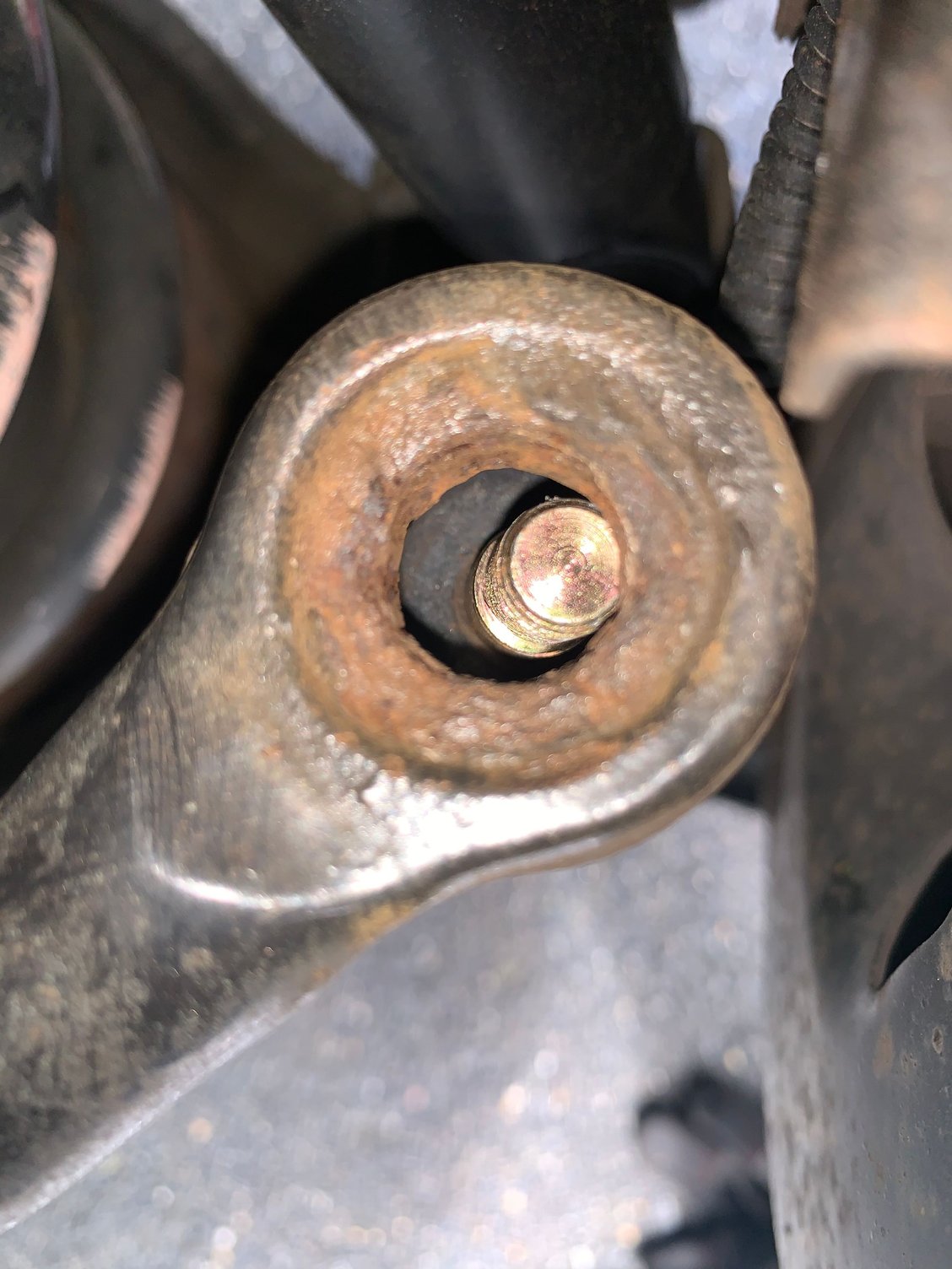

The hole on the anti-roll bar at the link doesn’t look too good. Is there a concern, or a fix?
The hole on the bottom looks clean
Old Apr 13, 2020 | 02:17 AM
Greg in France's Avatar
Posts: 14,600
Likes: 10,795
From: France
I would not worry about it. The wear is caused by the rubber bushes not being changed and metal to metal contact eroding the hole. New rubbers and all will be fine. The metal is only there to hold the rubber in place, after all.
