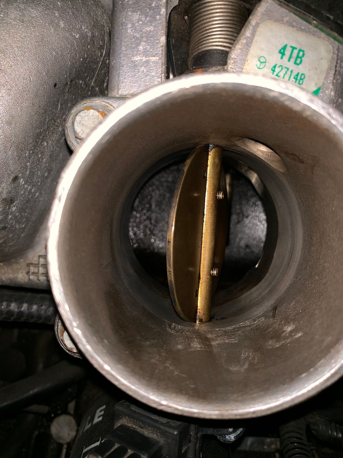

A quick spray down down of some carb cleaner and a rag took out what was a barely perceptible buildup of oil blow by residue that was a direct result of having the car sit for a few months as it was stolen, and slowly repaired. I’ve attached pics of the before, and if you zoom in to the open butterfly pic, a ridge that starts about halfway up the TB intake. I suspect that was the cause. After cleaning it, I experienced a very high idle which was solved with a TPS reset.
I previously installed an oil catch can that, as you can see, has done a marvelous job at keeping the throttle body clean…to the naked eye. This issue that arose, I fear defeats the purpose of the oil catch can. I thought I may have found a way to keep the throttle body maintenance free…alas, there is no way around a good old fashioned throttle body cleaning.
Luckily it’s easy to get to, remove and replace. No gaskets, not much of anything. Once the throttle body is off, the costly TPS can be easily removed so that there is no fear of damaging it with carb cleaner. At that point, you can go to town with a bottle of cleaner and a rag or two.
