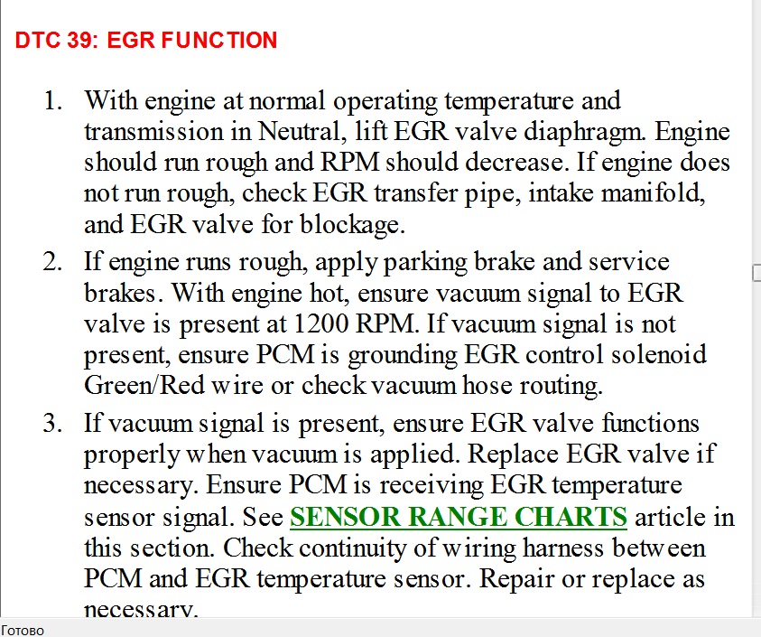

My Engine check light is on I have a 4.0 1994 XJS US model
How do I read the codes on my Trip computer?
Found the code FF39 EGR valve is leaking used a vacuum pump and its leaking
ordered a New valve and gasket set.

FF39
