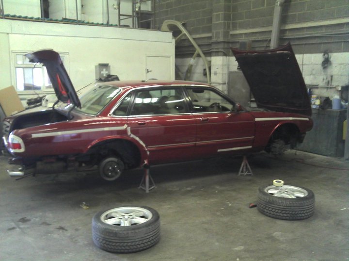

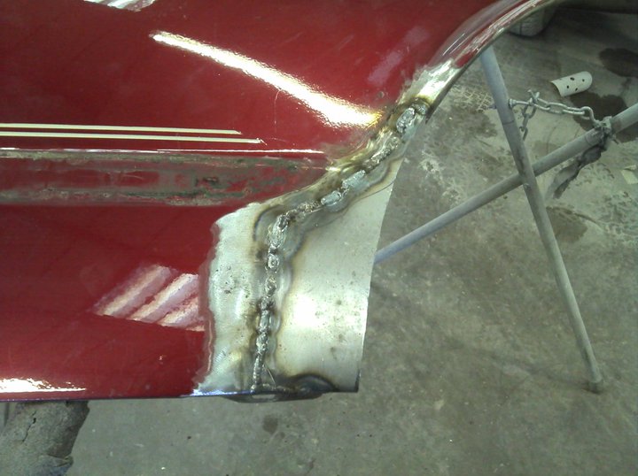

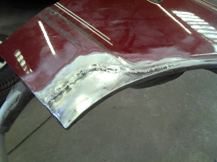

I have had a lot of body work done in the past on Jags and I'll just mention I think you need to do more with the arches than just having it rubbed down sealed and painted. It will come back on a 6-12 month basis if you do.
I found myself a good body shop and they cut the corroded parts out for me and replaced with new metal, this is guaranteed and hasn’t come back yet. Previous attempts to rub down and paint always did. Welding in new metal does cost more but is worth it in the long run. Ill attach a few pictures of mine in the process, all looks scary stuff!
