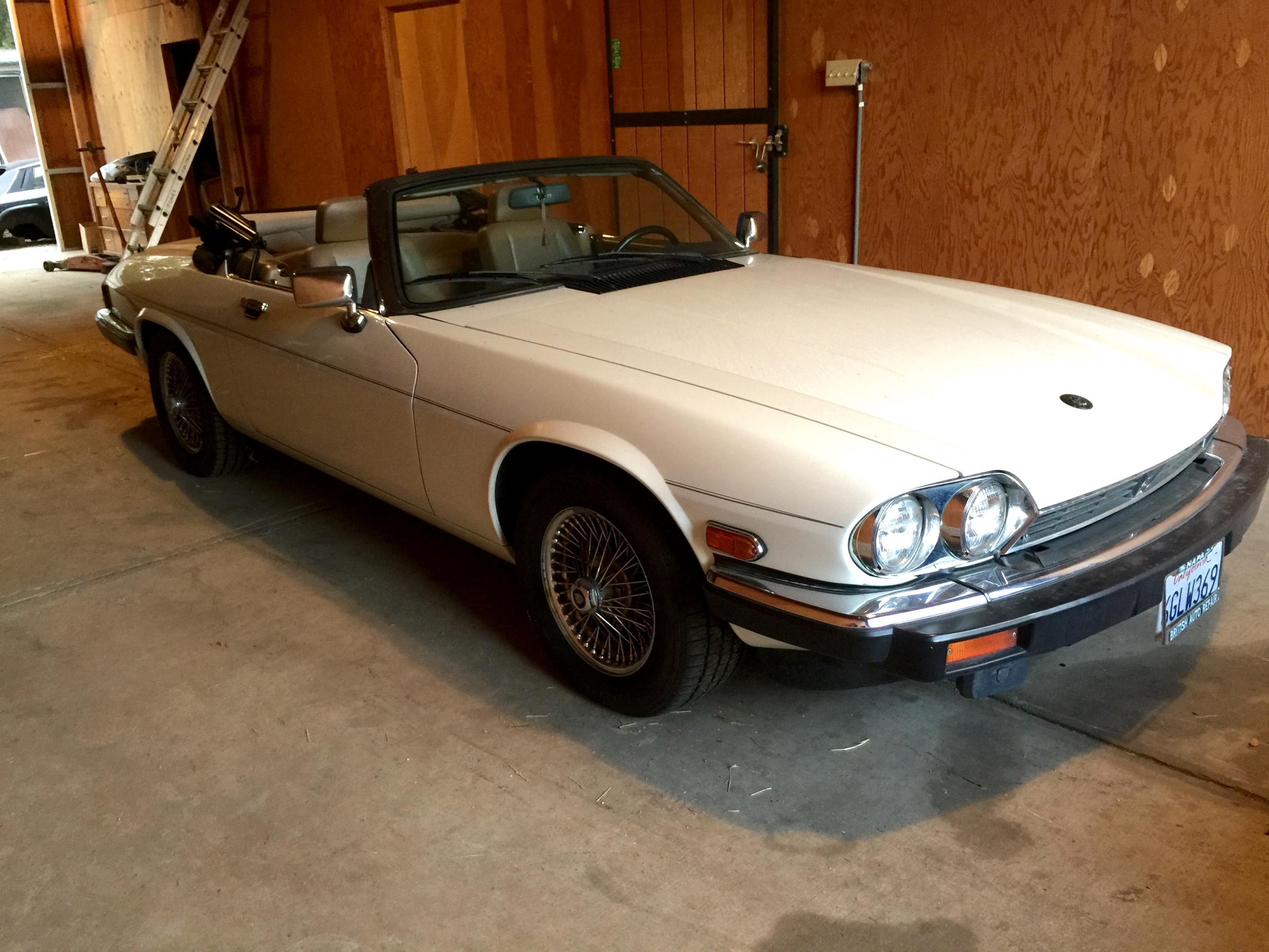

So here I am with this pristine xjs that I picked up for the whopping sum of $0.. I have started her up and true to my suspicions, I don't buy the guys story about it "jumping time". There's no clattering of valves colliding with pistons and the only symptom is that is runs very rough, like to the point where it barely runs; around 200-500 rpm.
So best case scenario I fix it, worst is I use all the beautiful interior pieces for my '88.
Does anyone have any suggestions for where to look first? I want to fix it and it feels like something simple. Tomorrow I'm making sure all the HT leads are hooked up to the right cylinder (gee what if it was THAT easy)
Meanwhile, check out these pics! Merry Christmas to me!

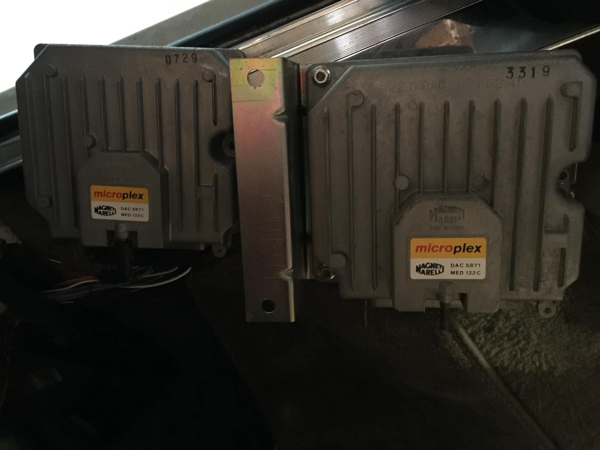

CLUE: I found two ignition control modules in the passenger footwell. One's hooked up and one is just sitting there. It looks like the mechanic was doing something with it or maybe replaced it since there's two. What does it do? (Pic attached)

Dude, that's what I've been needing all along! Thanks for that. Any idea what kind of voltage I should be getting out of the power modules?
