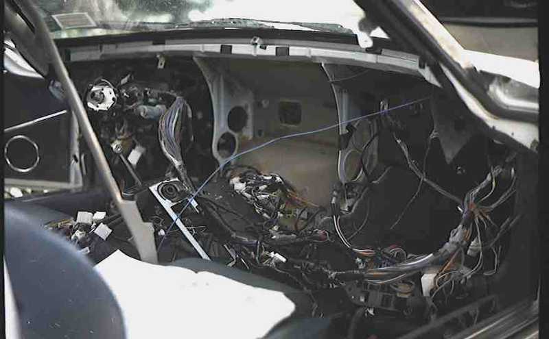

not for the faint hearted you will have to achieve this state of undress to
get the unit out as well as the front seats and fiddly under bonnet work

Not that I'm planning on doing this anytime soon, but am I the only one thinking, what else should be done when the car has been dismantled to this degree?
In the interior, I think at least the following:
  1. clean up all the earth points and protect with grease
  2. clean up the firewall positive posts on their inside poles
  3. renew the grommets where things go into the tunnel
  4. remove the seats, all the carpets and sound dedening etc and protect/repair the floorpan
  5. renew the heater matrix in the aircon unit as a precaution
  6. renew the expansion valve on the aircon unit. Once in place it pokes into the engine bay through the firewall and is hard to get at
  7. carefully clean up all the instrument pack contacts and earths, run an extra earth
  8. separate all the loom plugs and clean them with a toothbrush and contact cleaner and put back together
  9. change windscreen glass if it is needed, maybe.
Greg
