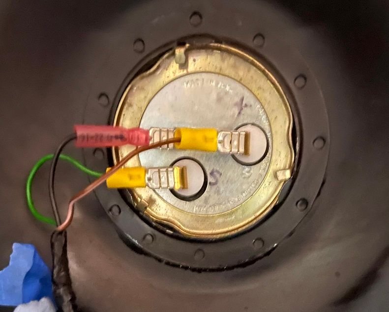

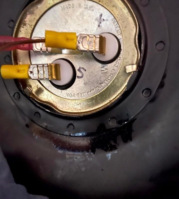

Ran into a new problem, a fuel leak by the fuel gauge sending unit that was not there last week. It's a very very slow 'weeping' leak that looks like its coming from the riveted housing that secures the sending unit. I replaced the sending unit a couple of months ago. Questions I have are:
1. Can this be due to heat? It has been exceptionally hot here lately.
2. Is there a way to tell if the leak is at the riveted housing or due to the sending unit gasket?
3. I've turned the ignition (not engine) on many, many times lately as I troubleshoot a brake issue that is driving me to insanity. As the fuel pump kicks on every time, can this cause pressure to buildup in any part of the system?
4. The strange tone is potentially unrelated but I hear a very high frequency/pitch noise coming from the trunk area even with the battery disconnect switch off. I left the disconnect switch in the on position and after two days my battery was at 4.5V. I've been unable to locate the noise as it is very faint. I promise this is not brake issue induced insanity and its real!
Here are pics of the leak taken ~40seconds apart:
Thanks!

My first thoughts with only 1 C Club down.
That fuel weep is more than likely the actual sender gasket/seal.
OR
The face of the sender, and tank that the seal sits against has a score/scratch/whatever, thus giving a path for fuel to escape.
The riveted item, NAH, never had one of them go AWOL
The white plastic insulators that the terminals are part of, MAYBE, bit of a stretch.
The only thing pressurized with the key movement os the fuel hose FROM the pump outlet TO the outside world, AKA, the engine bay.
The supply side of that pump is purely good old gravity.
That humiing is possibly the electric antenna having a Blonde moment. GREEN relay near the tail light, inside the boot is most likely culprit.

Thanks! I will remove the sender unit and check/renew the seal, I'm glad to hear that is the most likely culprit. Though, I'm not sure why it would start after a couple months, stranger things have happened. It's definitely gas as well sadly.
The noise is more of a tone rather than a hum. The aerial is currently sitting in the trunk awaiting some lube on the motor. Is the green relay for the aerial? Because it happens with the battery off it might be the disconnect switch?
I think I will need to stick my head in there when the car is off ramps and see if I can pick it up. Could also be nothing, and the battery drain is caused by something else.

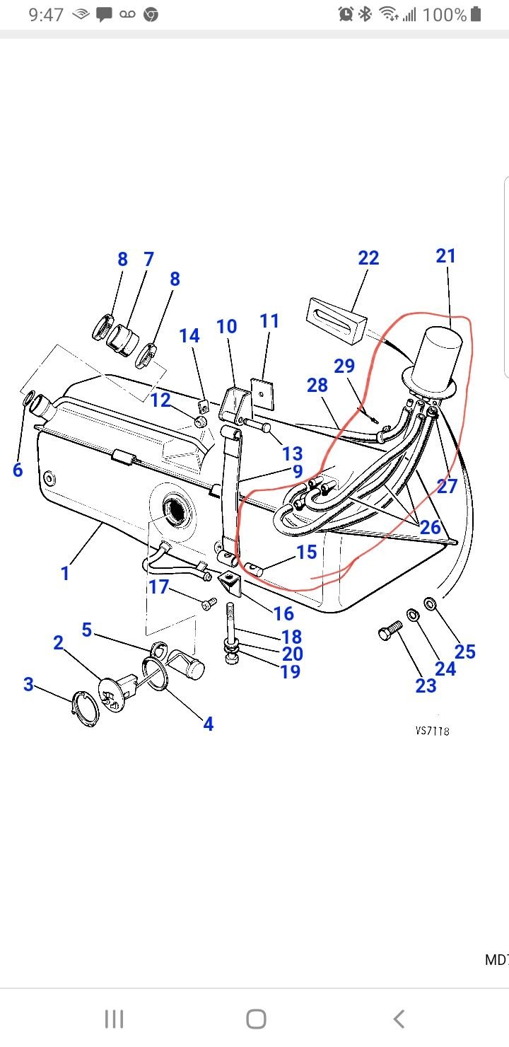

Greg, you are as smart as you are handsome. I opened the fuel filler cap and a 3 second woosh of air came out. I closed it and came back an hour or so later (having never ran the car in between) and got a 2second woosh.
How does this even happen? Rust blocks these fuel breathers? I thought this car had 3 or 4 of them for the fuel tank. I've also had the rear wheels on ramps for the past couple of weeks. Would this have any effect or its just that time for something else to require maintenance?

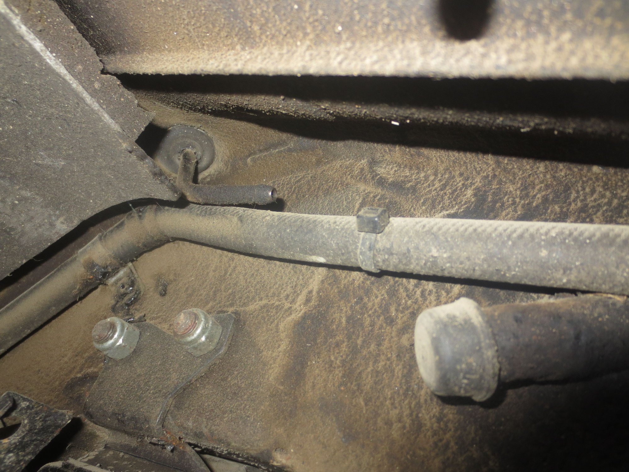

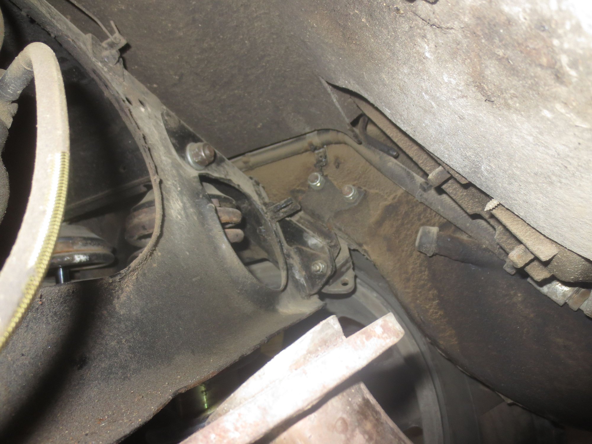

Your car has a ludicrously complex tank breather system. If you look under the car, just in front of the LHS rear wheel, up on the inside of the chassis rail you will see a thin pipe emerging from the chassis. This will be connected to a rubber pipe that goes to the carbon canister at the front of the car that is eventually connected to the inlet manifold via all sorts of valves and bit.
If your laws allow, rip the entire lost out from the rubber pipe forward. This may let the tank breath. If not then up inside the RHS buttress there is an evap canister with three pipes going to it from the tank, and hidden behind it is a Rochester valve that may well be blocked. One or all of these items will account for your lack of tank venting.
Once you have identified all this, there are various solutions to simplify.

Can the rubber pipe forward to the engine be removed and left that way? Or is the connection to the inlet manifold required and would need to be reworked to simplify this system?
If you mean related to the tank breather (sorry i misundertood your post in my last reply which was about the PCV system, my mistake) then everything can be removed from under the car forward, including the canister and all its pipes and rubbish, and just block off the place it goes into the inlet manifold.

By the way, the other day I got round to taking a snap of the tank breather where bit comes out on the LHS by the chassis frame over the rear wheelarch, FYI:
Cheers Greg, I removed all that junk, cut down the vacuum lines, and plugged them with a screw and some RTV. Car works as before. Most importantly, my tank is able to breathe again. No more wooshing from the cap and a fuel vapor is notable when near that spout under the tank. I will eventually fit a small charcoal filter there but for now I'm glad its fixed. Thanks for the guidance!
Should that hard line to the tank get blocked, I'm guessing compressed air is the best/only way to clear it out?
