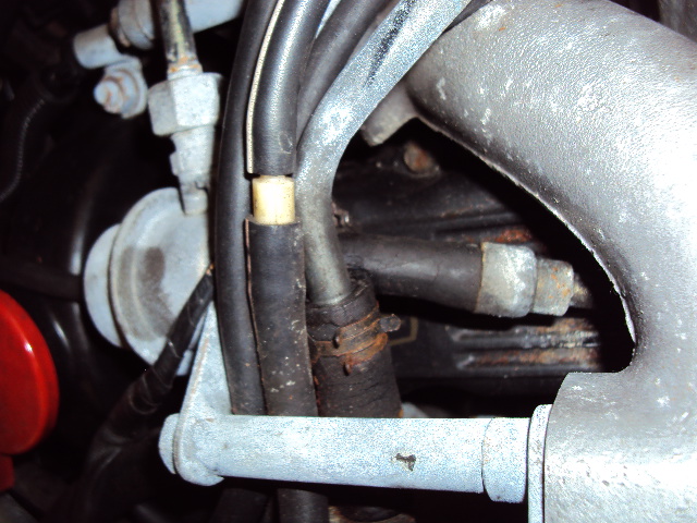

Is there a Thread on how to repair the crimped end type hose that runs from the B bank Pres regulator to the Refrigerant cooler? Is there a nipple that protrudes from the crimp bezel enough to fit a small hose clamp? Or is there a more professional way to do it??? Do you have to cut off the crimp bezel?

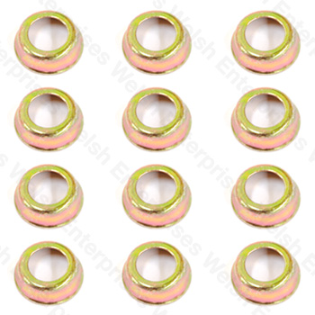

What you're thinking is a crimped fitting, isn't. The hose presses onto barbed nipple. What you're thinking is a crimp fitting is a ferrule...a cap-like widget that Keeps the end of the hoses intact. Lots of shapes and styles out there. I use the same type as seen on the fuel injector hoses, part EAC7876, available from various Jag suppliers, but others have their own preferences
*Carefully* cut the ferrule and hose off the nipple....you don't want to damage the nipple...then slip a new ferrule over the nipple then press on the new hose. Done.
Others melt the hose away so the ferrule can be reused

Apparently you can just cut it apart. I had a local hydraulic shop remake it reusing he hard bit for about $20.
wrestling it out around the inlet manifold is kind of a bear.
