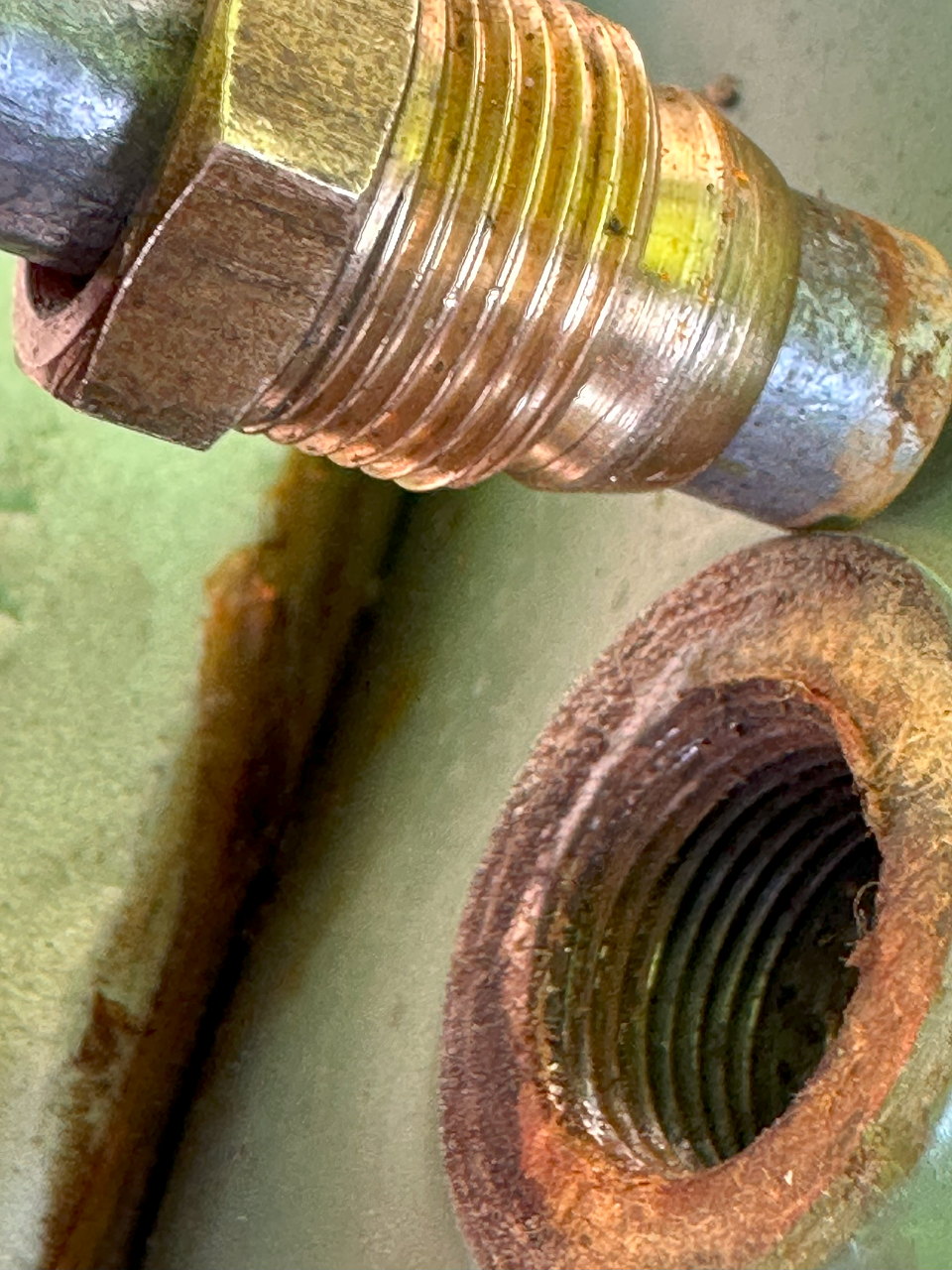

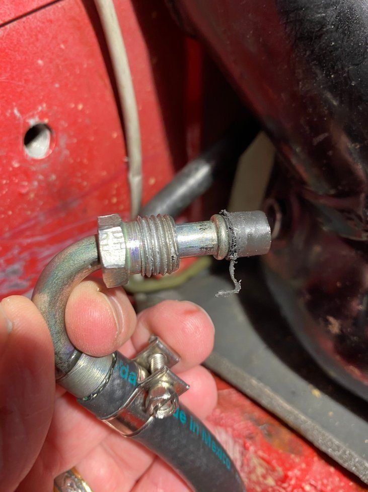

The stupid ones that thread into the tank with some obscure fitting and boss type, there is one for the bleed from the swirl tank on the right and one for the return on the left - these came in two forms, one that uses a Viton 'olive' and one that uses a brass olive, the old tank that was scrap had the brass olive, the replacement I have has the horrid viton seals.
The brass olive type
and the one I'm stuck with - horrid thing

Why not just buy olives and use in place of the viton? The fittings look the same, standard Imperial sizes.
I had LOADS of trouble with the tank outlet to the sump tank. In the end I araldited the whole thing and screwed it in place. No leaks since. I replaced the fexible part of this hose with 1/2 fuel moulded hose and used double clips on the tank solid pipe to flexible join to the sump tank and all 100% since.

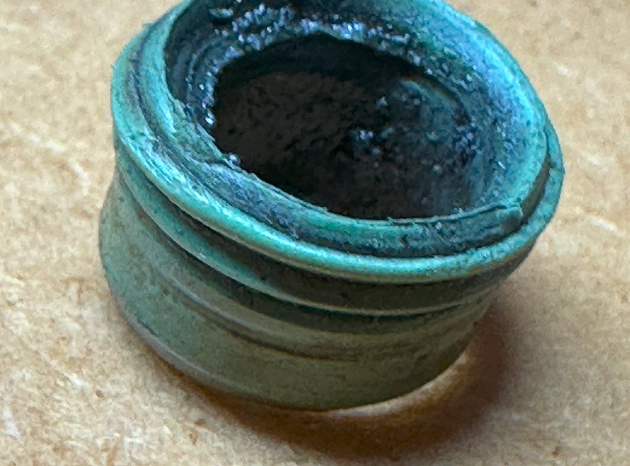

Wish they were the same - they aren't - on the viton types is a shoulder, the seal 'should' stay below this shoulder (I think) - there is nothing in the service docs that offers any clues how Jaguar expected these to be fitted.
If I struggle too much I will be using some Hylomar and a generous helping of Loctite 577 - I have 25ft of Viton tube to play with which should bother me given the price of the stuff - these are what came out of the tank when I refurbed it - they were stuck inside the boss's. And yes that is the same horrid black crud so the system this tank came from had issues.
