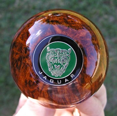

The one that I see in your link is a "T" type from older, pre-facelift XJS or older XJ's. If it is for your '94, then you want the "ball" type, which is the one that Calvin was refering to and that just screws to the top of the shifter shaft.
I recently updated the one on my '94 from the plain wood that I had, to the one that adds that awesome growler at the top. The quality finish and rich wood pattern really give a shot in the arm to the overall looks of the interior. Tip: NOT from Myrtle.
