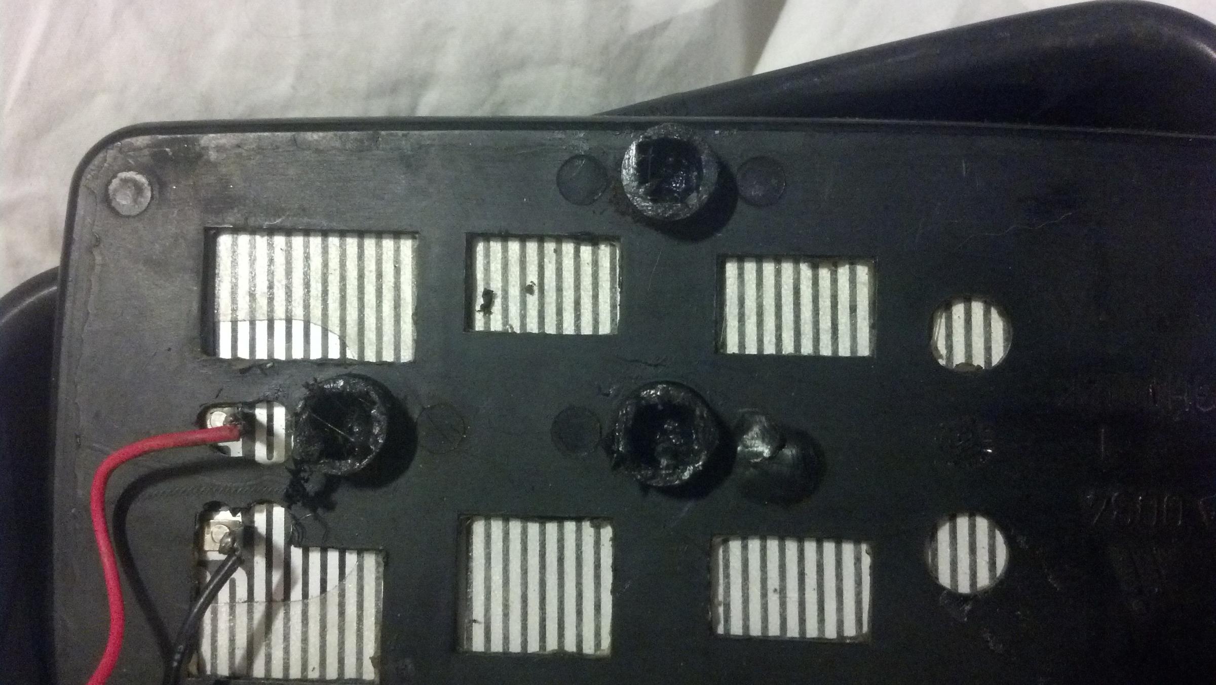

Dear Spikpaga, I'm going to upload some pictures to help you understand what I describe as how to dismantle the side view mirrors on the xjs. With power applied, you need to angle the mirror down to access the top screw (philips) using a THIN screwdriver, take it out. You'll then be able to acces the back of the mirror better. You can see by the pics, you can carefully pry the ***** from the motor out of their sockets. DON'T bend the mirror at all or CRACK! It's not so easy to snap those ***** back in but with perseverance it's possible .then put te screw back in and done. Bud

Here's some pics to help. Bud
