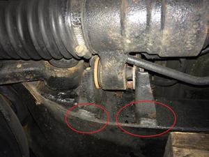

Also you'll want to check the housing where the bushing sits in. I've seen many in the past there they crack at the bottom. Make sure these aren't cracked. Used to work at an independent for a few years, ended up making braces to weld in for added strength.
